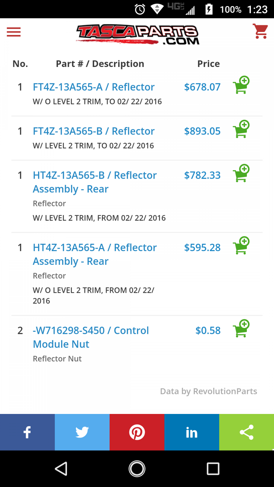

omar302 Posted October 6, 2017 Report Share Posted October 6, 2017 (edited) Looking at the price difference, w/level 2 trim part ending with "B" is the lighted one. https://www.tascaparts.com/auto-parts/2016/ford/edge/titanium-trim/3-5l-v6-gas-engine/electrical-cat/reflector-scat Edited October 7, 2017 by omar302 Quote Link to comment Share on other sites More sharing options...
lildisco Posted October 6, 2017 Report Share Posted October 6, 2017 Looking at the price difference, w/level 2 trim part ending with "A" is the lighted one. https://www.tascaparts.com/auto-parts/2016/ford/edge/titanium-trim/3-5l-v6-gas-engine/electrical-cat/reflector-scat I think that you mean B instead of the A version. A version is cheaper than B. I doubt LED's are cheaper than non LED version. 2 Quote Link to comment Share on other sites More sharing options...
omar302 Posted October 7, 2017 Report Share Posted October 7, 2017 Yes lildisco, your right. B not A. I edited my post accordingly. 1 Quote Link to comment Share on other sites More sharing options...
