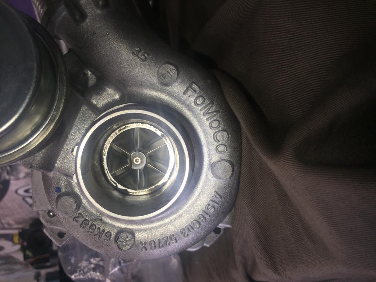

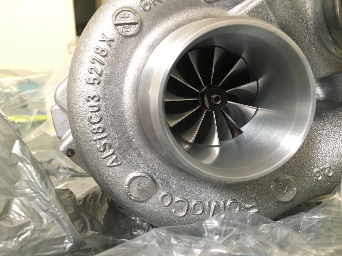

Xtra Posted May 16, 2018 Report Share Posted May 16, 2018 Here are a couple photos showing the difference between the stock 6 blade cast compressor wheel and the Comp Turbo 11 blade billet compressor wheel . Notice how the stock input has been hogged out for the larger Comp turbo wheel to fit. 1 Quote Link to comment Share on other sites More sharing options...
