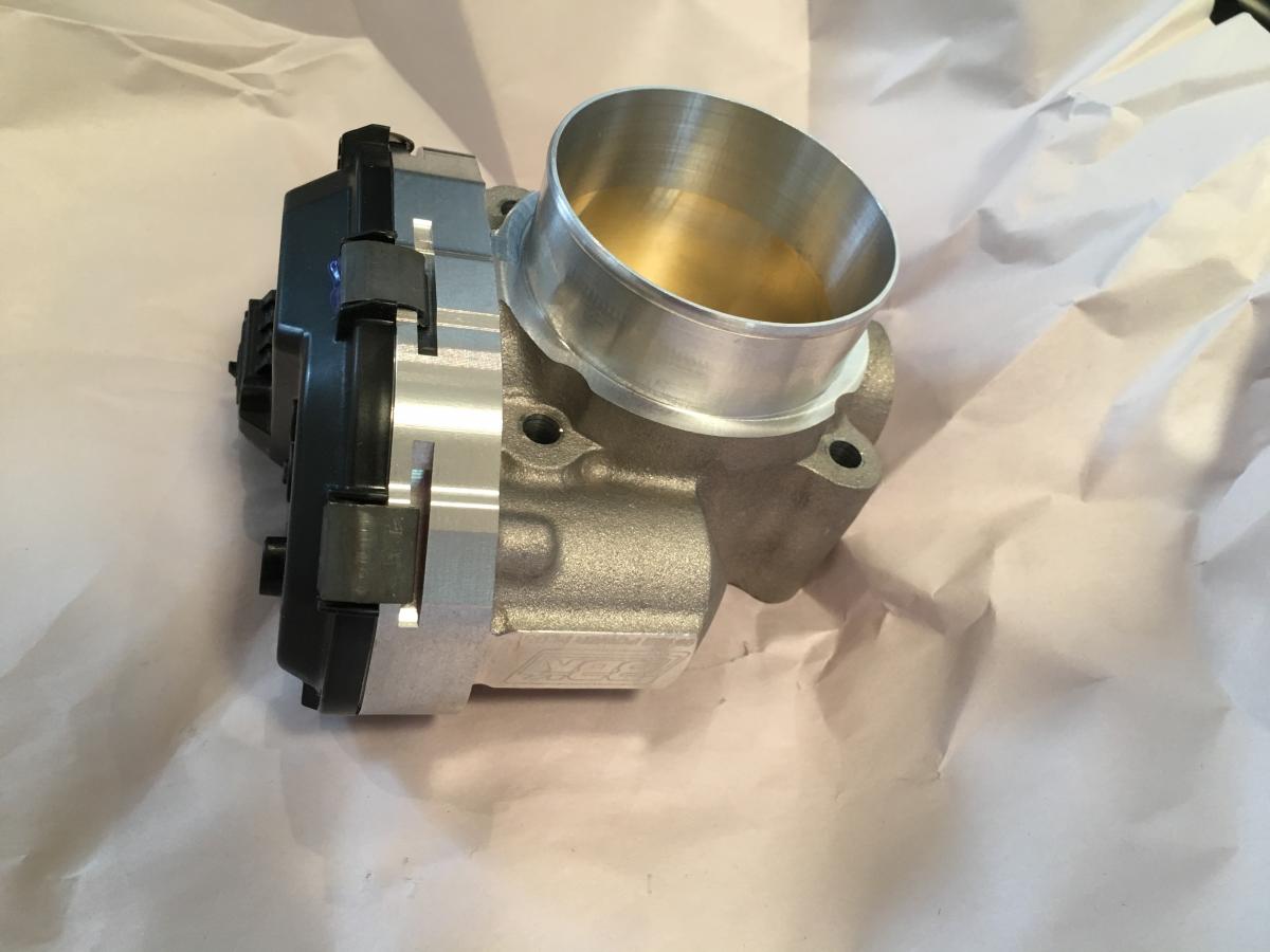

Xtra Posted April 19, 2018 Report Share Posted April 19, 2018 (edited) The 65mm throttle body just arrived and it is beautiful. Almost all my parts have arrived and all I need is the cold side pipe to start the transformation . Edited April 19, 2018 by Xtra 1 Quote Link to comment Share on other sites More sharing options...

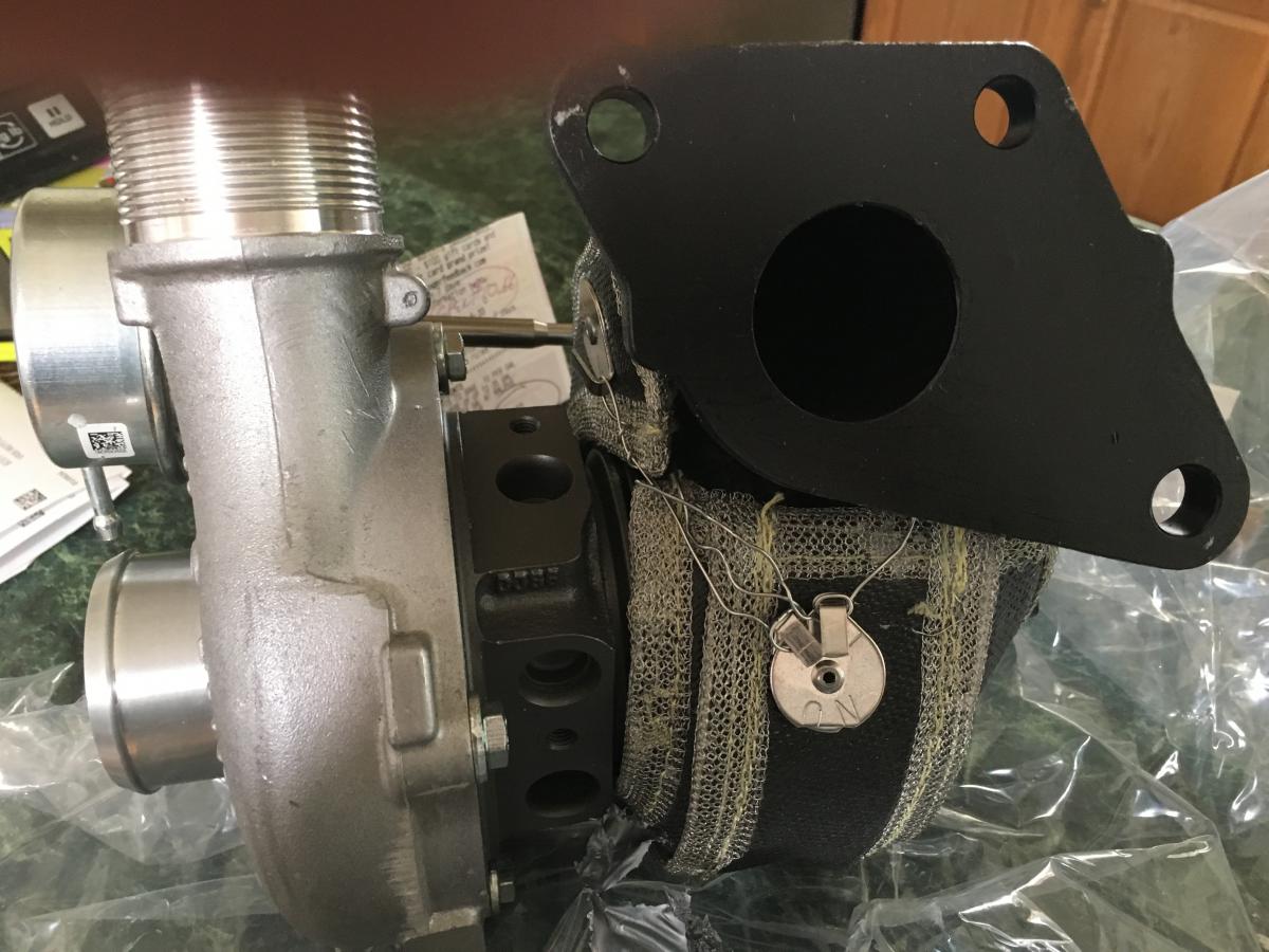

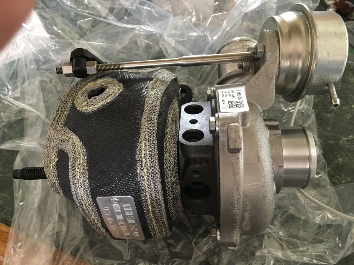

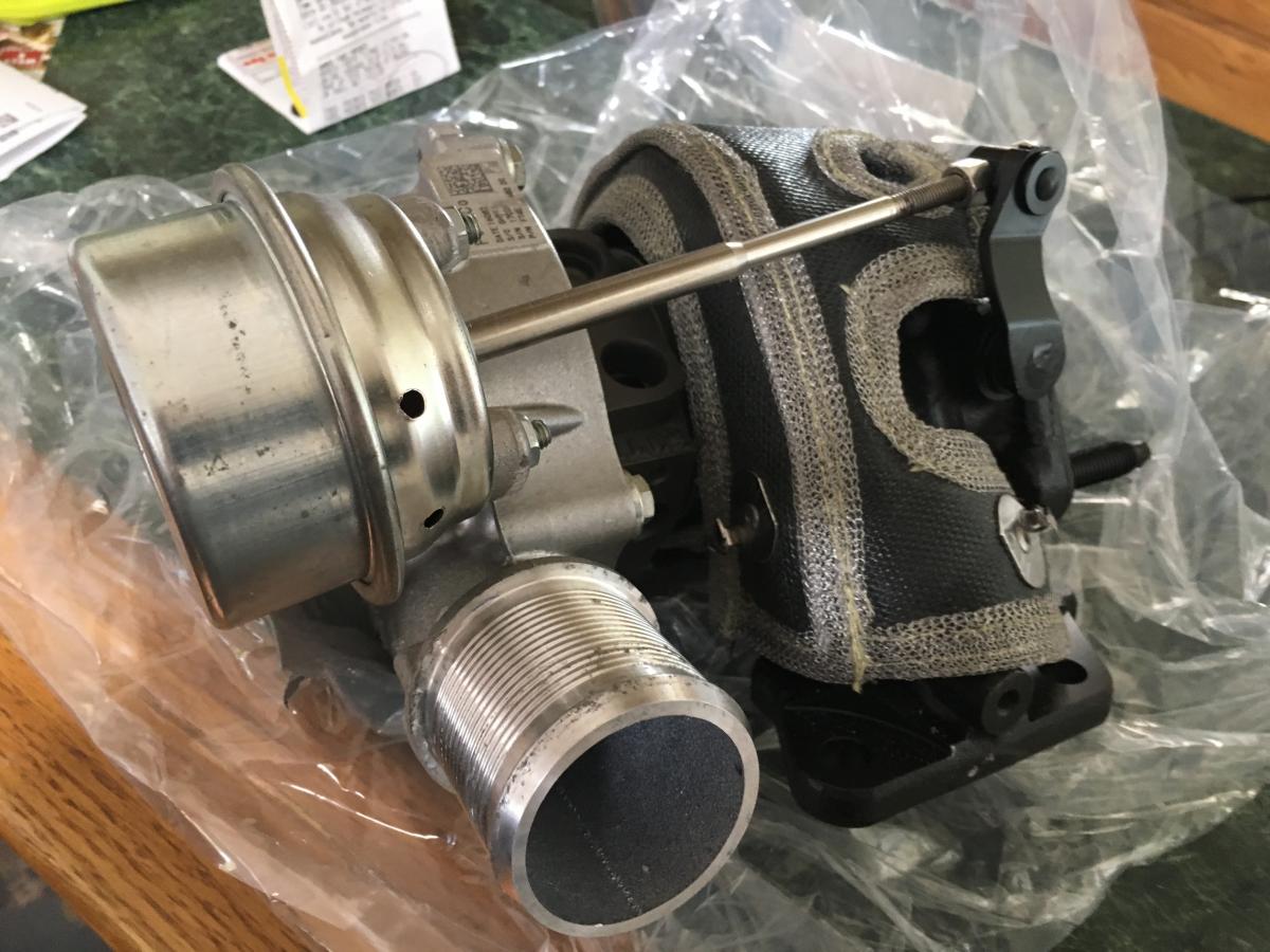

Xtra Posted April 27, 2018 Report Share Posted April 27, 2018 My" blueprinted" turbos arrived with the blankets installed and they are eye candy. Comp Turbos did a great job. 4 Quote Link to comment Share on other sites More sharing options...

Mikula Posted April 27, 2018 Report Share Posted April 27, 2018 Damn those look good. You'll have the best looking setup on the road! 1 Quote Link to comment Share on other sites More sharing options...
One Slow 5.0 Posted April 28, 2018 Report Share Posted April 28, 2018 Did they ceramic coat the exhaust housings? Quote Link to comment Share on other sites More sharing options...
Xtra Posted April 28, 2018 Report Share Posted April 28, 2018 (edited) On 4/28/2018 at 1:49 AM, One Slow 5.0 said: Did they ceramic coat the exhaust housings? No the blanket has thermal control " covered". LOL get it ... Blanket ..Covered... Ceramic coating is a viable option but I did not go for that. Edited April 28, 2018 by Xtra 1 Quote Link to comment Share on other sites More sharing options...
Mikula Posted April 28, 2018 Report Share Posted April 28, 2018 On 4/28/2018 at 1:59 AM, Xtra said: No the blanket has thermal control " covered". LOL get it ... Blanket ..Covered... Ceramic coating is a viable option but I did not go for that. You, instead, went for... Tucking the turbos in for a nice bed time story. Please give them a kiss goodnight for me! 1 Quote Link to comment Share on other sites More sharing options...
One Slow 5.0 Posted April 28, 2018 Report Share Posted April 28, 2018 So the black coating is just paint? I ordered the blankets they will be delivered tomorrow. 1 Quote Link to comment Share on other sites More sharing options...
Mikula Posted April 28, 2018 Report Share Posted April 28, 2018 On 4/28/2018 at 2:14 AM, One Slow 5.0 said: So the black coating is just paint? I ordered the blankets they will be delivered tomorrow. Just remember (and anyone else running a turbo blanket) to check them every so often. If they absorb any kind of oil, from turbos or otherwise, they can turn into kindling and burn it down. They are not flammable by themselves, but oil can certainly change that. I was told something years ago about blankets, so i'll pass the info along and let you guys be the judge. Because the turbos keep heat in, that also means that they are retaining heat after shutdown. With oil cooled turbos this can be a bad thing. it could produce some coking and cause premature wear. running synthetic is recommended to help with that. On the good side, turbos should spool faster, and obviously under hood temps should be better. I would recommend wrapping the exhaust down to the flex pipes while you're at it. or use some kind of additional heat shielding to dissipate some of the heat from exhaust as well. BUT... for me, on any kind of aftermarket application, such as xtra, I would absolutely use a blanket. Right now with my stock turbos, I don't think I'll see any measurable gain to justify it. But they sure look awesome! 2 Quote Link to comment Share on other sites More sharing options...
Xtra Posted April 28, 2018 Report Share Posted April 28, 2018 The stock compressor wheel is a 40/51mm six blade cast aluminum. The new compressor wheel is 44/57mm eleven blade aluminum billet CNC. There was some machining of the compressor housing to make room for the bigger wheel. The new compressor wheel is bigger, lighter, stronger has more blades and will move more air. While on exhaust side the wheel remains stock. The entire moving assembly was trued and balanced, and the rest was completely remanufactured. I can recommend Comp Turbos in Pomona, CA at this point for doing a great job. By the way Pomona Drag Strip is the home of the NHRA Winter Nationals. Now all I have to is get them installed and see what they can do. 2 Quote Link to comment Share on other sites More sharing options...
