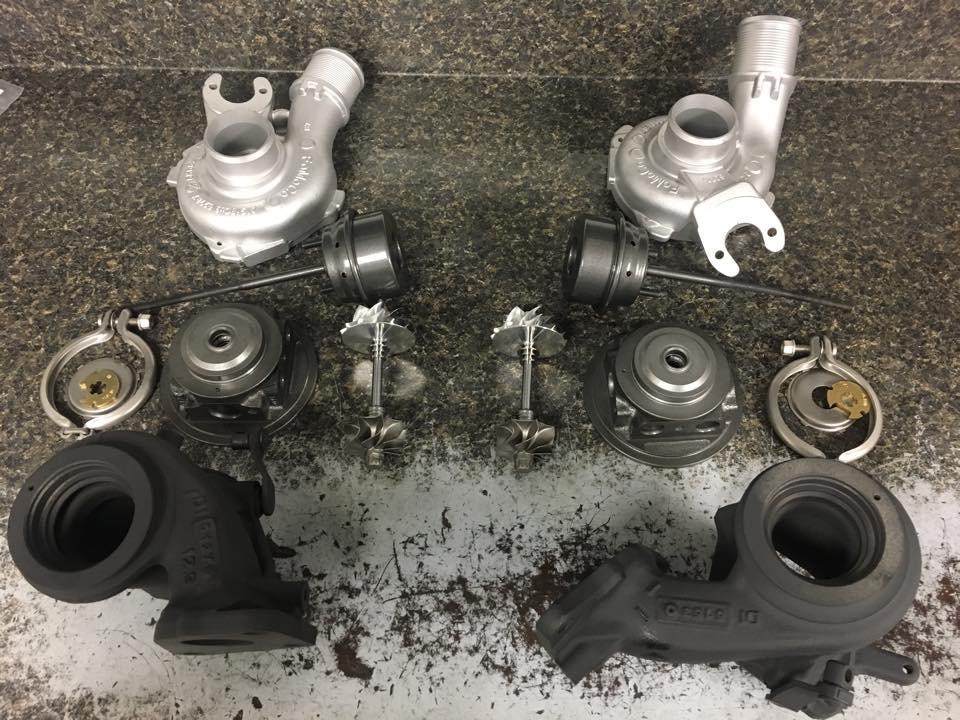

Special_K Posted March 22, 2018 Report Share Posted March 22, 2018 Just got an update from BNR! these are looking good! 4 Quote Link to comment Share on other sites More sharing options...

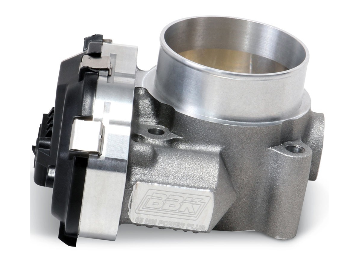

Xtra Posted March 25, 2018 Report Share Posted March 25, 2018 snmjim, Here is a 65mm Throttle Body you might be interested in to help move more air. And good for a few more ponies. https://www.stage3motorsports.com/1894-2015-2017-F150-2-7L-EcoBoost-BBK-65mm-Power-Plus-Throttle-Body.html 1 Quote Link to comment Share on other sites More sharing options...
Special_K Posted March 26, 2018 Report Share Posted March 26, 2018 snmjim, Here is a 65mm Throttle Body you might be interested in to help move more air. And good for a few more ponies. https://www.stage3motorsports.com/1894-2015-2017-F150-2-7L-EcoBoost-BBK-65mm-Power-Plus-Throttle-Body.html ecoboostbbk65mmpower-plusthrottlebody03-1.jpg it has been added to the list :-) thanks Xtra! 1 Quote Link to comment Share on other sites More sharing options...
