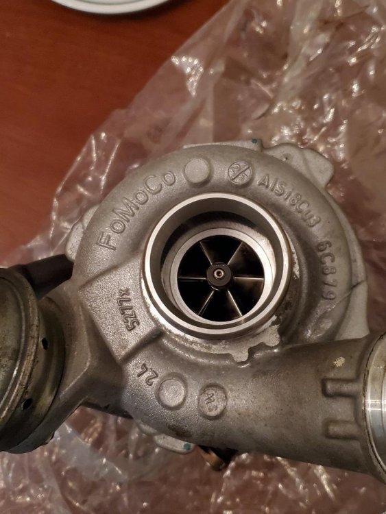

Xtra Posted September 3, 2020 Report Share Posted September 3, 2020 (edited) Here you can see the stock turbo. Notice the lip around the cast 6 blade inducer. CPR Stage 3 turbos remove this lip to fit a larger 40.6/50.8mm, 6 blade billet inducer. Comp turbos also removes this lip and hogs out the shell to the max, installing an 11 blade 44mm/57mm billet inducer. Comp turbos also works on the inside of the shell to smooth it out. CPR states that their stage 3 "CAN" make up to 425WHP. That 425WHP would be available only under ideal conditions. You could not bolt them on and magically get 425WHP. That is advertising. Every part of the system from CAI to exhaust tips, to using a top-grade fuel would all have to be in-sink to get that advertised "up to 425WHP." I have 20,000 miles and a couple of years on my Comp Turbos with no driveline or engine problems at all, just normal maintenance. Though I do change the oil every 2,500 miles and I tend to use the severe-duty guide for maintenance recommendations. It has been a super reliable combo that I would trust to drive across the USA. My car Dynoed at 348WHP on a 91 tune, that's around 130WHP more than stock. I did baseline dyno runs with a bone stock car so I could log the improvement. I am guessing around 375WHP with 93 tune I have not dynoed on 93 yet. I believe that if you are looking for MAX WHP and MAX Performance then use snmjims recommendation for turbos, I think he has been using BNR Racing Turbos for years on several different projects and highly recommends them. After all, he is the current undisputed World Champion, and soon he will be the first to drop into the 11-second range. I would go with Comp for 130 to 160 extra WHP and good reliability with a stock driveline, or BNR for an extra 260WHP and not mess with the CPR turbos, just because they are untested around here. STOCK FORD EDGE 2.7 TURBO MODIFIED STOCK TURBO, BY COMP TURBO CPR - STAGE 3 Edited September 4, 2020 by Xtra 5 Quote Link to comment Share on other sites More sharing options...
Markham12 Posted December 24, 2020 Report Share Posted December 24, 2020 (edited) This is interesting. I had my turbos upgraded by Comp Turbo Technology also. But mine are 6 blade vs your 11 blade Xtra. I assume there is a difference in how they run or flow. Here is a photo of stock turbo and my modified Comp turbo. Edited December 24, 2020 by Markham12 4 Quote Link to comment Share on other sites More sharing options...
Xtra Posted December 24, 2020 Report Share Posted December 24, 2020 (edited) Markham12, I also find it interesting that Comp Turbos changed from 11 to 6 blades. Six blades must be better because technology always moves forward not backward, and my turbos are a few years old now. Your inducer looks massive compared to stock !! I also like that black finish on the case. Edited December 24, 2020 by Xtra 4 Quote Link to comment Share on other sites More sharing options...
