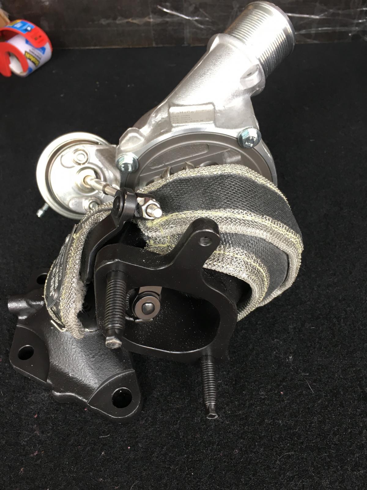

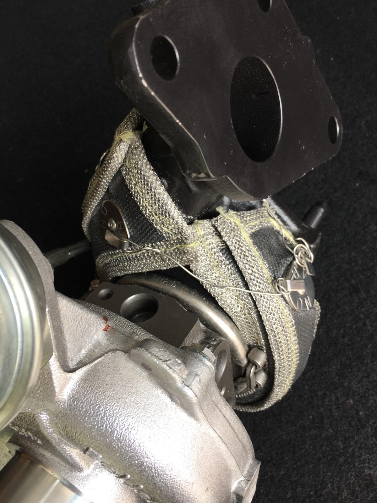

Xtra Posted June 3, 2018 Report Share Posted June 3, 2018 (edited) Turbo Mania :happy feet: Edited June 3, 2018 by Xtra Quote Link to comment Share on other sites More sharing options...

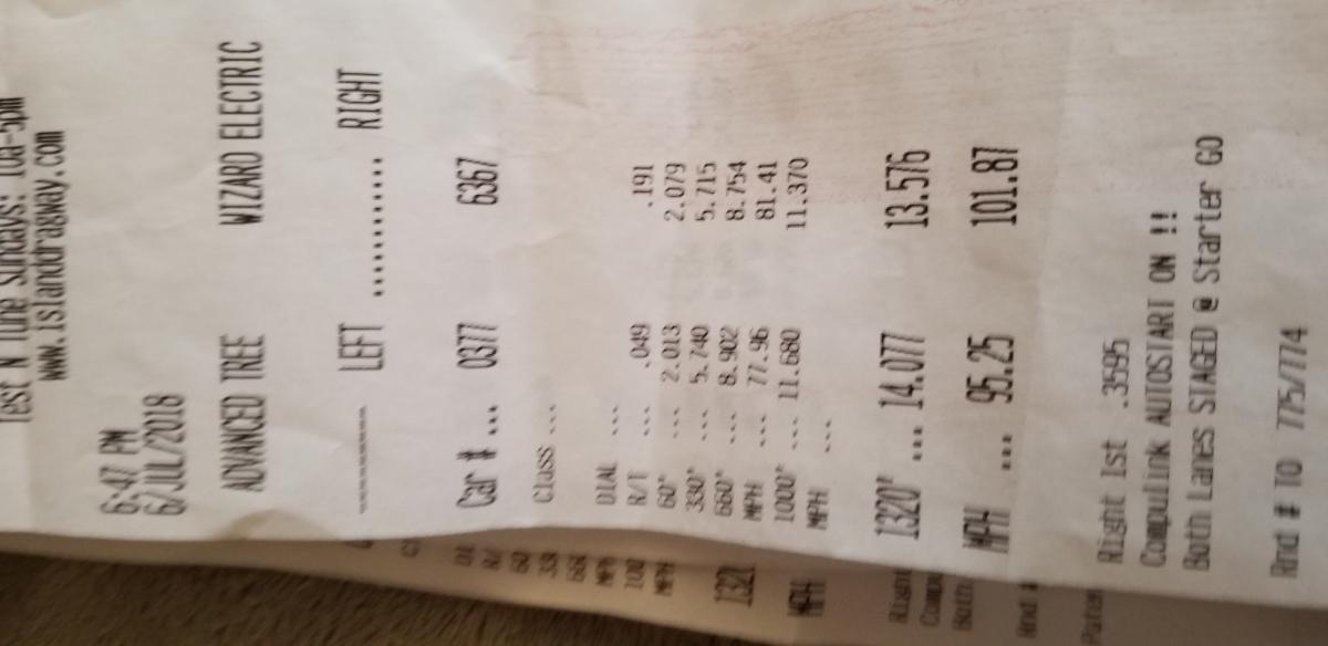

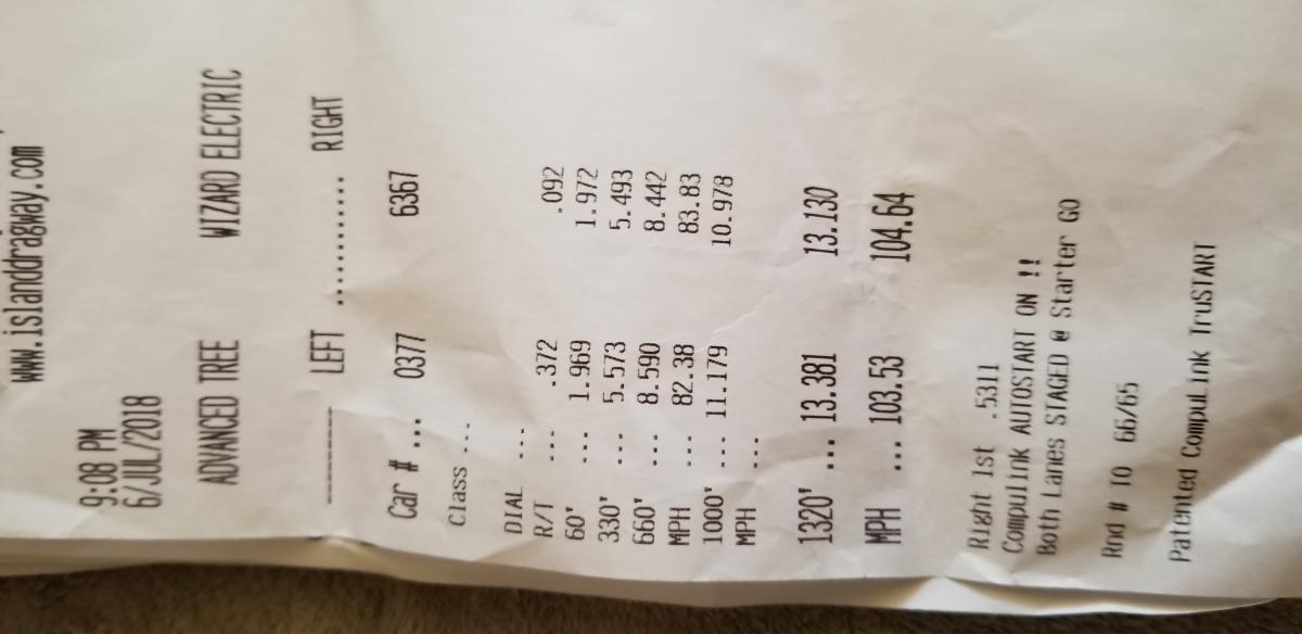

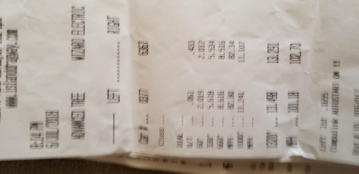

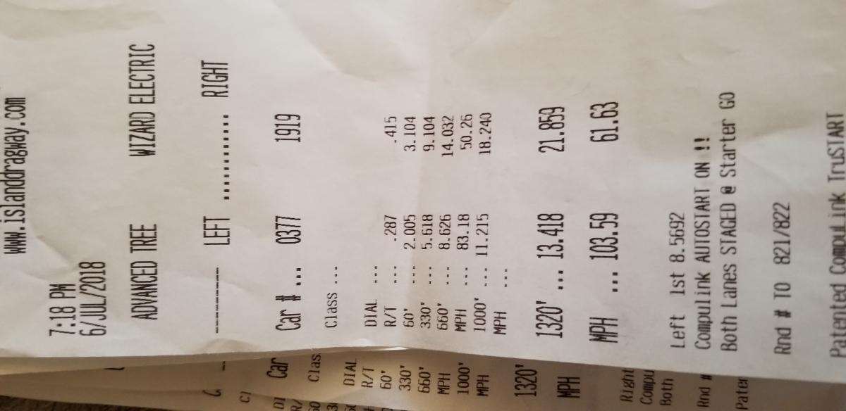

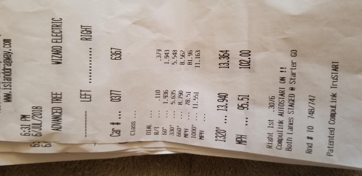

037 Posted July 2, 2018 Report Share Posted July 2, 2018 (edited) On 4/11/2018 at 12:16 AM, Xtra said: Just got back from the Dyno Shop and have the base numbers. I was surprised by the numbers especially the V3 output and how after 5,000rpm power fell off so quick. All numbers are taken at the wheels. Stock HP 224.3 @ 5,000 rpm Stock TQ 280 @ 3,400 rpm LMS 91 V3 HP 231.7 @ 5250rpm LMS 91V3 TQ 305 @ 3,500 rpm DYNO STOCK AND LMS91-V3.JPG Pink is stock. Green is V3 Tune. The upper two lines are TQ. The bottom two lines are HP. https://www.youtube.com/watch?v=-Xcf44viKrA Xtra, took some time for me to find this post but I just wanted to get on the same page. I went racing on Friday in 80 degree heat with 2000DA and the LMS v3 93 tune fell straight on its face. I got 2 runs close to 14 flat at 95mph, car was getting stuck in 4th gear and refused to shift to 5th. I upped the octane to about 97 and went 13.4 @ 103. Upped tune to 100 and smaller issue in 4th gear, trapped only 101 even though 1/8 started out 1mph higher than 93 tune. Went back to 93 tune and back to 103mph trap speed. Point is, I think I see the source of your low power issue on LMS v3 and I think they over cooked the tune. I was racing in the 40s and did not have that issue so our view points were different. Since I'm not on LMS payroll I call them like I see them. I sent them a message to alert them to the issue. Hopefully this helps with your build too. Edited July 2, 2018 by 037 4 Quote Link to comment Share on other sites More sharing options...

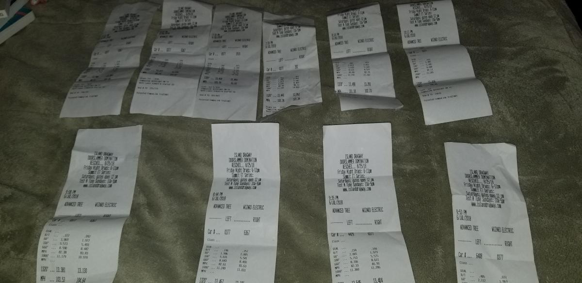

037 Posted July 2, 2018 Report Share Posted July 2, 2018 Slips to back up the above post, ran 10 times on Friday @ Island Dragway with GT500Rs X3 M40i. 3 Quote Link to comment Share on other sites More sharing options...
Xtra Posted July 3, 2018 Report Share Posted July 3, 2018 On 7/2/2018 at 9:20 AM, 037 said: Xtra, took some time for me to find this post but I just wanted to get on the same page. I went racing on Friday in 80 degree heat with 2000DA and the LMS v3 93 tune fell straight on its face. I got 2 runs close to 14 flat at 95mph, car was getting stuck in 4th gear and refused to shift to 5th. I upped the octane to about 97 and went 13.4 @ 103. Upped tune to 100 and smaller issue in 4th gear, trapped only 101 even though 1/8 started out 1mph higher than 93 tune. Went back to 93 tune and back to 103mph trap speed. Point is, I think I see the source of your low power issue on LMS v3 and I think they over cooked the tune. I was racing in the 40s and did not have that issue so our view points were different. Since I'm not on LMS payroll I call them like I see them. I sent them a message to alert them to the issue. Hopefully this helps with your build too. Thanks Quote Link to comment Share on other sites More sharing options...
037 Posted July 3, 2018 Report Share Posted July 3, 2018 Here is their response: We would recommend checking the trans fluid level and overfilling by 1 pint Quote Link to comment Share on other sites More sharing options...
