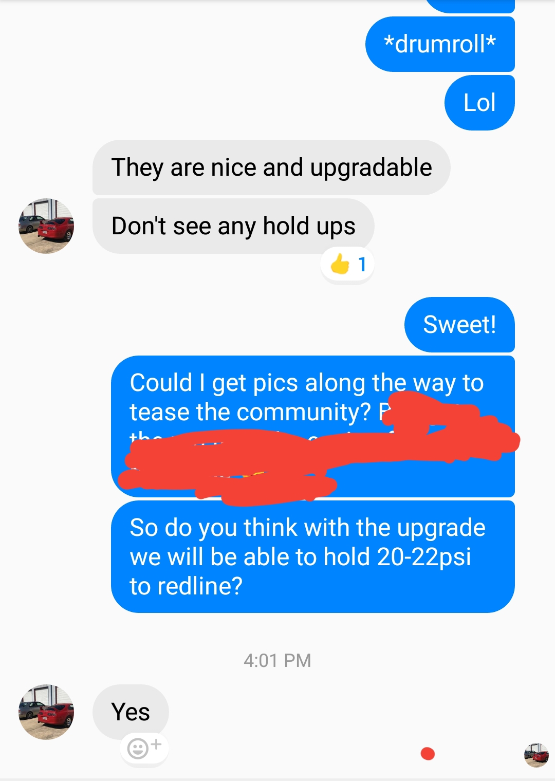

Special_K Posted March 9, 2018 Report Share Posted March 9, 2018 Update on turbos: stock is 33mm cold side and 46mm hot side New turbo will have a billet wheel with 40mm cold side and 53mm hotside and a more aggressive hotside pitch (to be determined). Our goal is 22psi to redline without being a hair dryer! Also, having turbo blankets made to cut down on engine bay temps Till next update! 1 Quote Link to comment Share on other sites More sharing options...

Special_K Posted March 12, 2018 Report Share Posted March 12, 2018 (edited) Any update on the turbos. Do you have them back from the rebuild yet ? A killer kit of turbos I C and cold pipe I cant wait...an awesome power combo . I quoted the most recent update that occurred 3 days ago Xtra. We are hoping to have them back in a month or so! Also, Xtra I hope your looking at braking solutions soon cause a 450awhp 4400lb machine is going to take a lot to stop.... Update on turbos: stock is 33mm cold side and 46mm hot side New turbo will have a billet wheel with 40mm cold side and 53mm hotside and a more aggressive hotside pitch (to be determined). Our goal is 22psi to redline without being a hair dryer! Also, having turbo blankets made to cut down on engine bay temps Till next update! Edited March 12, 2018 by Special_K 1 Quote Link to comment Share on other sites More sharing options...

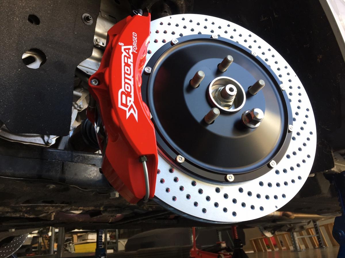

Xtra Posted March 12, 2018 Report Share Posted March 12, 2018 (edited) Also, Xtra I hope your looking at braking solutions soon cause a 450awhp 4400lb machine is going to take a lot to stop.... Have that covered with a Rotora big brake kit already installed on the front and back. 6 piston 15 inch fronts and 14 inch 4 piston rears . Roots57 and I both have this setup but his are slotted and mine are drilled rotors . Edited March 12, 2018 by Xtra 2 Quote Link to comment Share on other sites More sharing options...
