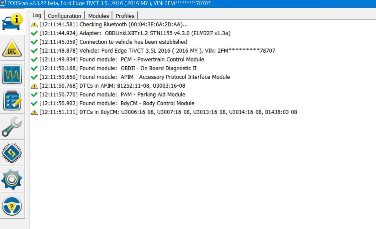

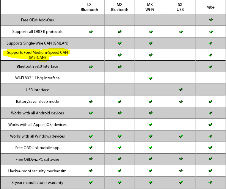

Gadgetjq Posted May 22, 2019 Report Share Posted May 22, 2019 (edited) Hi Edge owners, I'm a complete newbie (got my Edge Monday). I've searched this thread and others on the forum but can't find a solution to my pesky little problem. Hopefully one of the more experienced hands can point me in the right direction. I want to turn off the horn honk when I leave the car with the fob (I'm fiddling and cleaning right now and keep walking away with the fob I also want to modify the lane change mode from stock 3 blinks to six just because I live in an area with a lot of older drivers (I'm one of them) who need more than 3 blinks to realize something's afoot. Thanks to assorted posts here I've found the code changes (thanks to all for those) but in FORScan I can't see (SCCM) at all (screen grab below) nor can I see any 724 xxx codes, all I get is 726 xxx. Toggling the horn and modifying the lane change setup apparently requires finding both missing items This is a 2016 3.5L TI using OBDLink LX bluetooth OBD reader (I know MX is recommended but I already have the other...maybe that's the problem?) I'd sure appreciate a solution (even a suggestion) to help solve this problem. BTW, to the method for cancelling auto stop/start, I actually have that in one of the car's menus (Settings/Vehicle/Auto Stop). Check or uncheck to turn on/off. Maybe that doesn't appear in all models, I dunno but work taking a look. Cheers! Edited May 22, 2019 by Gadgetjq Quote Link to comment Share on other sites More sharing options...
ben senise Posted May 22, 2019 Author Report Share Posted May 22, 2019 2 hours ago, Gadgetjq said: Hi Edge owners, I'm a complete newbie (got my Edge Monday). I've searched this thread and others on the forum but can't find a solution to my pesky little problem. Hopefully one of the more experienced hands can point me in the right direction. I want to turn off the horn honk when I leave the car with the fob (I'm fiddling and cleaning right now and keep walking away with the fob I also want to modify the lane change mode from stock 3 blinks to six just because I live in an area with a lot of older drivers (I'm one of them) who need more than 3 blinks to realize something's afoot. i did these on my 2016 Ti 3.5 AWD: Turn Signal Flashes Change number of turn signal flashes on a quick tap of the stalk from the default of 3. (SCCM) 724-01-01 xxxx xXxx xx 0 = One Flash 4 = Two Flashes 6 = Three Flashes - (Default C02D 0600 xx ORIGINAL) 8 = Four Flashes A = Five Flashes C = Six Flashes E = Seven Flashes Door Close Double Horn Honk (Engine Running Without Keyfob Detected (PTS)): BdyCM 726-41-02 (2014+ MY) xxxX xxxx xxxx 1 (Enabled - Default) 0 (Disabled) 1 Quote Link to comment Share on other sites More sharing options...
omar302 Posted May 23, 2019 Report Share Posted May 23, 2019 8 hours ago, Gadgetjq said: Hi Edge owners, I'm a complete newbie (got my Edge Monday). I've searched this thread and others on the forum but can't find a solution to my pesky little problem. Hopefully one of the more experienced hands can point me in the right direction. I want to turn off the horn honk when I leave the car with the fob (I'm fiddling and cleaning right now and keep walking away with the fob I also want to modify the lane change mode from stock 3 blinks to six just because I live in an area with a lot of older drivers (I'm one of them) who need more than 3 blinks to realize something's afoot. Thanks to assorted posts here I've found the code changes (thanks to all for those) but in FORScan I can't see (SCCM) at all (screen grab below) nor can I see any 724 xxx codes, all I get is 726 xxx. Toggling the horn and modifying the lane change setup apparently requires finding both missing items This is a 2016 3.5L TI using OBDLink LX bluetooth OBD reader (I know MX is recommended but I already have the other...maybe that's the problem?) I'd sure appreciate a solution (even a suggestion) to help solve this problem. BTW, to the method for cancelling auto stop/start, I actually have that in one of the car's menus (Settings/Vehicle/Auto Stop). Check or uncheck to turn on/off. Maybe that doesn't appear in all models, I dunno but work taking a look. Cheers! It is probably due to the limitations of the OBDLink LX. It cannot access MS-CAN and hence would not see the modules working on MS-CAN, also there are newer HS-CAN2 & HS-CAN3 which i am not sure if the LX can see. The SCCM is on MS-CAN so you won't be able to change that, but for the Double Horn Honk just follow @ben senise post above. 1 Quote Link to comment Share on other sites More sharing options...
Gadgetjq Posted May 23, 2019 Report Share Posted May 23, 2019 Ben and Omar, thank you! That was exactly the information I was looking for (however disappointing). Now that I know my LX code reader isn't up to the task I've ordered a wired version (as recommended earlier in this thread) from Amazon. You guys rock! Quote Link to comment Share on other sites More sharing options...
omar302 Posted May 23, 2019 Report Share Posted May 23, 2019 3 hours ago, Gadgetjq said: Ben and Omar, thank you! That was exactly the information I was looking for (however disappointing). Now that I know my LX code reader isn't up to the task I've ordered a wired version (as recommended earlier in this thread) from Amazon. You guys rock! It is not about the wired vs. not wired. The MX is better, considered the best for such things. Even the wired readers don't necessarily read all protocols. They would require a switch to allow it to read MS-CAN. Also the OBDLink SX (the wired version) from them can't read MS-CAN. 3 Quote Link to comment Share on other sites More sharing options...
