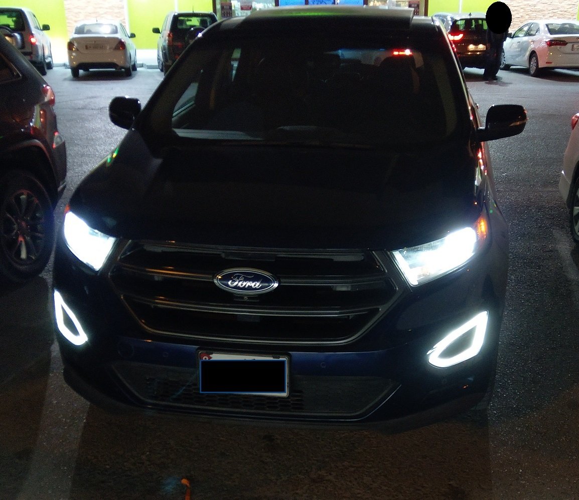

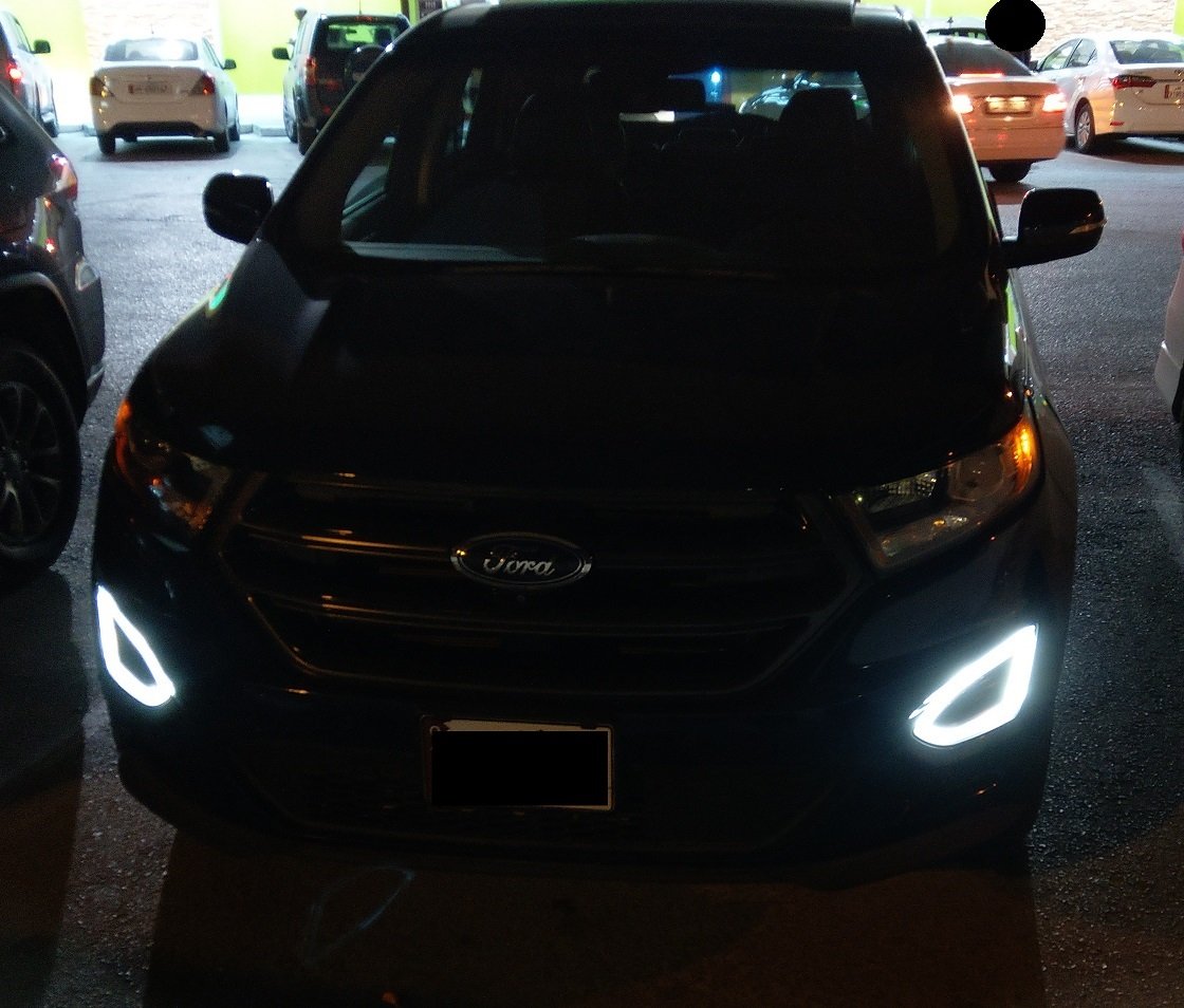

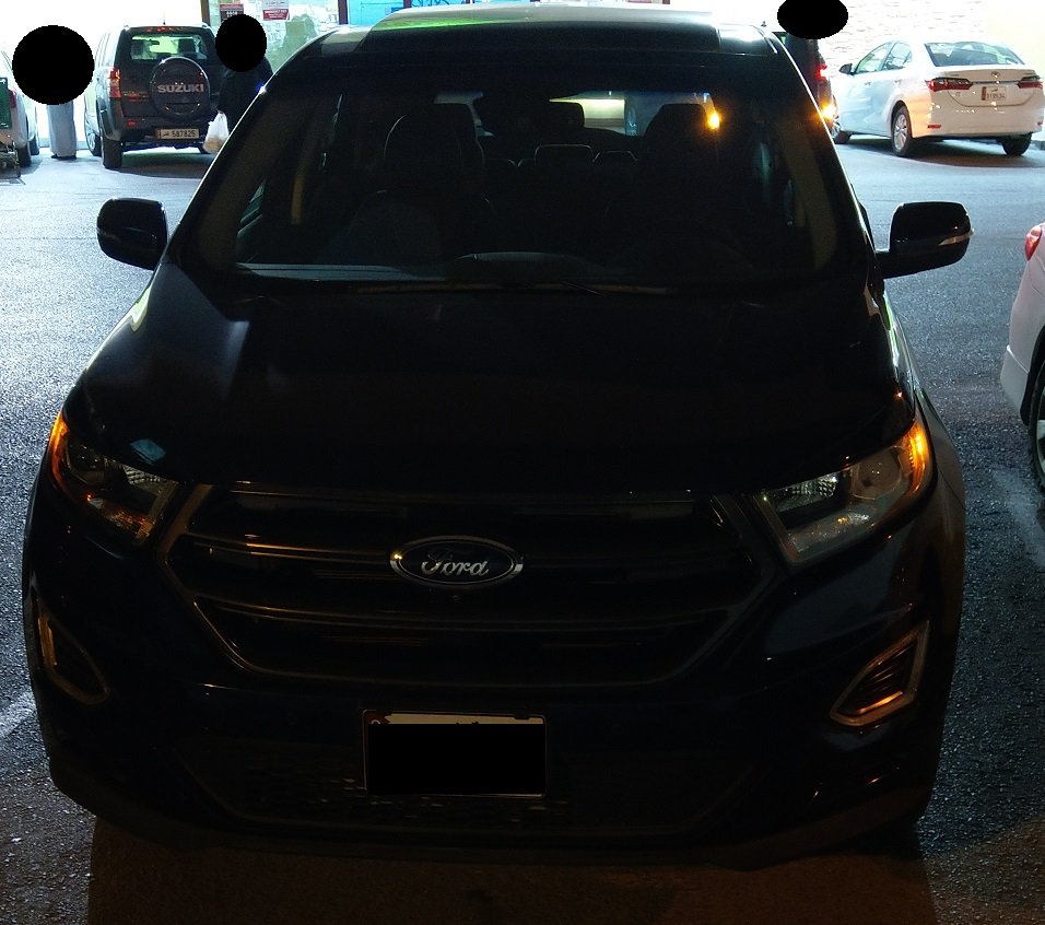

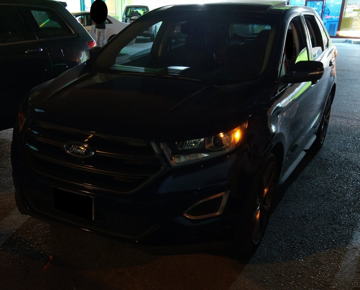

omar302 Posted December 8, 2018 Report Share Posted December 8, 2018 (edited) I posted this in in another post, but thought should also be posted here: Make the front signal bulb only function as a turn signal bulb and will not turn on with the parking lamps. Side marker will not be affected. 726-29-02 xxx* xxxx xxxx Front Turn Position Lamps Cfg: 0=Turn_Only, 1=Turn_Position Explanation: 0: (stock) The front signal bulb will function as a turn signal bulb only. 1: The front signal bulb will function as a turn signal (at full brightness) and as a parking light (reduced brightness) Now with the ignition/engine on i have the small LED side markers on & the signature lights on the bumper. Now the issue with this is when turning the parking lights on with ignition/engine off, the signatures lights don't come on, so there would only be the LED side markers. Another thing I tried and worked, but not really useful for me: 726-29-02 x*xx xxxx xxxx DRL Position Lamp Cfg: 0=DRL_Only, 1=DRL_Position, 2=Fixed DRL Position, 3=Stop Turn What I tried:: 0: (stock) The stand alone DRL will function normally (for me with HID the DRL are the dedicated bulbs). 1: The DRL will work normally in addition to also turn on with the parking lights. This worked for me. 2 & 3: I don't know & forget to try! Edit: tried 2 & 3 and got configuration errors. Edited January 1, 2019 by omar302 Spelling mistakes. 2 Quote Link to comment Share on other sites More sharing options...
omar302 Posted December 8, 2018 Report Share Posted December 8, 2018 Got some night pictures with the parking lights disabled as per the above post.. 1 Quote Link to comment Share on other sites More sharing options...
tmarsh Posted December 10, 2018 Report Share Posted December 10, 2018 Thanks for that one Omar. Just what I needed for my new switchback signature bezels to work like switchbacks. Because the front turn signals are 2-wire instead of 3-wire, any time that bulb was on (even in marker/dim) it would cause the switchbacks to be amber. ] It also looks better this way with the headlights and my new foglights on, without the turn signal on. Will post pics later. Quote Link to comment Share on other sites More sharing options...
