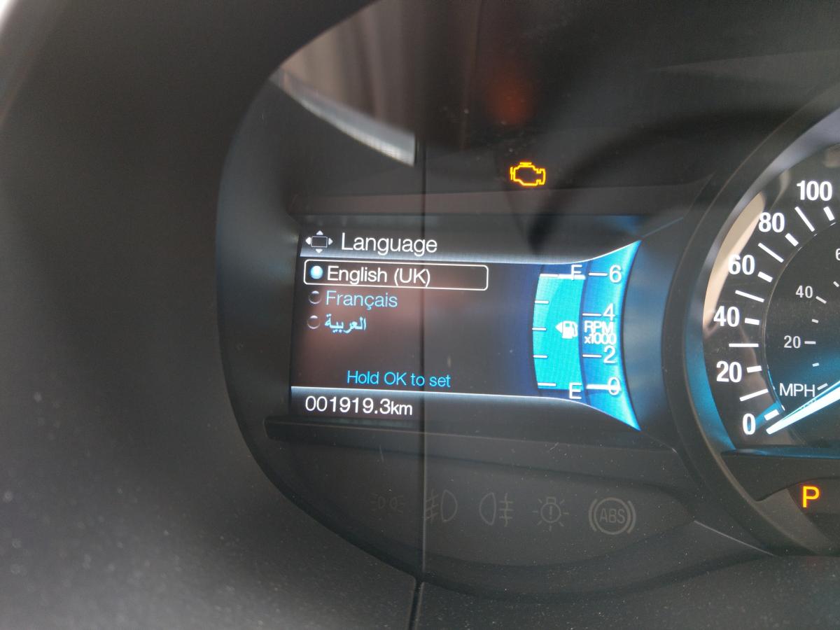

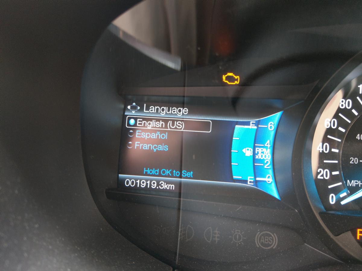

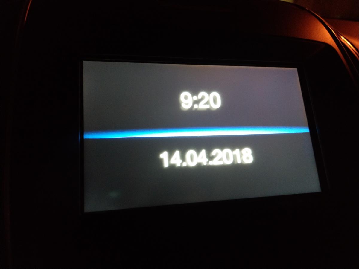

omar302 Posted April 14, 2018 Report Share Posted April 14, 2018 So today I figured out 2 more mods: 1st, is the country of the IPC: 720-04-02: XXXX xx - US default is 5553. On my Edge it was 5141. So what I found changing it is that I get different language options for the IPC. Like I had English (UK), French & Arabic, while US will get English (US), Spanish & French. Also, with English (UK) the door open warning states Door "Open" instead of "Ajar" for US. Just some language differences. 2nd: This is probably only a Sync 2 (MFT) thing: 7D0-01-01: xxxX xxxx xx - My default was "A", adding 4 changed it to "E", when you turn off the ignition you usually get a quick Ford logo shutdown animation on the MFT 8" screen, with this edit, you'll instead get a black screen with the date & time that will remain there for a while or until you lock the vehicle. Note that the date format depends on the MFT language pack, since mine has the EU pack the date is in EU format (month in the middle). 1 Quote Link to comment Share on other sites More sharing options...
cv27 Posted April 14, 2018 Report Share Posted April 14, 2018 Good catch! Thanks. Quote Link to comment Share on other sites More sharing options...
