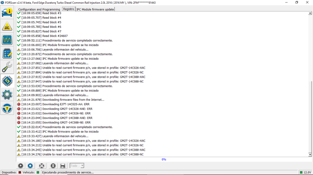

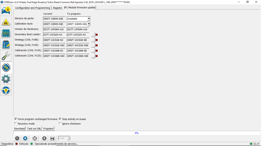

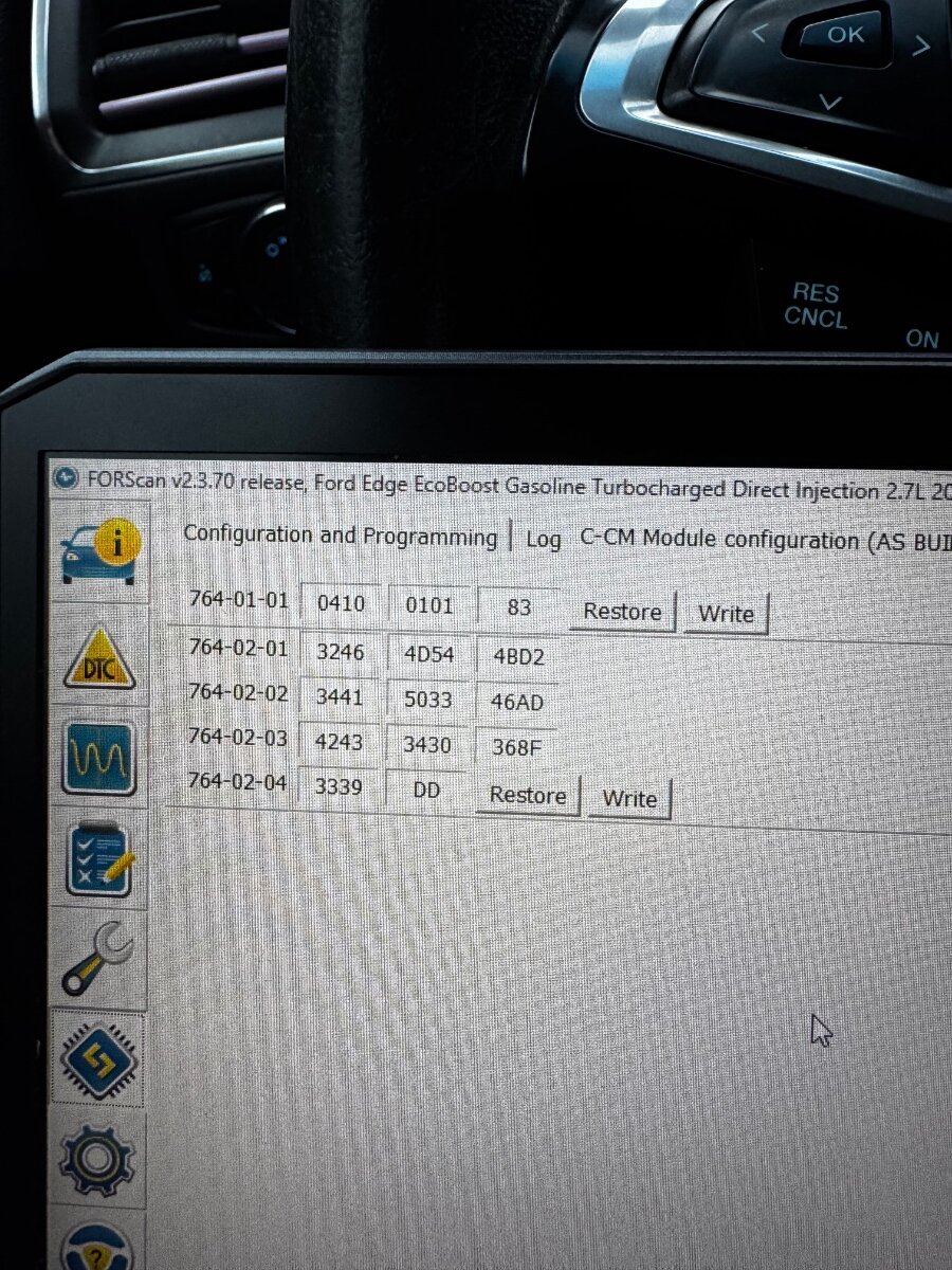

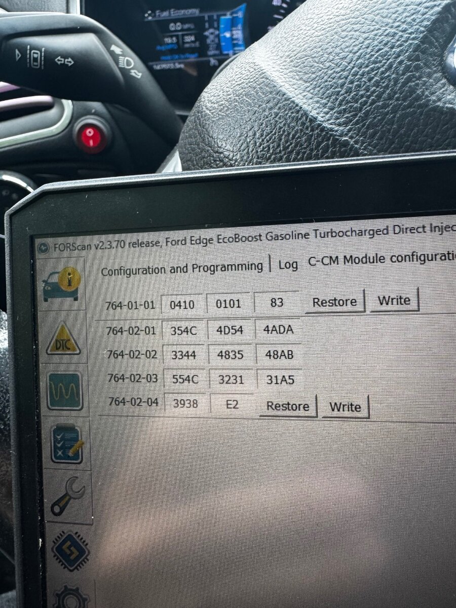

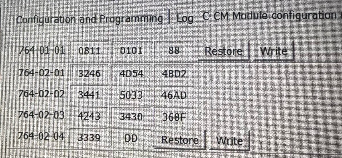

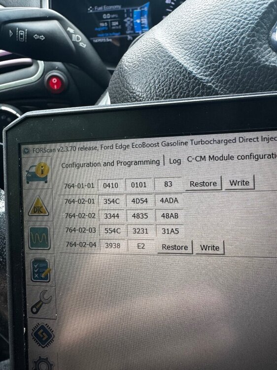

ronkeras Posted October 6, 2024 Report Share Posted October 6, 2024 Hello, how are you? This time I need an answer. I have read everything about the firmware, or at least I think so, and I am still not sure if I can update or not, it is possible... anyway, I am very confused. I am posting some images to see if you can help me. Thanks everyone. Sorry if I already answered Quote Link to comment Share on other sites More sharing options...
