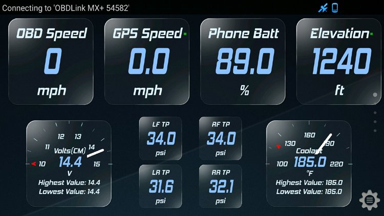

omar302 Posted November 9, 2019 Report Share Posted November 9, 2019 3 hours ago, Gadgetjq said: And now back to our original subject..... If you had the opportunity what would you put in the right info screen? Duplicates of items in the left side? Digital gauges for trans/ptu/oil temps etc? How about some or all of the gauges available in the Torque Pro app offering up battery voltage, elevation, trip info (time/fuel used/average speed/fuel used). How about detailed error code info like you'd get with a code reader plugged into the OBDII port? ?????? ? I'd like to have one screen with guages (round tachometer, fuel & temp) and the other for the balance scrollable information screens already available currently. Also, make the digital speedometer visible in a corner of the screen, with other selected information, instead of taking the whole screen. One more is to put a small distance to empty reading in the fuel gauge. I like my information to be always available. ? 1 Quote Link to comment Share on other sites More sharing options...
Gadgetjq Posted November 9, 2019 Report Share Posted November 9, 2019 (edited) 1 hour ago, omar302 said: ? I'd like to have one screen with guages (round tachometer, fuel & temp) and the other for the balance <snip>I like my information to be always available. ? Since Ford didn't do it for us how about an alternative? (Torque Screenshots Below) It's simple to add data displays to your phone screen. If there isn't room for something put it on the next (scrollable) page. What you need: Android phone, Torque Pro app, OBDII reader, vent or other phone holder. Edited November 9, 2019 by Gadgetjq 1 Quote Link to comment Share on other sites More sharing options...

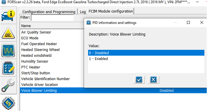

omar302 Posted November 21, 2019 Report Share Posted November 21, 2019 From this post on the 2GFusion forums, I was able to disable the feature where the HVAC blower speed would go to a low speed during a call on bluetooth. Also, at least on the latest build, ForScan already has this feature under FCIM. 7A7-01-04 x0xx (for my Edge, stock was "8", changed to "0" when disabled). Quote Link to comment Share on other sites More sharing options...
