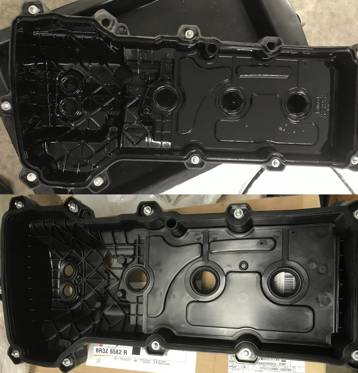

Gbczyk84 Posted September 13, 2017 Report Share Posted September 13, 2017 (edited) After finding oil in the air filter of our 3.5L 2011 Edge, i purchased the updated valve cover to fix the issue. Replacement was easy, besides keeping all of the wires out of the way. This is not a How-to as FordTechMakuloco has all the information on YouTube. Simply posting some photos of the inside for those interested. I could not tell any physical difference between the 2 parts. Part number - BR3Z-6582-R Edited September 14, 2017 by Gbczyk84 1 Quote Link to comment Share on other sites More sharing options...

omar302 Posted September 14, 2017 Report Share Posted September 14, 2017 Is it just me? I don't see where the difference is between the old & new covers! Quote Link to comment Share on other sites More sharing options...
WWWPerfA_ZN0W Posted September 14, 2017 Report Share Posted September 14, 2017 (edited) Looks like the baffling around the lower right hand part of the valve cover in this pic is deeper, for one thing. That seemed prominent to me, but could be light & shadows. Plus those 3 shapes are extended. Edited September 14, 2017 by WWWPerfA_ZN0W 2 Quote Link to comment Share on other sites More sharing options...
macbwt Posted September 14, 2017 Report Share Posted September 14, 2017 Looks like the baffling around the lower right hand part of the valve cover in this pic is deeper, for one thing. That seemed prominent to me, but could be light & shadows. Plus those 3 shapes are extended. Updated Valve Cover Gen 1-5_4_Comparison.jpg I plan on finding out because I will cut it up to look when I finish installing the new one. Not cutting up the new one but at least will see the inside of the old one. 1 Quote Link to comment Share on other sites More sharing options...
freebird Posted September 14, 2017 Report Share Posted September 14, 2017 (edited) On the "narrow end" of the cover there is a ford part number in molding. What are they they on the new vs old? I honestly don't see a difference either and think you simply changed a like for like cover. edited to add - I do see a difference in the far side of the "narrow" side of the cover - there are baffle intakes slots. Edited September 14, 2017 by freebird 3 Quote Link to comment Share on other sites More sharing options...

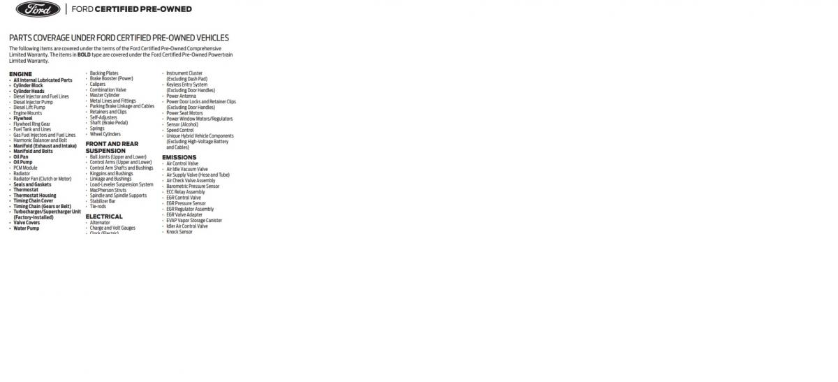

pedro2u Posted September 15, 2017 Report Share Posted September 15, 2017 My CPO Powertrain Limited Warranty (7yr, 100K miles) says it covers "valve covers". Is it a stretch to think this would be repaired under the CPO warranty? 1 Quote Link to comment Share on other sites More sharing options...
akirby Posted September 15, 2017 Report Share Posted September 15, 2017 Does it mention valve cover gaskets specifically? 1 Quote Link to comment Share on other sites More sharing options...
pedro2u Posted September 15, 2017 Report Share Posted September 15, 2017 Just lists Valve Covers as a covered item (items in BOLD are covered) 1 Quote Link to comment Share on other sites More sharing options...
omar302 Posted September 15, 2017 Report Share Posted September 15, 2017 I'd say they are covered, but don't go to the dealer asking for a replacement, rather complain about the oil in the intake system. 2 Quote Link to comment Share on other sites More sharing options...
Gbczyk84 Posted November 9, 2017 Author Report Share Posted November 9, 2017 So. Almost 2 month update since the replacement, pulled the air filter and again it is covered in oil.. maybe not as bad as prior, it is still oiled now. So anyone have any words of wisdom? I also have a 2013 SHO with a similar issue, that of course also has a updated valcover fix available. Im hesitant on purchasing one for that vehicle seeing the fix for the edge doesnt really solve it. Quote Link to comment Share on other sites More sharing options...
Gbczyk84 Posted November 9, 2017 Author Report Share Posted November 9, 2017 Is it just me? I don't see where the difference is between the old & new covers!Since I still have oil in the air filter 2 months since the replacement, there may not be a difference between old and new. 1 Quote Link to comment Share on other sites More sharing options...
WWWPerfA_ZN0W Posted November 9, 2017 Report Share Posted November 9, 2017 well, that's not good! have you replaced the pcv valve yet? Quote Link to comment Share on other sites More sharing options...
omar302 Posted November 9, 2017 Report Share Posted November 9, 2017 Since I still have oil in the air filter 2 months since the replacement, there may not be a difference between old and new. On my MKX, before the replacement cover, I saw oil on the intake tube up to the throttle body, though did not see it on the filter itself. I had the cover replaced at least a 18 months ago, and recently I checked & still no oil was present in the intake tube or throttle body. When you have the valve cover replaced, did you clean the whole intake tube? Maybe there was oil residue. 1 Quote Link to comment Share on other sites More sharing options...
