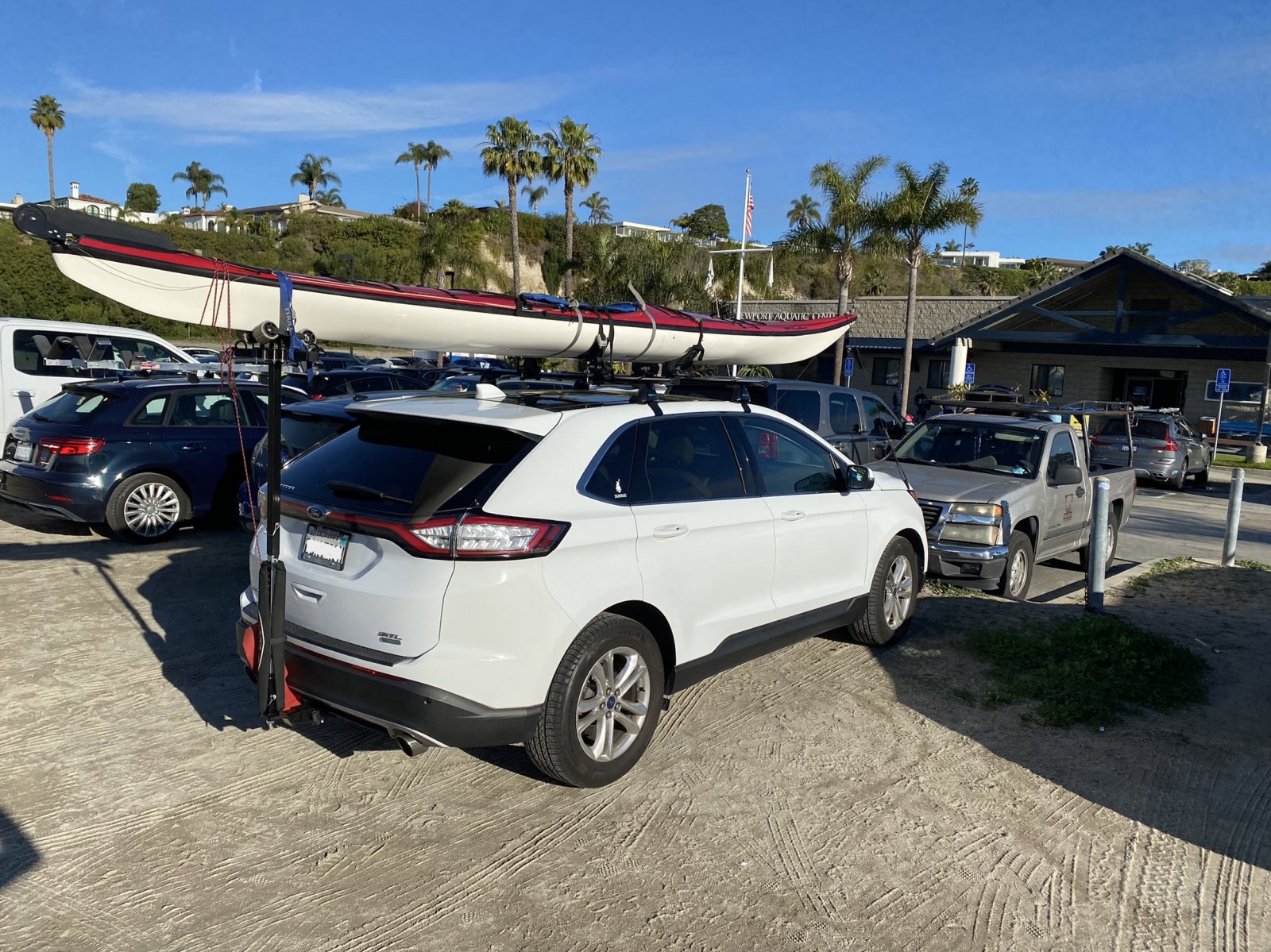

It's an old thread, but I'm adding this for anyone trying to research an answer. I've used Yakima Corebars for  a naked roof, Yakima and Thule saddles and  a Reese Canoe loader I modified with Huly Rollers. The Canoe loader attaches to an aftermarket Eckhart trailer hitch that doesn't negate the foot sensor liftgate. You have to be careful not to trip the sensor while working around the back. My fiberglass Sea kayak is 18.3 ft. long and around 65 lbs heavy. I drive about an hour at 60-65 mph on the Frwy. to my favorite parking spot. The hardest part for this senior citizen  is getting the kayak on and off the car by myself. Telescoping the  Reese canoe loader up and down helps. I barely have enough room to store my boat at home, wish I had the storage room and money for a Yakima Rack and Roll. You do what you can!large.9A690A13-FA56-45B6-8DC7-F835A773B1CC.jpeg.52523ee33b8e90622d7431b5afb64ae8.jpeg
