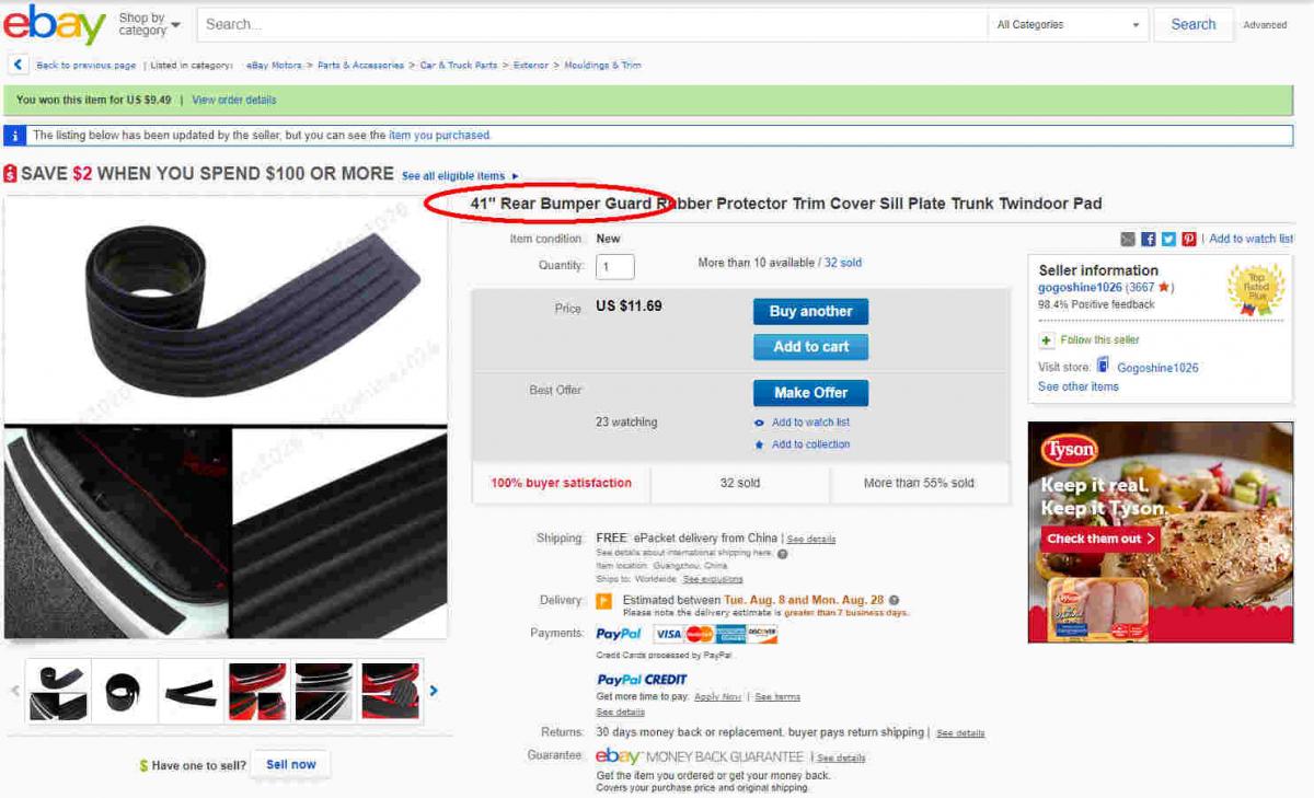

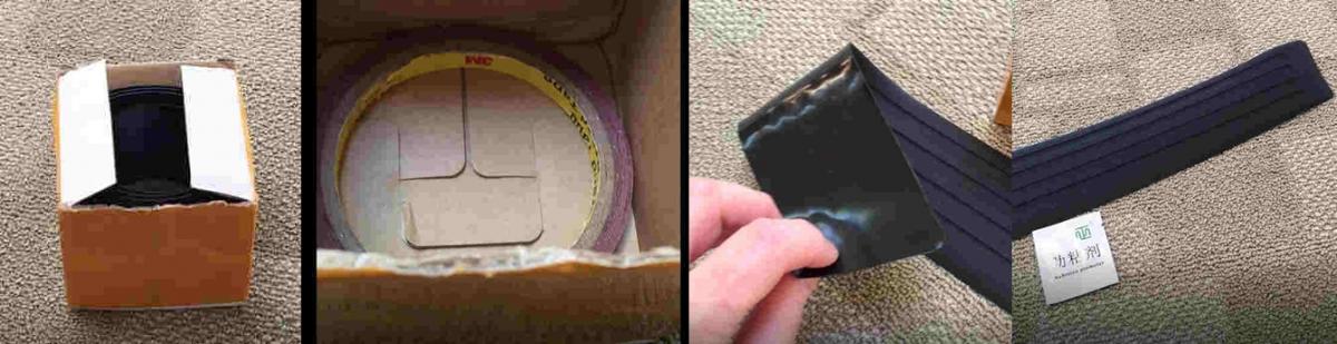

Picture1 - I did some research and found many different ones on eBay. The one I bought cost $9.49 delivered straight from China (it arrived in < 10 days, I was surprised). You will find many different suppliers sell this same item. It is 41” in length, comes with 3M tape and a wipe to clean your bumper before application. (Note, there are also 35” ones being sold, they are too short for our Edges in my opinion.)

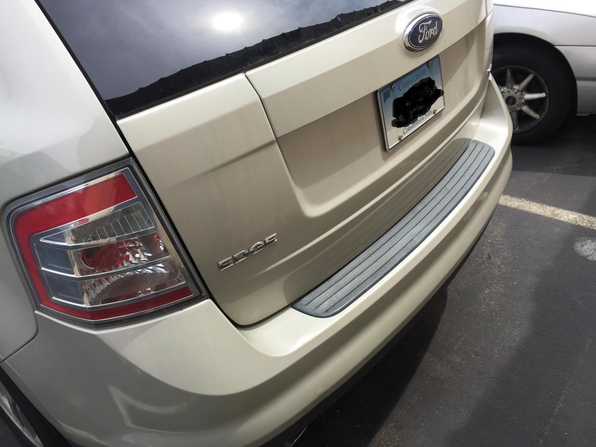

Picture2 – This is how it arrives and what is included. On the negative side, the tape was placed in the bottom of the box so when I pulled it out, the edge of the rolled up tape picked up some cardboard paper from the box. Not the end of the world. I was happy to see that the guard was curved and could be adjusted quite easily (straighter or more curved) so I wasn’t concerned about it not fitting the bumper correctly.

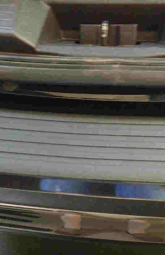

Picture3 – Shows what it looks like after I applied the tape. A couple of notes here: It doesn’t say how much tape is included. I decided I wanted a vertical strip right in the middle and on each end. I then wanted 3 strips between them. There was not quite enough tape to do that. I had some other double stick tape that I used when I ran out. I would estimate that they want you to simply run 3 long strip horizontally along the length of the guard.

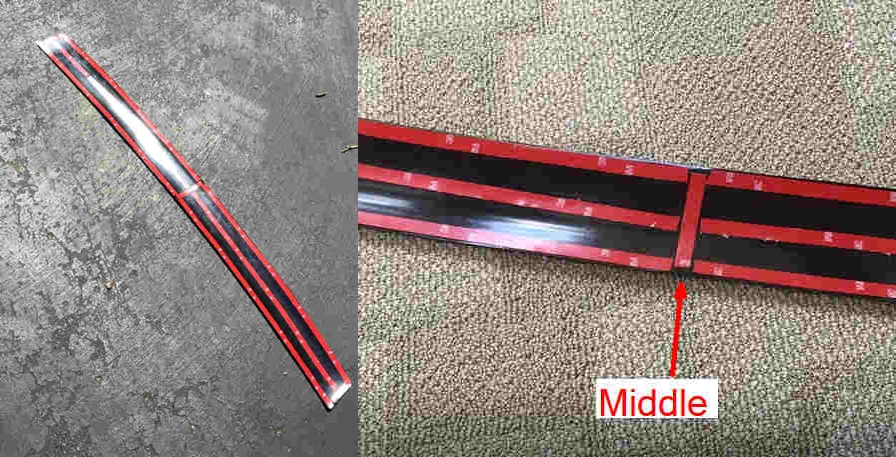

I cleaned the top of my bumper and started to install the guard. I took the backing off the middle vertical piece and lined that up with the hatch latch that is in the middle of the back. I made a point to put this close to the end of the back of the bumper. The thinking is that this does not have a lip that wraps around the back of the bumper toward the ground, so putting in very close to the back edge may offer some extra protection. Once I had the middle adhered, I removed the backing on the 3 strips on one side and took my time and applied it (see Picture4). I made no special measurements. I then did the other side the same way.

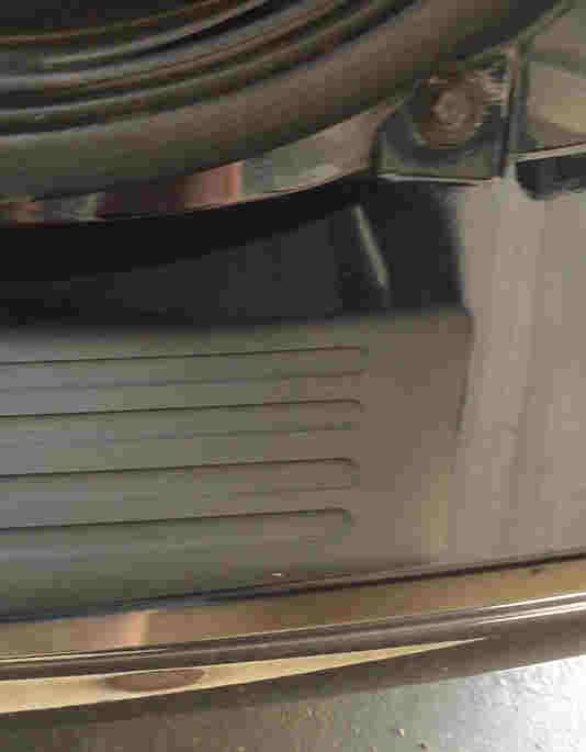

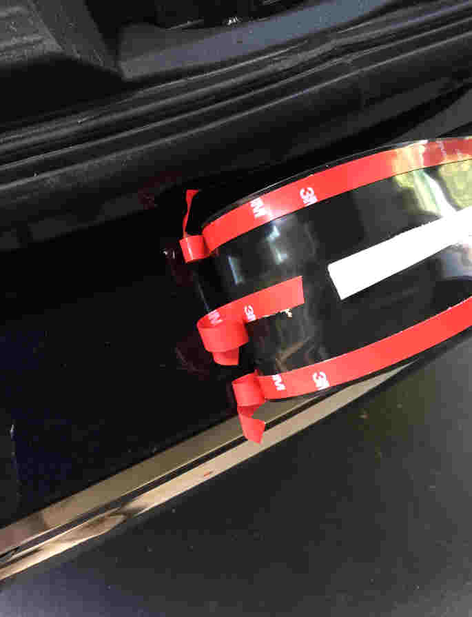

Pictures 5, 6 and 7 show the finished product. All in all I am happy with the results. It has been a couple days now and it has not blown off in driving or started to buckle/bulge, etc. I’ll update this thread after a few months and let you know if there are any changes. Let me know if you have any questions.
