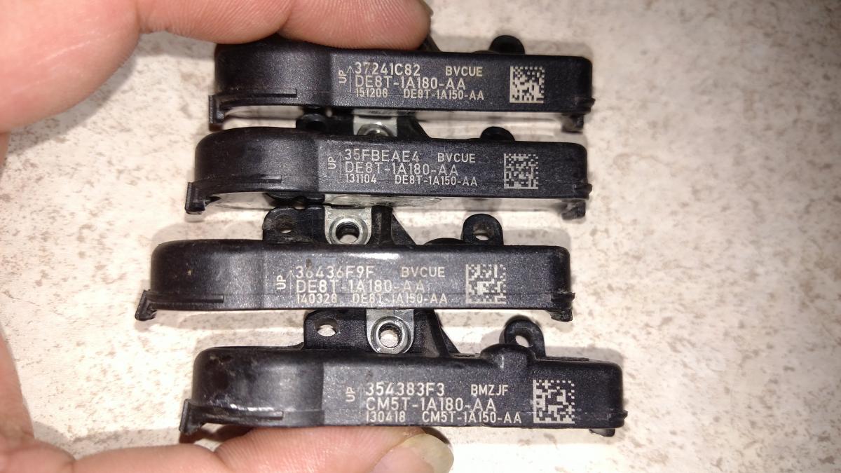

A quick search indicates that i have some tpms that might work from my winter wheels
DE8T-1A180-AA
http://www.tpms.com/2011_Ford_Edge_TPMS_s/5256.htm
According to that, the ones i have 'should' work. I can't assume any responsibility if they don't.
