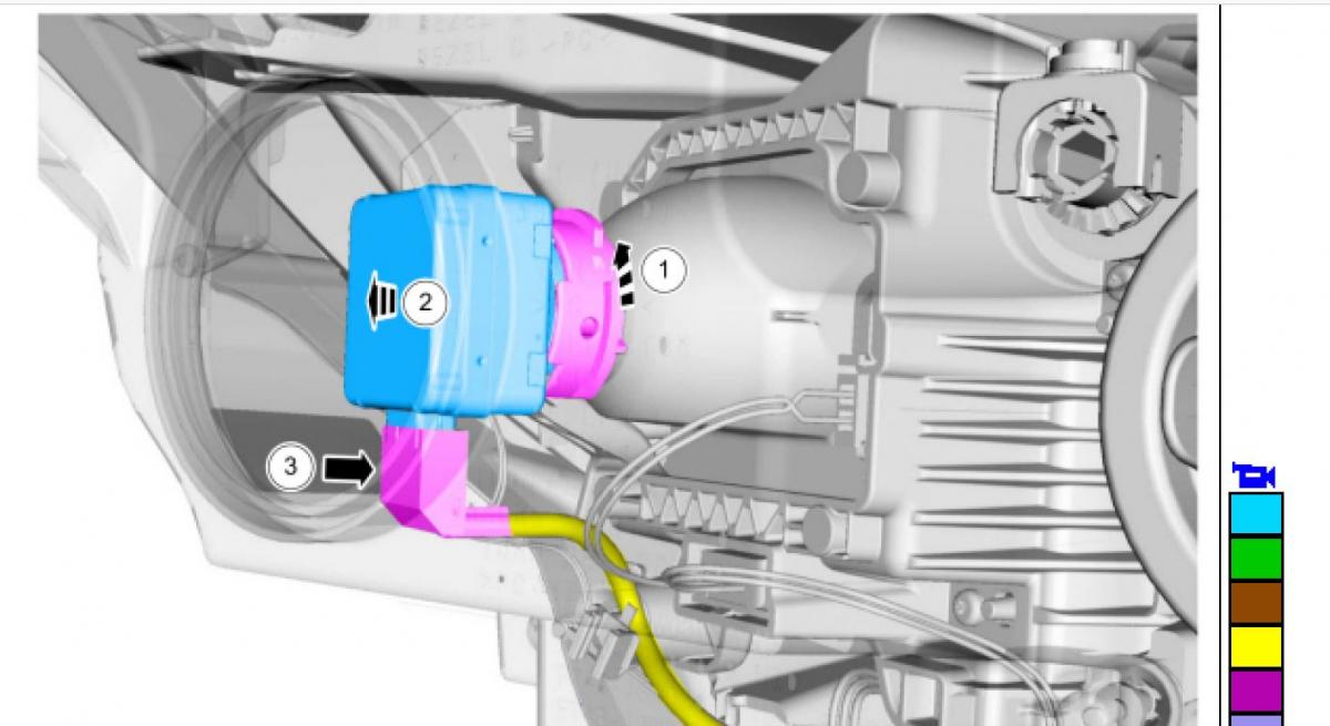

Beezz Posted July 13, 2017 Report Share Posted July 13, 2017 (edited) So there is a collar that is twisted after you insert the bulb (1) Picture attached. If the bulb is still loose then I'm not sure what you can do besides use heat resistant tape and secure it. Edited July 13, 2017 by Beezz 2 Quote Link to comment Share on other sites More sharing options...
Steve4225 Posted July 14, 2017 Author Report Share Posted July 14, 2017 Thank you for the reply, so do you know where the metal legs come into play? Do I just bend them out if the way? Quote Link to comment Share on other sites More sharing options...
Beezz Posted July 14, 2017 Report Share Posted July 14, 2017 Not sure, Ill check tomorrow for you. Maybe they rotate aswell? Quote Link to comment Share on other sites More sharing options...
Beezz Posted July 18, 2017 Report Share Posted July 18, 2017 (edited) Checked, and my housings dont appear to have those prongs.... NVM they do, you have to press the bulb into those prongs. They basically grasp around the rear power unit so it doesnt move. Edited July 20, 2017 by Beezz Quote Link to comment Share on other sites More sharing options...
