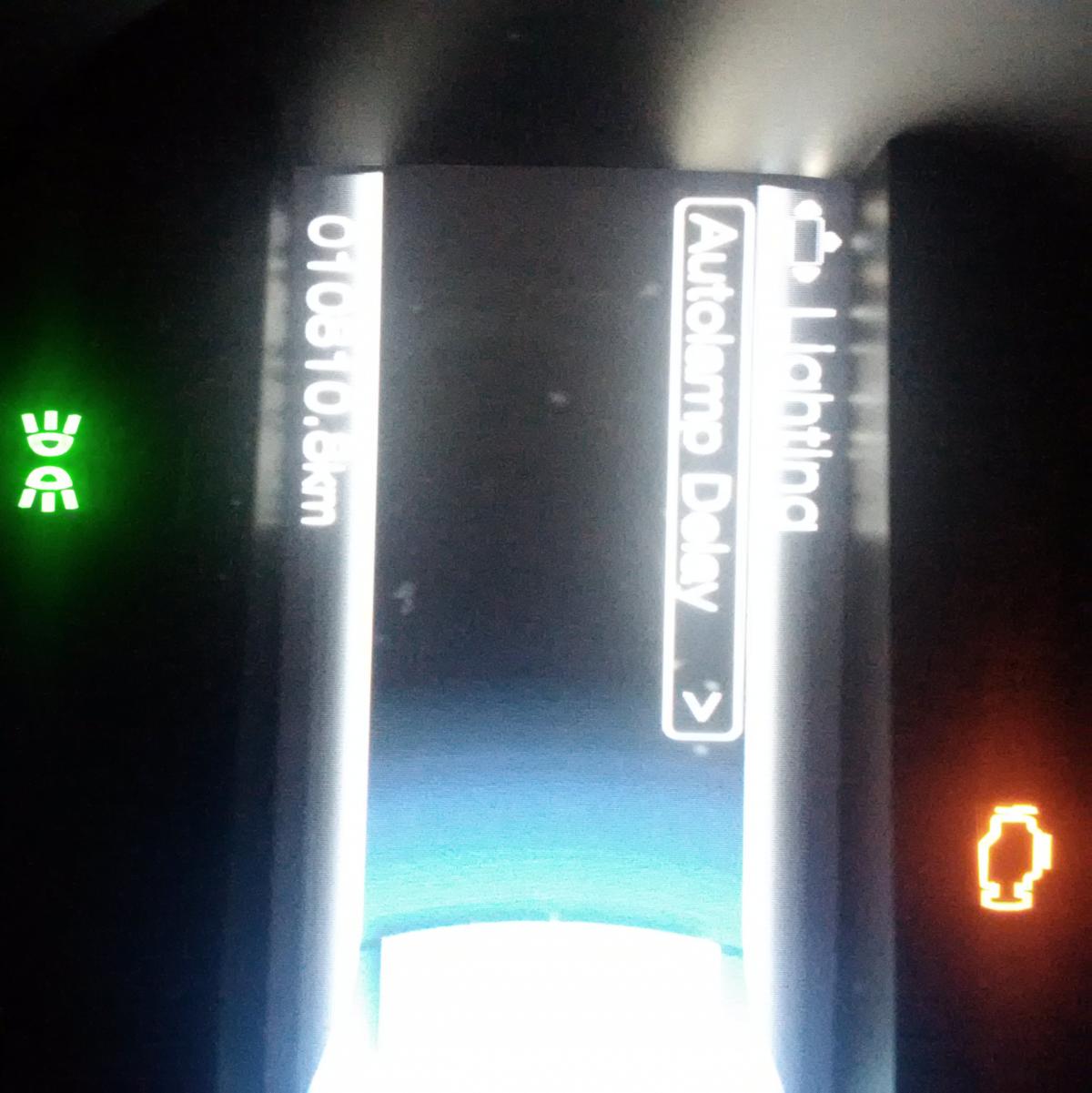

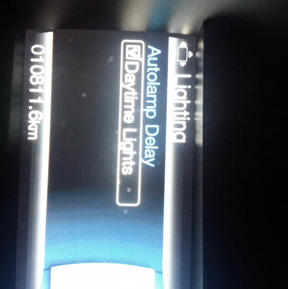

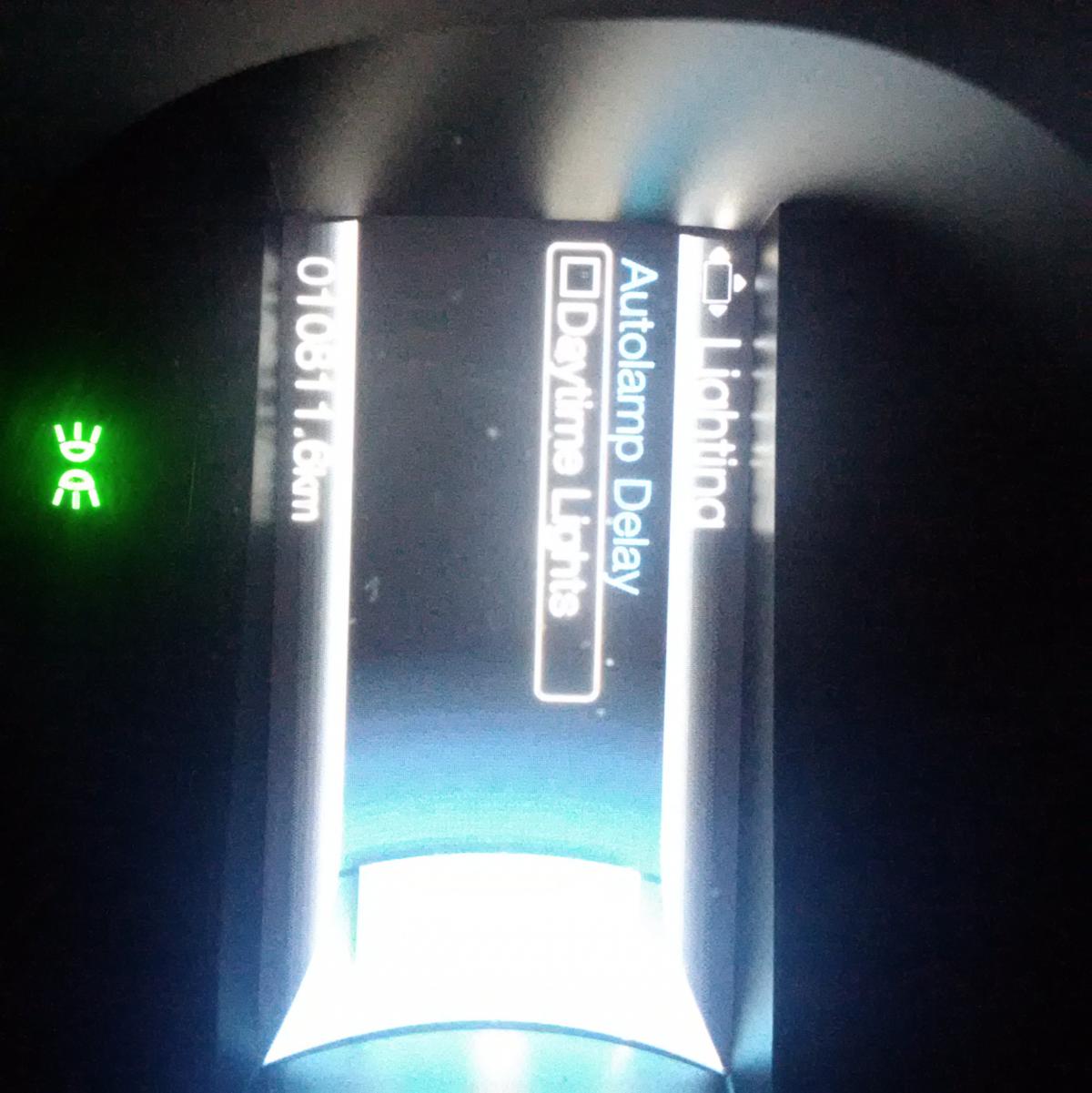

ONEDGE16 Posted July 8, 2017 Report Share Posted July 8, 2017 (edited) After a few days of research and thanks to an excellent write up from the G2 fusion forum, I was able to add Daytime Lights option to the left instrument cluster. I used OBDLink MX and Forscan (Windows 10) Link to G2 Fusion Info: http://www.2gfusions.net/showthread.php?tid=4573 Here are the pics: Before and after: At the same time added Climate to the right instrument cluster Edited July 8, 2017 by ONEDGE16 2 Quote Link to comment Share on other sites More sharing options...

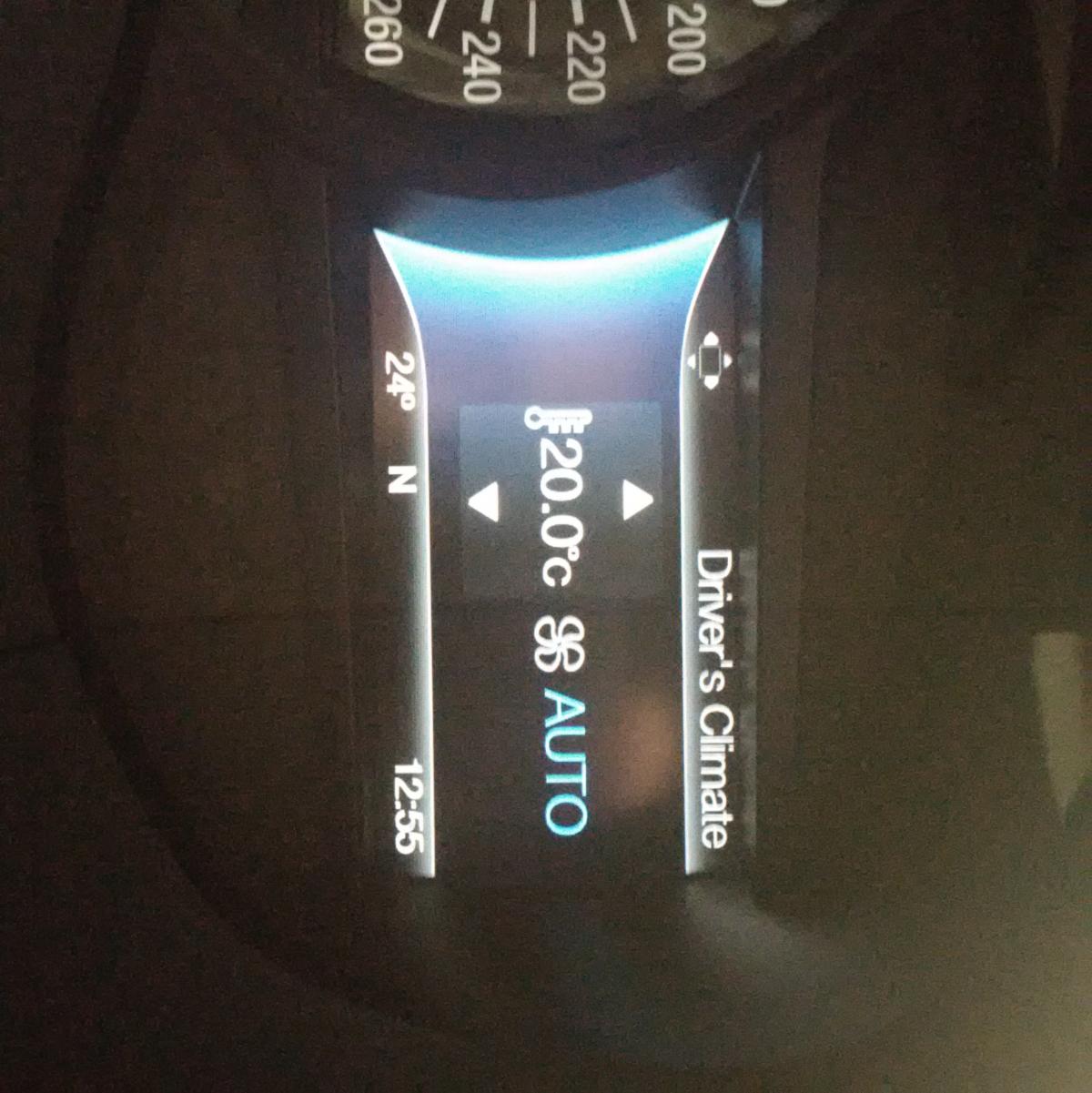

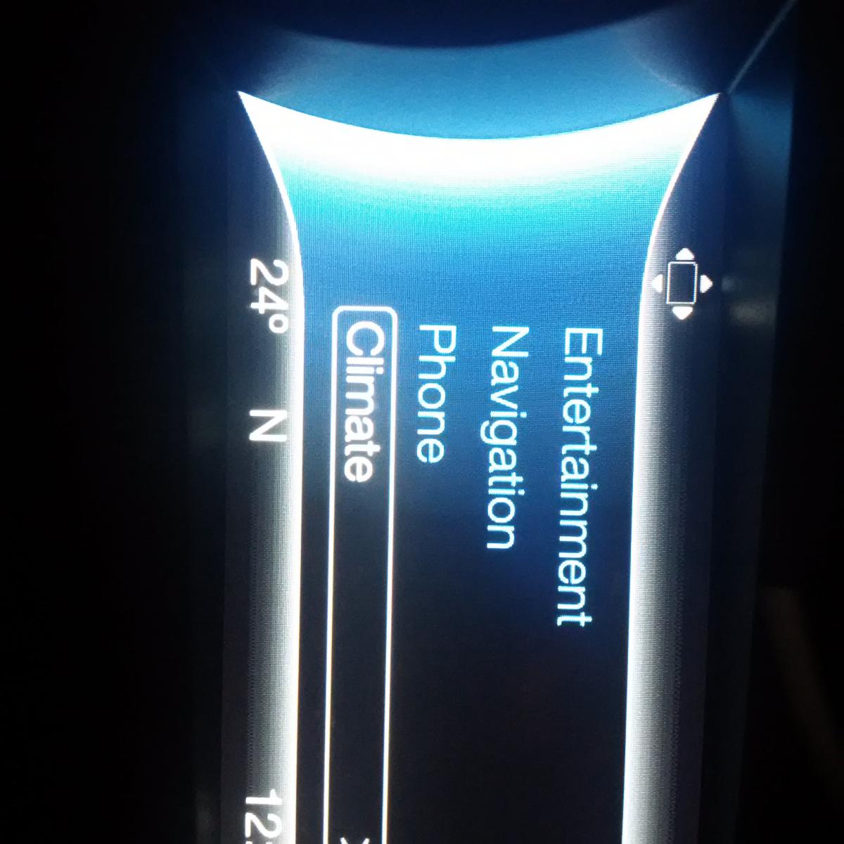

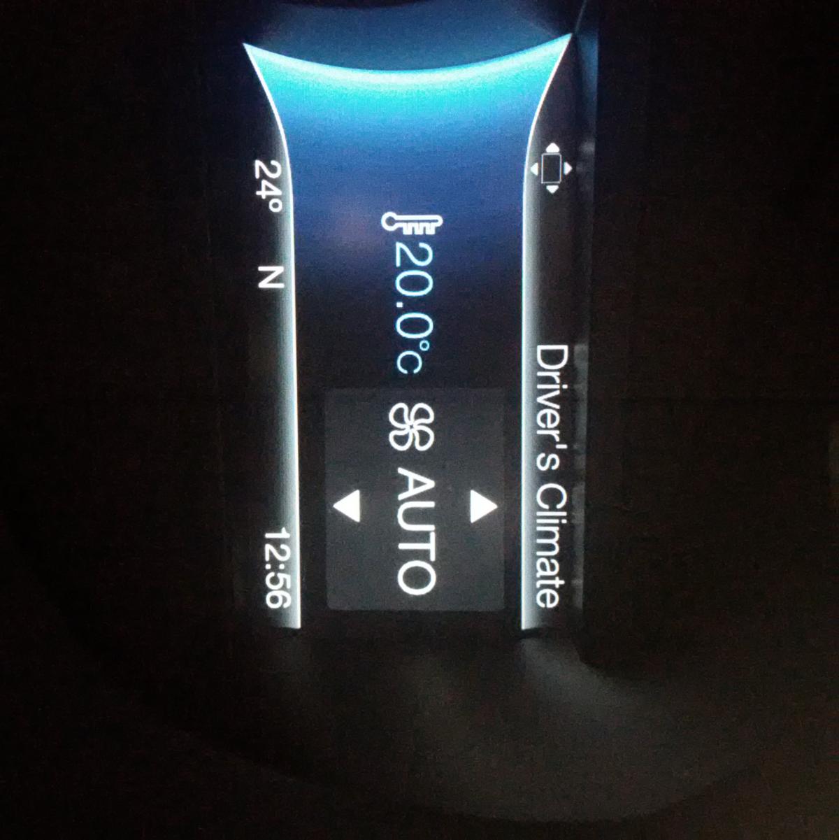

ben senise Posted July 10, 2017 Report Share Posted July 10, 2017 At the same time added Climate to the right instrument cluster if you have a chance, could you post a pic of the climate controls on the right cluster? i was thinking about getting the forscan setup and I think this might actually get to do it. Quote Link to comment Share on other sites More sharing options...
ONEDGE16 Posted July 10, 2017 Author Report Share Posted July 10, 2017 (edited) The NHTSA looked at the data and decided it was not statistically significant enough to prove a correlation with reduced accidents. My personal theory is that if you're turning into a lane with an oncoming vehicle close enough to hit you and you actually look, you'll see it with or without DRLs. Most accidents come from people not looking at all in which case DRLs won't help. The exception would be dusk if someone forgot to turn on their lights but the solution to that is to mandate automatic headlamps that come on before it gets too dark. What happens with DRLs is that people see the headlamps on and think they have their lights on but they don't and they have no taillights which could be even more dangerous. Motorcycles are different because of their size and the fact that people are typically looking for a car. Couldn't agree more. Low intensity DRLs with no tailights are not much of a safety feature. just today on the way to work came across a car on the road with jut DRLs on (no headlamps/tailights). I would be more in favor of mandatory auto headlamps and fog lights (both front and rear fog lights) Edited July 10, 2017 by ONEDGE16 Quote Link to comment Share on other sites More sharing options...
ONEDGE16 Posted July 10, 2017 Author Report Share Posted July 10, 2017 (edited) if you have a chance, could you post a pic of the climate controls on the right cluster? i was thinking about getting the forscan setup and I think this might actually get to do it. Here are the pics: here's the section that was changed: IPC 720-05-01 xxXx xxxx xxxx Change xxXx to xxBx (all other values remain unchanged) Edited July 10, 2017 by ONEDGE16 Quote Link to comment Share on other sites More sharing options...
