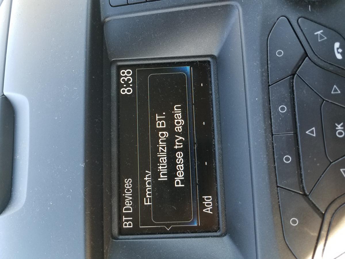

ClaytonL Posted July 7, 2017 Report Share Posted July 7, 2017 So my sync doesn't recognize my phone. The sync lost connection so I did a master reset like I've done in the past and now when I hit add phone it says - initializing by. Please try again. The car isn't even searching for a signal. The message pops up instantly. Any ideas for a fix? Quote Link to comment Share on other sites More sharing options...

ClaytonL Posted July 7, 2017 Author Report Share Posted July 7, 2017 I do that also. I remove the device and I also do the master reset. But now it doesn't even look for the phone Quote Link to comment Share on other sites More sharing options...

ClaytonL Posted July 7, 2017 Author Report Share Posted July 7, 2017 It's not the phone. The car doesn't try to get the signal. Quote Link to comment Share on other sites More sharing options...

ben senise Posted July 8, 2017 Report Share Posted July 8, 2017 I didn't realize you could turn it off. Where do I check that judging by the pic you posted, you have a different model of infotainment system than i do. according to the user manual for the '15 edge, p 261, go to the phone menu, select BT Devices, then ON/OFF. let me know if that's right and if it works. good luck! Quote Link to comment Share on other sites More sharing options...
