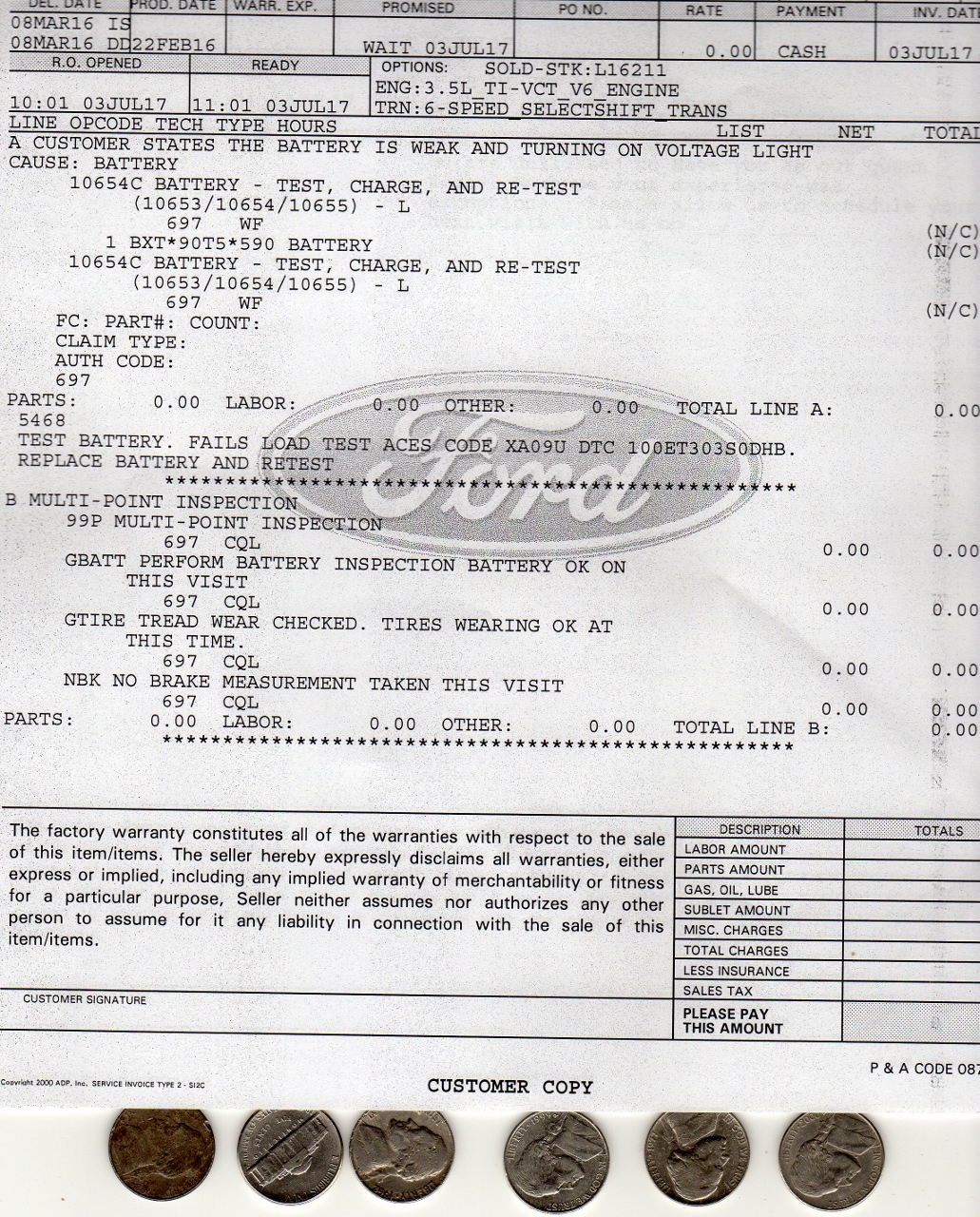

Well here is the rub. I went to get it checked again and was told it was good. As they removed the gear I was told it just needed to be re-charged. I told them that it had been on a float charger over night and that the Battery Tender was giving me a solid green light the next morning indicating a full charge. When I asked for the voltage I was told 12.48 V. This strikes me a low and would have expected a reading of 12.7 + or so. So I'll keep an eye on the voltage and if it falls into the low 12's I'll get my dealer to check it out. What I did discover is that (at least for this last check) their equipment will not detect a failing cell only a dead cell. No loose nickel's for you boy's just yet, but perhaps I should grab a roll the next time I visit my bank... ;)

Test no. 4 was the tell. My Ford Dealer did a load discharge and full recharge test and discovered that a battery cell was indeed failing. They replaced the battery under warranty and hopefully that will be the end of my issues. I just hope that there is not a parasitic voltage draw lurking somewhere that promoted the battery issue.
