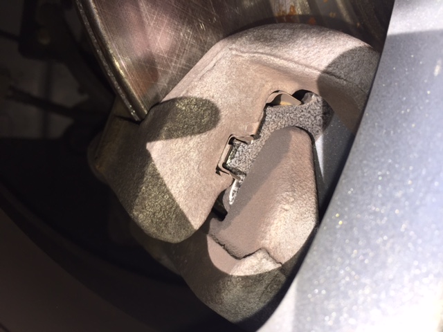

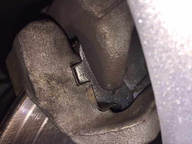

Mirage52 Posted June 29, 2017 Author Report Share Posted June 29, 2017 (edited) So I am at work now but I took a look at the clips and I think one of the sides are installed wrong since they look different. I attached pics of the passenger side and driver side for comparison. If I had to guess I'd say the passenger side is wrong. Any advice? EDIT: So it's definitely the passenger side!!! I can see the scratch marks on the rotor from the clips being backwards!!! Crap!!! I hope I didn't ruin these new rotors!!! Edited June 29, 2017 by Mirage52 Quote Link to comment Share on other sites More sharing options...

WWWPerfA_ZN0W Posted June 29, 2017 Report Share Posted June 29, 2017 If the groove is visible but not nail-snaggable, I would not worry about it. It won't "buff out" necessarily, but should not be detrimental to braking performance. Quote Link to comment Share on other sites More sharing options...
macbwt Posted June 30, 2017 Report Share Posted June 30, 2017 It will be fine. The pad will wear to adjust to the rotor. 1 Quote Link to comment Share on other sites More sharing options...
Mirage52 Posted June 30, 2017 Author Report Share Posted June 30, 2017 (edited) Fixed it last night. The groove is not deep at all. Seems to be back to normal now. Thanks guys. Happy 4th to all. Edited June 30, 2017 by Mirage52 2 Quote Link to comment Share on other sites More sharing options...
