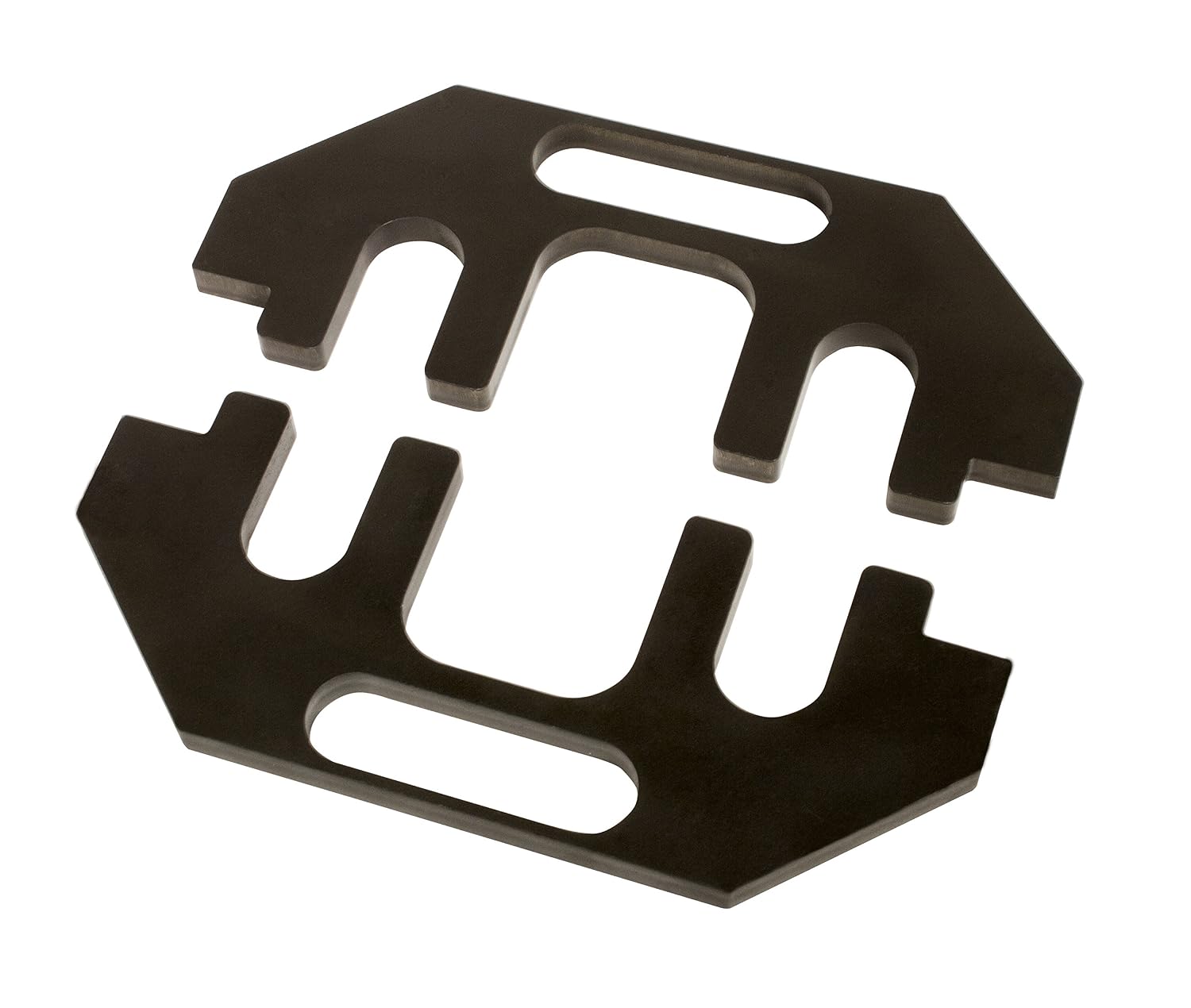

Decojuicer Posted August 26, 2017 Author Report Share Posted August 26, 2017 After watching a couple of videos, I realize that I'm supposed to have a Cam Tool Set (OTC 6682) in order to change the timing chain. None of my local parts stores rent that tool though. Is it necessary? 1 Quote Link to comment Share on other sites More sharing options...
Decojuicer Posted August 27, 2017 Author Report Share Posted August 27, 2017 I ended up just ordering the tool. Why not? In for a penny, in for $1000 worth of new tools. 1 Quote Link to comment Share on other sites More sharing options...
WWWPerfA_ZN0W Posted August 27, 2017 Report Share Posted August 27, 2017 (edited) Wow, expensive! Must be gold or platinum plated ... macbwt had suggested open end wrenches + vise grip at one point ... Ā https://www.amazon.com/Lisle-37100-Timing-Tool-Ford/dp/B06Y2B6C1Z/ Edited August 27, 2017 by WWWPerfA_ZN0W Quote Link to comment Share on other sites More sharing options...
