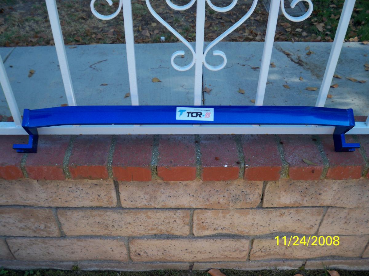

Xtra Posted July 26, 2017 Author Report Share Posted July 26, 2017 (edited) The STB was such a success, I have decided to add the rear brace this week. Galpin Auto Sports is doing the install as custom longer bolts are needed. The install itself is a 10 min easy access job, but the stock bolts are too short. After installing the STB the steering became laser like and was less effort on turns to keep a line. Both front tires stuck to the road and the improvement was substantial. The problem now is the inside rear tire is unweighting in high-speed corners. It is my hope that this is the fix. After the install another alignment is necessary as the brace attaches to the rear suspension. I will let you know how it works after this weekends canyon run. Ā Edited July 26, 2017 by Xtra 1 Quote Link to comment Share on other sites More sharing options...

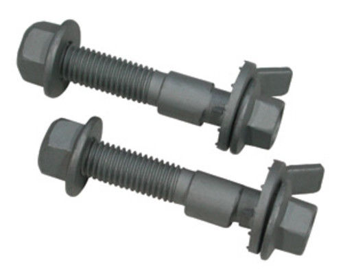

Xtra Posted July 27, 2017 Author Report Share Posted July 27, 2017 (edited) Bummer, Galpin Auto Sports will not install the brace. I need a longer bolt and not just any bolt, that bolt is a Alignment Cam Bolt. The bolt has a cam on it to adjust the rear camber. Although they could custom make me a new bolt, GAS believes that the liability is too high. So it is a no go on the brace. If I can have one made myself at a machine shop, perhaps they would then do the install. Ā Ā Edited July 27, 2017 by Xtra Quote Link to comment Share on other sites More sharing options...
