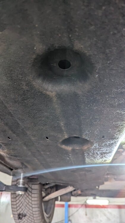

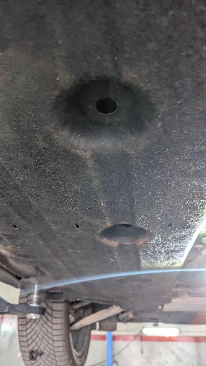

Double George Posted March 25, 2024 Report Share Posted March 25, 2024 I have same issue on my2020 edge, however there are no plastic clips on my covers. There are only the stamped metal nuts along the edges. How can I eliminate the rattling? I thought about pool noodles slid between panels and bottom of car. Would this work? Quote Link to comment Share on other sites More sharing options...
1004ron Posted March 26, 2024 Report Share Posted March 26, 2024 12 hours ago, Double George said: I have same issue on my2020 edge, however there are no plastic clips on my covers. There are only the stamped metal nuts along the edges. How can I eliminate the rattling? I thought about pool noodles slid between panels and bottom of car. Would this work? They're recessed so unless you get right below them you might not see them - also possible that Ford made a change with your Model/Year - maybe @Haz can confirm. Quote Link to comment Share on other sites More sharing options...

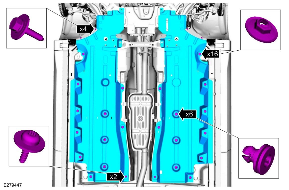

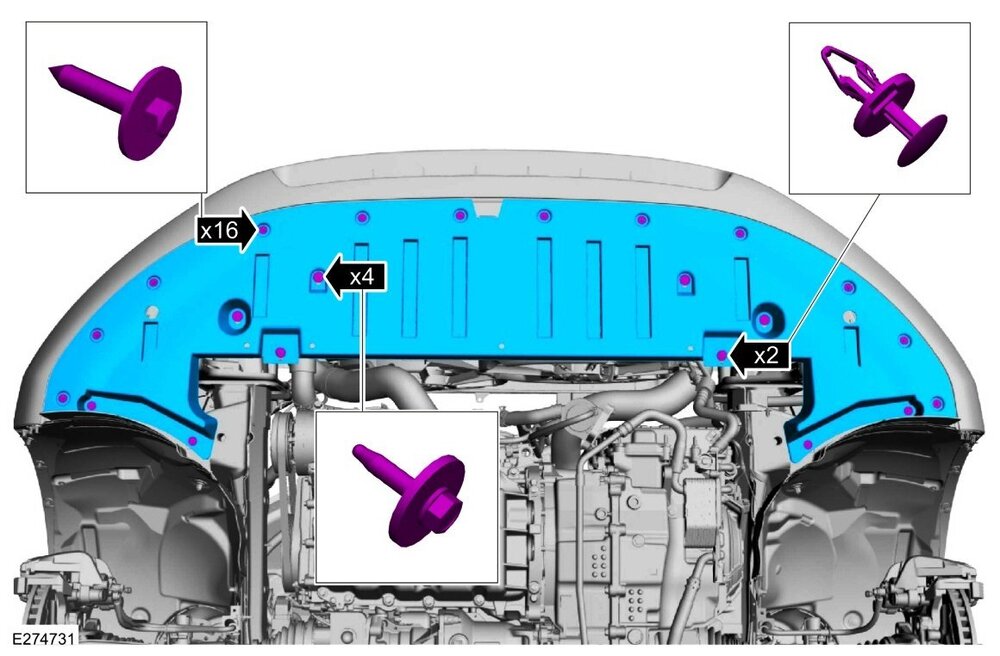

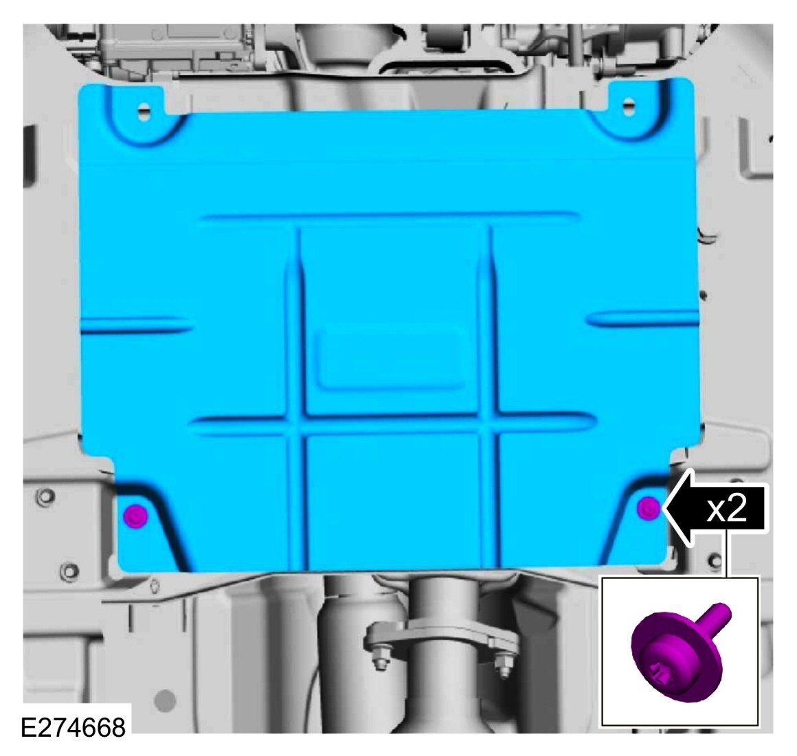

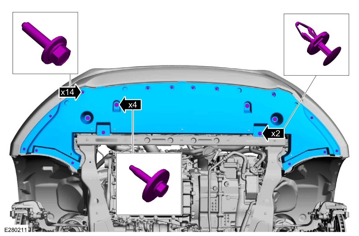

Haz Posted March 26, 2024 Report Share Posted March 26, 2024 (edited) The following Underbody Shield images from the 2020 Edge Workshop Manual depict retainer types, quantities, and locations... 2.0L EcoBoost 2.7L EcoBoost PDF versions of these images are attached below... Underbody Shield Image #1 - 2.0 EcoBoost - 2020 Edge Workshop Manual.pdf Underbody Shield Image #2 - 2.0 EcoBoost - 2020 Edge Workshop Manual.pdf Underbody Shield Image #3 - 2.0 EcoBoost - 2020 Edge Workshop Manual.pdf Underbody Shield Image #4 - 2.0 EcoBoost - 2020 Edge Workshop Manual.pdf Underbody Shield Image #1 - 2.7 EcoBoost - 2020 Edge Workshop Manual.pdf Underbody Shield Image #2 - 2.7 EcoBoost - 2020 Edge Workshop Manual.pdf Underbody Shield Image #3 - 2.7 EcoBoost - 2020 Edge Workshop Manual.pdf Good luck! Edited March 26, 2024 by Haz 1 Quote Link to comment Share on other sites More sharing options...
bhamraS97 Posted March 26, 2024 Report Share Posted March 26, 2024 (edited) 15 hours ago, Double George said: I have same issue on my2020 edge, however there are no plastic clips on my covers. There are only the stamped metal nuts along the edges. How can I eliminate the rattling? I thought about pool noodles slid between panels and bottom of car. Would this work? Hey, as from pictures from @Haz, my 2018 Ford Edge has similar layout as 2.7L model. All I did was, removing the loose middle clips on the side panels on both driver and passenger side and keep the good ones. And for the good ones I added double sided tape inbetween clips and frame to act as cushion and that worked for me. Driven 160 once and no rattle at all. Hope this helps Edited March 26, 2024 by bhamraS97 Quote Link to comment Share on other sites More sharing options...
