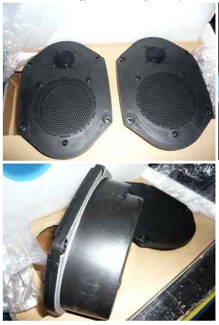

Lex Talionis Posted March 25, 2008 Report Share Posted March 25, 2008 I also know of a special mounting plate/bracket that can be placed over the stock speaker hole and components can be installed. That is the route I am taking for my front stage. you know... those adaptors might already be a part of the speakers you already have. look at these photos of the stock speakers I took out. There is what appears to be a plate that is attached to the front of the speakers by star nuts. I did not take it off, but thought it odd there was that piece as I was not sure why it was additionally there, but it looks alot like the link akirby gave and the item you mention. Quote Link to comment Share on other sites More sharing options...

Lex Talionis Posted March 25, 2008 Report Share Posted March 25, 2008 Had to use 6822cf in the rears as the Kappa's tweeter touches the inside door panel with no space. If they get hit the speaker will be damaged. for the record... this is absolutely, 100% not true. I have Infinity Kappa 682.7cf in both front and rear - as you know as you read the install report of mine with photos - and they are not even close to touching the grill/door panel. not even close. not sure where you got that information from? but there is a solid 1/2 inch from Tweeter to the door panel grill. Quote Link to comment Share on other sites More sharing options...
