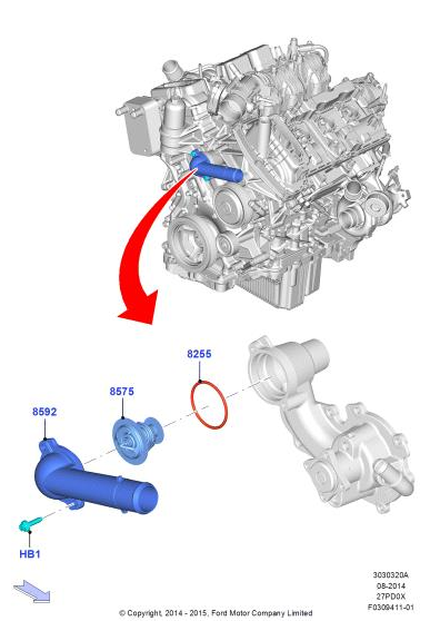

Mikula Posted April 28, 2018 Report Share Posted April 28, 2018 (edited) On 8/21/2017 at 8:38 PM, TheWizard said: Interestingly enough, this picture is incorrect. I just went to the dealer to buy a new o-ring. He initially printed me this exact same photo on the placement of the o-ring. Then I asked him for the torque specs of the 2 bolts. get this... when he brings up that info, the picture shows the o-ring on the outside. Asked twice to confirm we were looking at the 2.7L ecoboost for 2015+ ford edge on both photos, and we were. After installing the o-ring the way this photo shows, it is leaking. Evidently it is incorrect. To those taking on this job, please ignore the photo in post 43.. and wizard, maybe add an edit in there stating that as well. Also, the torque specs for the 2 bolts on the housing are 89in lbs (that is inch pounds in case you missed it) 89 inch lbs Edited April 28, 2018 by Mikula 2 Quote Link to comment Share on other sites More sharing options...
Mikula Posted April 28, 2018 Report Share Posted April 28, 2018 I'd like to edit or add my own "How To" in this thread, for those that do not want, or are having issues with removing the motor mount as suggested in post 46. Start by removing the plastic cover underneath the vehicle. There is more than one cover, so to be clear, do not remove the one attached to the front bumper. We are removing the cover that is covering the passenger side of the oil pan. The reason for doing this is so that when you remove the tstat, you have a place to catch the coolant with oil drain pans, or those throw away aluminum pans people cook turkeys in! a secondary option (and my preference) is to not remove the lower cover, but to buy some pig mat (amazon has some rolls for pretty cheap). This stuff is incredibly absorbent. I've been using it for years in a machine shop and I swear by the stuff. Take the pads and jam them underneath the area you will be working in. covering your pulleys, belts, and sensors when you can. next, remove the bolt on the coolant reservoir (it is on the back side). remove the plug on the rear of the reservoir (it is just a push pin style to keep it from bouncing around). Now the reservoir is held in place on the front passenger side corner near the bottom. lifting up on that corner will make it come free. Moving the reservoir out of that area (carefully of course) will allow you to get your arm in there and remove the thermostat the way DTMF suggests in post 47. However, there is no need to drain the radiator. I removed the bottom bolt from the thermostat housing first (because that one is a bit more difficult. Smaller hands will help you out here. I had to get the wife) You will begin to lose fluid here. keep pressure on the tstat housing whenever you can. You will not be able to use an extension or deep socket to get to the bolt. there is just enough room to use a regular "short" socket (8mm I believe) and back it out all of the way. Then move on to the top bolt on the housing. keeping pressure on the housing with one hand, while removing the bolt with the other hand, will minimize the amount of coolant lost. One thing to mention, have your new thermostat lying nearby. The quicker you do the swap, the less fluid you will lose. Also, make sure the "nipple" on the thermostat is facing up when you assemble it. Pull the housing back, remove the old tstat, and remove the o-ring gastket. It may still be attached to the t-stat, or it may be on the housing. put the new t-stat in place (again with the nipple facing upward, and the spring toward the motor). Then place the o-ring onto the thermostat, making sure it seats in there, then put the housing in place. Put your bolts back in and move back and forth when tightening to be sure it puts even pressure on both sides. Torque to 89 inch pounds. remove your rags if necessary, put your reservoir back in place, fill the reservoir between "min" and "max". leave the cap off at this time, and start the vehicle. If the fluid goes down, add to get into range again. Here is where I've heard differing opinions. Because the system is self burping, you can put the cap back on and let the vehicle idle until it gets to temperature. that obviously makes it difficult to add fluid if necessary, so i prefer to leave the cap off (or very loose) for the first 15-20 minutes, again adding fluid if necessary. I will also turn the heat on full blast after about 10 minutes of idle. Put the cap on the reservoir about the 20 minute mark. Total idle time was a half hour (which my vehicle automatically shut off at this point) let it cool, add fluid if necessary, check for leaks, replace the cover underneath if you removed it, and go for a test drive around the neighborhood. Make sure you get it up to temperature during this drive. Keep your eye on the gauge as it may fluctuate as air moves through the system. If it spikes to hot, just be sure it is a bubble, and not a failure of some kind. park it, and let it cool again. add fluid if necessary, and you should be good to go. Hope this helps someone! 6 Quote Link to comment Share on other sites More sharing options...

TheWizard Posted April 29, 2018 Report Share Posted April 29, 2018 On 4/28/2018 at 6:28 PM, Mikula said: To those taking on this job, please ignore the photo in post 43.. and wizard, maybe add an edit in there stating that as well. I added a note to the original post to see your post about the o-ring. 1 Quote Link to comment Share on other sites More sharing options...
