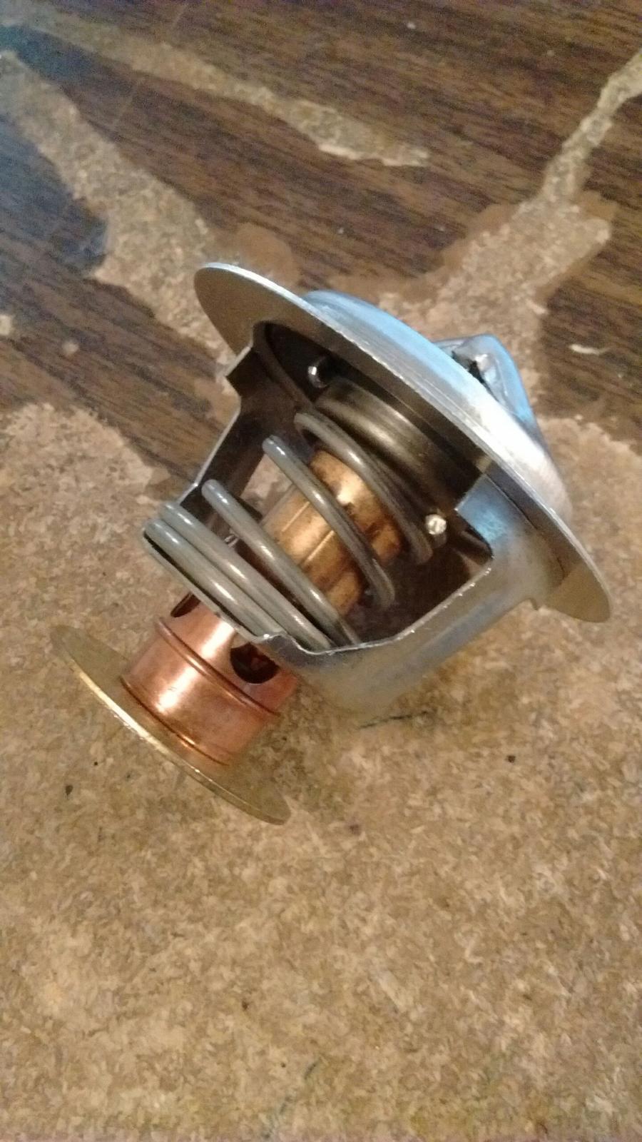

Xtra Posted June 14, 2017 Report Share Posted June 14, 2017 (edited) Just received a EvenFlo 160* Thermostat for my AWD G2 Edge Sport 2.7L EcoBoost with a LMS 91 Performance Tune. It is LMS recommended for my Tuned 2.7L EcoBoost. This is what they have to say about it: "Livernois Motorsports & Engineering now offers a line of EvenFlo low temperature thermostats for EcoBoost performance engines. Using our line of EvenFlo 160° low temperature thermostats, you can dramatically reduce the operating temperatures in your performance engine. This will allow for the engine to naturally make more power, ensure consistent performance, and increase coolant flow to help extend engine component longevity." As I live where it is very hot in the summer, often over 100+*, and I do use the car . I decide to invest in one and see what it will do .This part is for 2016-2017 Ford Edge Sport 2.7 Liter Turbocharged SKU LPP2359-160. Edited June 14, 2017 by Xtra 1 Quote Link to comment Share on other sites More sharing options...
always on edge Posted June 15, 2017 Report Share Posted June 15, 2017 I suppose I like the idea but isn't the stock thermostat 170º? Quote Link to comment Share on other sites More sharing options...
Xtra Posted June 15, 2017 Author Report Share Posted June 15, 2017 I suppose I like the idea but isn't the stock thermostat 170º? I don't know what the stock thermostat is in the G2 Edge Sport 2.7. I just know that 160* is less than stock and LMS recommends it. So I thought I would go for it. Quote Link to comment Share on other sites More sharing options...
Xtra Posted June 15, 2017 Author Report Share Posted June 15, 2017 (edited) I just got off the phone with Scott @ LMS and he told me the stock thermostat is set around 190* to 195*. He told me that the EvenFlo 160* thermostat will allow the engine to produce more consistent HP and help prevent Knock or Pre Detonation. He went on to explain that when things get hot the computer retards the ignition and that robs you of power. And that on a hot day the stock thermostat would let temperature rise to 200* up to 220* while the EvenFlo would hold the temp to around 170* to 180*. , and that lets the computer run more advance making more power. So in that way the EvenFlo 160 makes more power over a wider temp range. I was worried about cold weather and my heater working and Scott said that in Southern California where I live there should be no problem with the coldest days in the low 40s to mid thirties. In Michigan where he lives it gets below zero for weeks at a time so he replaces the EvenFlo that he uses in summer with the stock thermostat so he can keep warm in the winter. Edited June 15, 2017 by Xtra Quote Link to comment Share on other sites More sharing options...

macbwt Posted June 16, 2017 Report Share Posted June 16, 2017 A TStat is not going to make your engine run cooler. All it will do is open sooner. The engine will still reach operating temps and not prevent it from reaching those temps or keep it cooler. Only way is to add more volume and larger radiator to keep coolant temps down. Maybe on a short drive you will see some type of benefit. Any long drives it will mean nothing. 1 1 Quote Link to comment Share on other sites More sharing options...
TheWizard Posted June 16, 2017 Report Share Posted June 16, 2017 A lower temperature thermostat will actually keep the engine running somewhat cooler than the stock one. The thermostat opens and closes based on the coolant temperature. When closed, coolant circulates only within the engine for faster warmup. When the coolant reaches the thermostat temperature, it opens and diverts coolant through the radiator to remove heat. So, with a 160 degree thermostat, it will open and start sending coolant to the radiator at around 160 degrees. The coolant will then maintain a temperature somewhere close to 160-170 degrees assuming there are no cooling system problems or external factors such as extended idling or extreme ambient heat. With the factory thermostat, it won't start diverting coolant until it reaches 190 degrees and it would theoretically close again if the temperature dropped much below that point (not that the temperature of a running engine would actually do that) so it will maintain a temperature somewhere around 190-200 degrees. That means the lower thermostat does actually keep the overall coolant temperature lower than a factory one. 4 Quote Link to comment Share on other sites More sharing options...

Xtra Posted June 16, 2017 Author Report Share Posted June 16, 2017 (edited) Want to thank everyone for their thoughts on this . I have decided to go with a 170* Reische Performance Thermostat . Just ordered one and will be returning the EvenFlo 160*. I feel that 160* might be a bit low, my car is not a rece car and it needs to work under all conditions . I don't want to worry or swap it out if I go to the up to the snow in the winter to play . Edited June 16, 2017 by Xtra Quote Link to comment Share on other sites More sharing options...

Xtra Posted June 19, 2017 Author Report Share Posted June 19, 2017 (edited) Just received my Reische Performance 170F TStat . I did some research on the cold side Reische and the hot side EvenFlo thermostats. It appears that the Reische is the same cold side design as the stock thermostat . Armed with this info I will be going with the Reische unit. I clipped this from another site with Joel from Reische explaining the difference between cold and hot side thermostats. ============================================================================ HOT SIDE THERMOSTAT "So in the hot-side system the thermostat is placed pre-radiator: coolant flows in from the side (GREEN/RED) and, depending on it's temp, coolant is directed either up to the radiator to be chilled or if the coolant is not hot enough, the thermostat stays closed and the coolant is directed down through the bypass to recirculate. Of course the thermostat will often run partially open, directing a little coolant to both paths. COLD SIDE THERMOSTATIn the cold-side system coolant flows the opposite direction and the thermostat is post-radiator: Unlike a hot-side thermostat, the bypass control (brass bottom) is not attached to the upper assembly/diaphragm and does not move when the thermostat opens. It maintains contact so the bypass coolant can only flow up through the inside of the pipe, keeping the heat motor in direct contact with the bypass coolant temperature so the thermostat can function properly at all times. When the bypass coolant is hot enough the thermostat opens (bringing in chilled coolant from the radiator - BLUE); this also pushes the heat motor further down into the pipe which closes off the holes in the pipe for the bypass (RED) and shields it from the chilled coolant. However a small amount of bypass coolant is allowed to flow across the heat motor at all times so it can still monitor and respond to changes in the coolant temp.A hot-side thermostat can function in a cold-side setup to a large degree but there are some drawbacks: When the thermostat opens some of the chilled coolant will mix in and expose the heat motor to cooler temps then it should be seeing to operate properly. Cooler temps then force the thermostat to start closing prematurely and once this happens, the hot bypass coolant will then start to make it open back up... and the cycle repeats. Another issue is the thermostat will always struggle to stay fully open because as soon as the bypass is completely shut off, the heat motor will no longer be exposed to hot coolant, forcing it to close again. The LMS/Even Flo thermostat attempts to address this by placing 4 holes in the bypass valve but then you always have a good amount of coolant recirculating through the bypass instead of being directed through the radiator as it should be.In my own real world testing with a hot-side thermostat in a cold-side application I found the primary drawback was the way it handled changing conditions. You could see a nice stable temp cruising down the freeway but as soon as you exited and started slowing down to a stop the temp would immediately spike up and it took a little time for it to re-stabilize and cool back down." ========================================================= I never dreamed that thermostats could so technical. Edited June 19, 2017 by Xtra 3 Quote Link to comment Share on other sites More sharing options...
