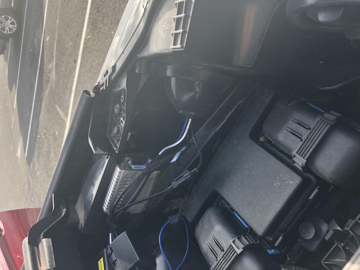

blockisle9 Posted January 24, 2018 Report Share Posted January 24, 2018 Photos of my HID Install. Quote Link to comment Share on other sites More sharing options...
blockisle9 Posted January 24, 2018 Report Share Posted January 24, 2018 Photos of my HID Install. 1 Quote Link to comment Share on other sites More sharing options...
