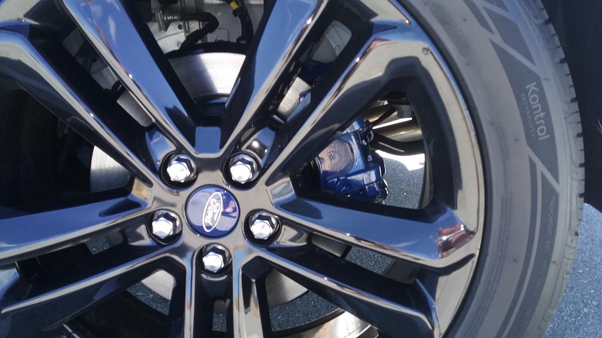

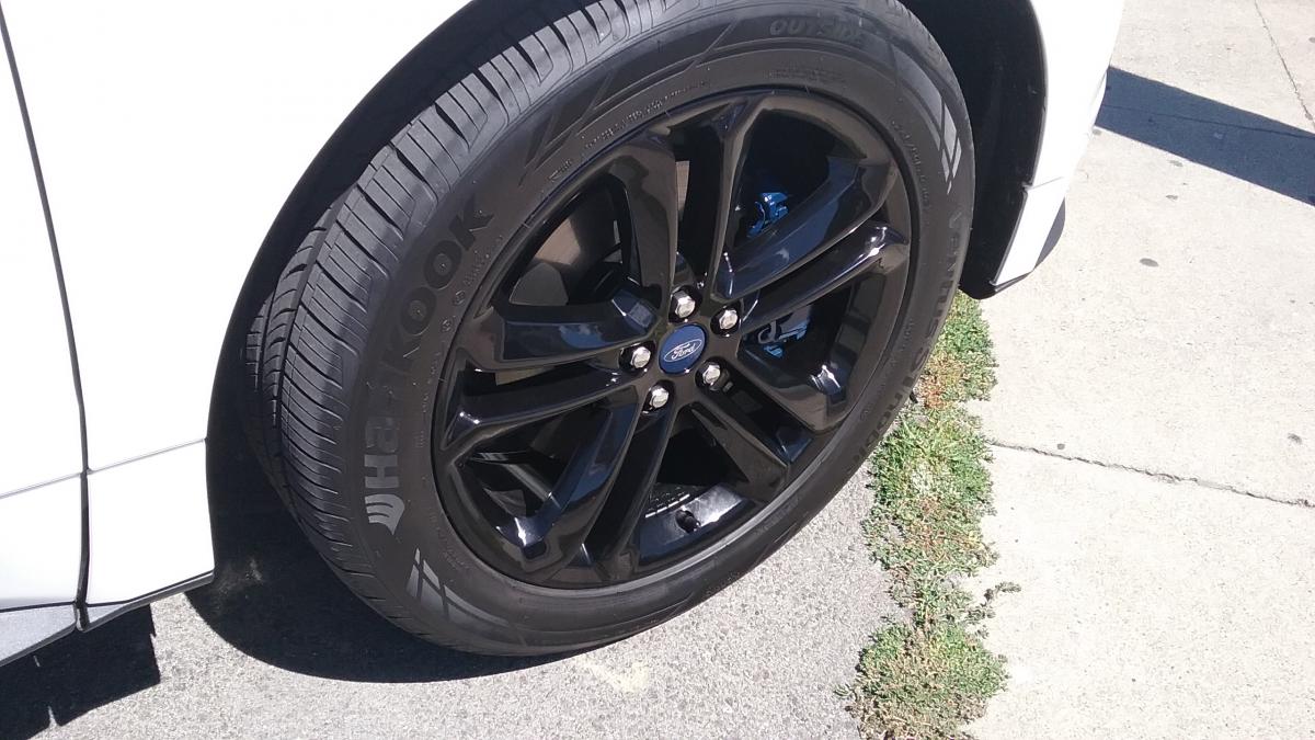

Sport17 Posted June 12, 2017 Report Share Posted June 12, 2017 (edited) So, I just got my OEM 20" wheels painted black (stock was a polished finish). This is a 2017 Edge. I'd like to replace the chrome/whatever lugs with gloss black lugs to match the wheels (not a big fan of the cop car look). I'm having a really hard time finding an exact replacement - all the lugs seem to be the locking (key required) type or have a different drive size (22mm). From what I can tell, the stock is a 19mm drive [Edit - it is NOT 19mm, it is 21mm], m14x1.5 (although I haven't verified that). Does anyone know the full and exact measurement (including drive size). I am certain that they are m14x1.5 but I'm not certain that they are 19mm. I guess it isn't that big of a deal but I'd just rather keep them matching the OEM lug wrench, if possible. Attached some pics - sorry they're not the greatest. Wheels hadn't been cleaned and (as I found out), shooting a bright white vehicle with black wheels in the California sun is challenging. If you're on the sun-side, the wheels don't look black and if you're on the other side, you can barely see them. Ha. Anyway, you can a general sense of her new look. Decided to experiment with the calipers - had them painted to match the wheel center cap. I like it - it's very subtle, unless you're looking for it. Edit: These seem like they would fit but according to Amazon, they won't.. They are m14x1.5, 19mm hex drive so I don't see why they wouldn't. These also have a 60° seat - any idea what the stock is? https://www.amazon.com/DPAccessories-D3148P-2308-20-14x1-5-Aftermarket/dp/B00JJ66XCA/ref=pd_sbs_263_1?_encoding=UTF8&pd_rd_i=B00JJ66XCA&pd_rd_r=A1RH032WSHRZETKYDRCH&pd_rd_w=jhyEY&pd_rd_wg=lSRka&psc=1&refRID=A1RH032WSHRZETKYDRCH Edit 2/Update: I did verify that the drive is 21mm. So the only thing left to verify is the seat angle of 60°. Edit Edit: See my update below... Edited June 16, 2017 by Sport17 1 Quote Link to comment Share on other sites More sharing options...
Sport17 Posted June 12, 2017 Author Report Share Posted June 12, 2017 One more pic: Quote Link to comment Share on other sites More sharing options...

Sport17 Posted June 13, 2017 Author Report Share Posted June 13, 2017 (edited) Ok, I found some. I phoned Gorilla to find an exact OEM match. Apparently it's important to do so - the CSR explained that they did indeed have a Ford OEM version for the Edge. He explained the technical difference to me but he was pretty quick about it. There were two primary differences - the one I remember is that we need to use the "bulge" version.. I can't remember the other diff. Anyway, the part number is 61147BCX for the black lugs. I just ordered some from Summit Racing for $15/pack of 4. Will update once I receive them and have them installed (to verify fitment). Edit: I should also note - that part number (61147BCX is for the 20" wheels on the 2017 model year). Now, I imagine it fits other wheels (maybe even all of them) but I cannot verify that. I would recommend always verifying with the manufacturer for fitment before ordering! Edited June 13, 2017 by Sport17 1 Quote Link to comment Share on other sites More sharing options...

roots57 Posted January 3, 2018 Report Share Posted January 3, 2018 Ok, I found some. I phoned Gorilla to find an exact OEM match. Apparently it's important to do so - the CSR explained that they did indeed have a Ford OEM version for the Edge. He explained the technical difference to me but he was pretty quick about it. There were two primary differences - the one I remember is that we need to use the "bulge" version.. I can't remember the other diff. Anyway, the part number is 61147BCX for the black lugs. I just ordered some from Summit Racing for $15/pack of 4. Will update once I receive them and have them installed (to verify fitment). Edit: I should also note - that part number (61147BCX is for the 20" wheels on the 2017 model year). Now, I imagine it fits other wheels (maybe even all of them) but I cannot verify that. I would recommend always verifying with the manufacturer for fitment before ordering! The "bulge" version of the Gorilla Acorns is what I should have bought. The ones I did buy last year are the correct 14 x 1.5 thread and 60 deg angle, but they are not flared. They still work, but the bulged conical area matches the factory lugs shape. At some point I need to replace them. Damn things are like $75 per set of 20 though! BTW the Gorilla part number for the black Acorn style locking lugs for the Gen II Edge is 96643BDX, the ones I currently have on that are not flared are 71643NBC. 3 Quote Link to comment Share on other sites More sharing options...
