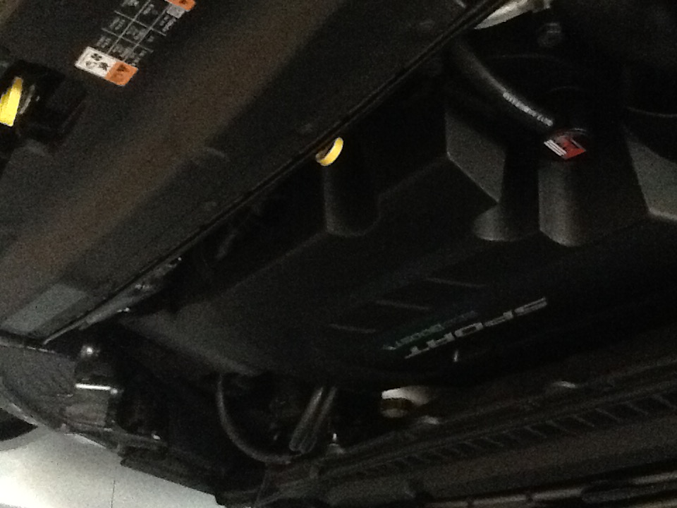

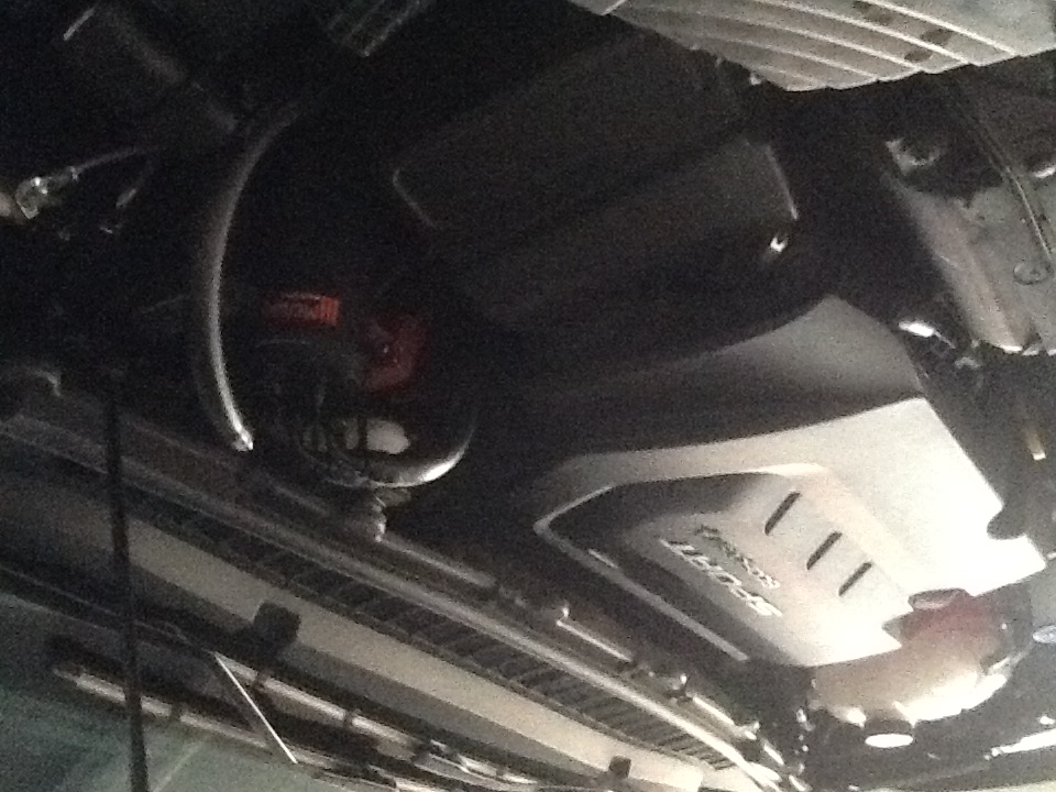

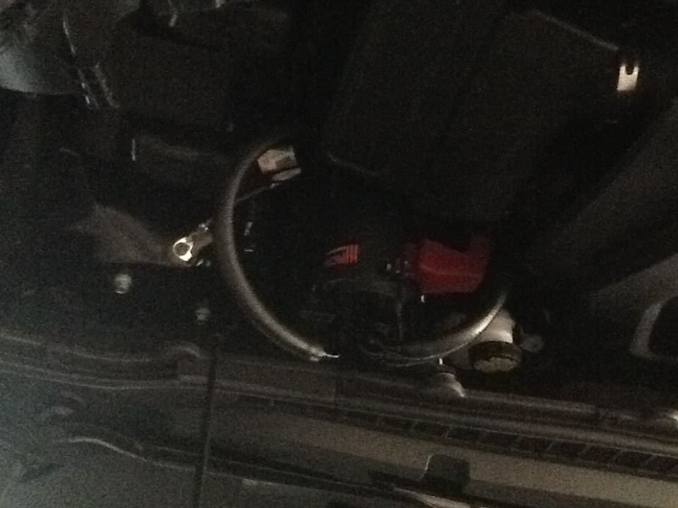

ezndo Posted May 31, 2017 Report Share Posted May 31, 2017 Sorry for the crappy pics, will take better shots when I replace some of the clamps with shrink wrap. This is the generic kit from RX Speed Works. Tommy Thomsen answered all of my many questions concerning the install, given the provided instructions were not Edge specific. It took me a while to route the hoses under the engine cover as I wanted a clean install. I think I mounted the can in the only available vertical real estate, hope it works out OK. 3 Quote Link to comment Share on other sites More sharing options...
