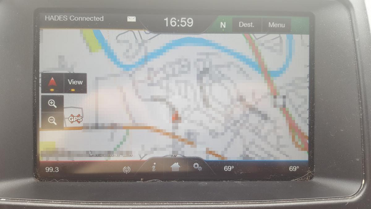

Navigation Issue: I don't know exactly when the navigation issue started, but it seemed to happen after my battery stopped dying on me. My GPS position is fixed at the location where my GPS last worked (my apartment). My compass direction does not change when driving.
On the navigation screen below, you can see that I am not receiving a signal.

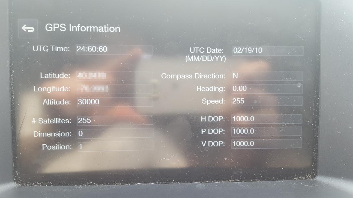

I also entered the diagnostic menu via Eject + Seek Forward combination and the results are below incase the picture can't be opened.
GPS Diagnostic Information Screen
UTC Time: 24:60:60 UTC Date: 02/19/10
Latitude: XXX.XXXX (Fixated on last acquired) Compass Direction: N (incorrect, vehicle is facing West)
Longitude: XX.XXXX (Fixated on last acquired) Heading: 0.00
Altitude: 30000 (obviously wrong) Speed: 255 (obviously wrong)
# Satellites: 255 H DOP: 1000.0
Dimension: 0 P DOP: 1000.0
Position: 1 V DOP: 1000.0
