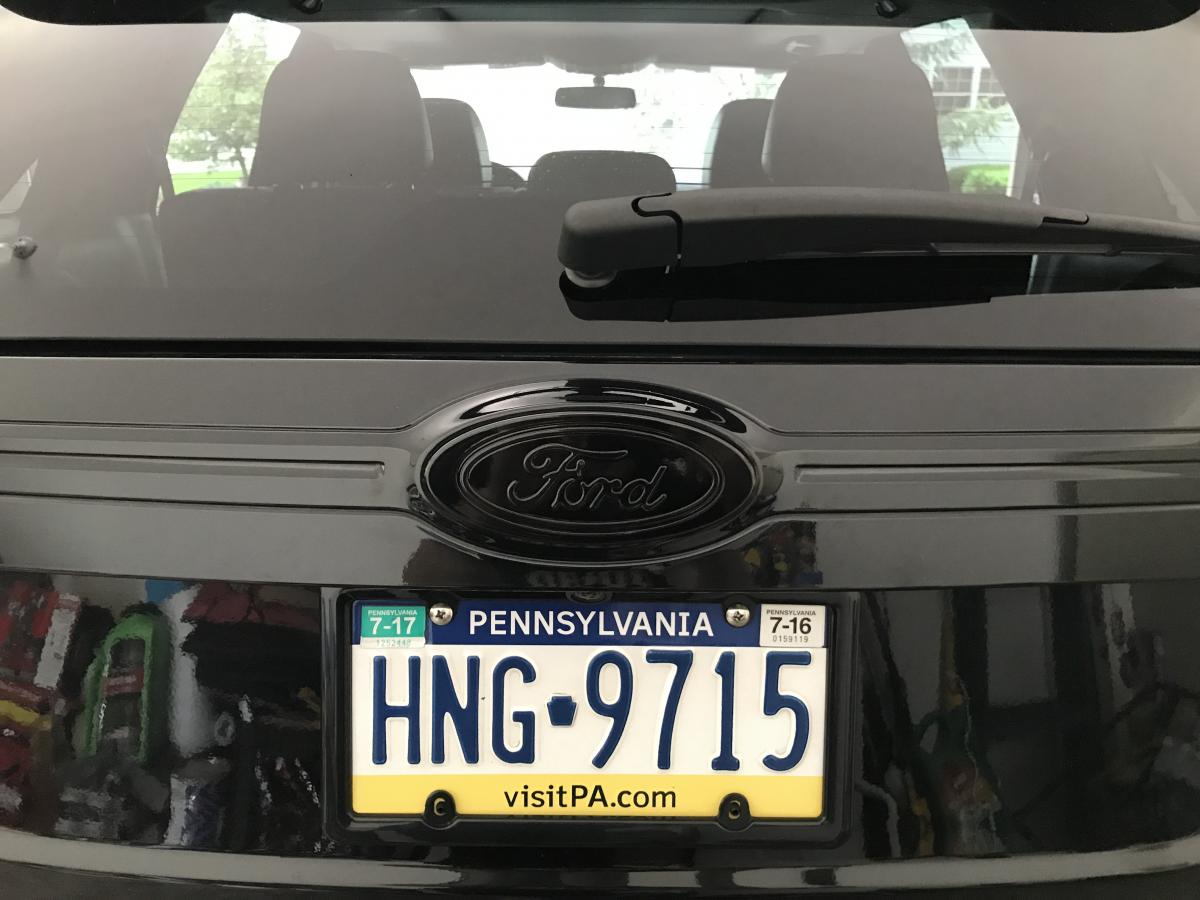

Also, I removed the rear badge today and put the new badge on...looks amazing. I'll post before and after pics. All I did was heat it with a hairdryer for about 5/10 minutes then, wrapped a butter knife with a towel to pry it off. Be careful not to scratch your paint. I don't know how it works with the 17, but mine also had little pins on the back to make sure that the badge was lined up, so watch out for that, they weren't clips though just pins. The replacement badge, however, didn't have the pins, only sticky tape.
