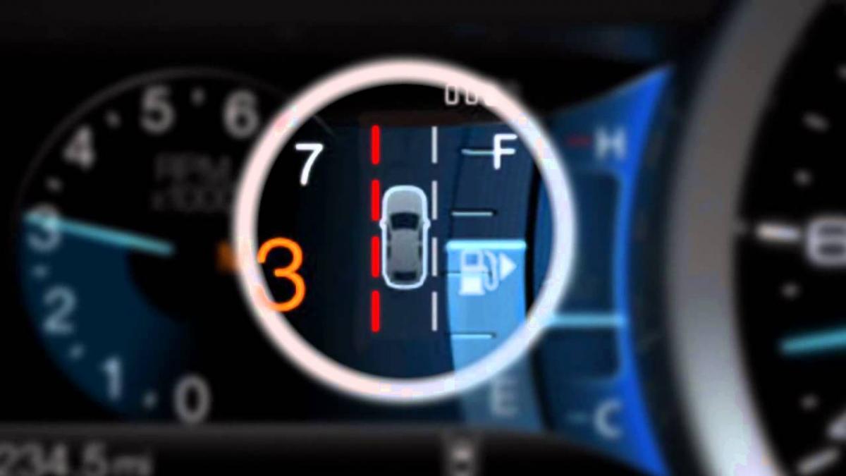

Sounds like you have the lane-control feature turned on... On the end/tip of your turn signal lever, check to see if there is a button. Then look at the left dash indicator - you will see a pair of little lane markers appear or disappear. I'm 99% positive this is what you're experiencing.
I encountered the very same problem in the first day or two of owning mine.. What you're describing is exactly how it feels. Note - the lane keeping system works by detecting the lines to the left and right of your vehicle.. If you use your turn signal it will not engage because the vehicle knows that the lane change is intentional (unless of course you use your right signal and change to the left lane).
Give it a test!
Edit: I should also mention that you can adjust this in the vehicle setup screens. You can make it so it gives you an alarm or the physical wheel adjustment (what you're feeling). Also, you can adjust the "strength" of the adjustment it gives you..

Being a new car I'm 99.9999999% certain it's the lane-keeping system. Like I mentioned, I felt the exact same sensation before realizing I had enabled the LKS. It's just doing what it's supposed to. Still, I agree - I'd like to hear back to make sure that's all it was. I've noticed a few posters commenting on problems with brand-new vehicles and it's a bit unnerving.
I didn't even think of that, but yes, make sure its not just the lane keeping assist kicking in. I cant stand it, if you try to switch lanes without signalling while its active, it fights back and if you aren't ready for it, could cause an accident.
I believe that the Lane Keep System has two levels of support. You can adjust the system in the settings function of the left hand display to either vibrate the steering wheel or actually torque the wheel in an effort to maintain the lane.
