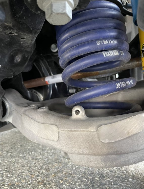

Xtra Posted June 13, 2017 Author Report Share Posted June 13, 2017 Just for clarity, this is with the lowering springs? Yes with the H&R Sport Springs, Part # 28759-2 installed. Quote Link to comment Share on other sites More sharing options...

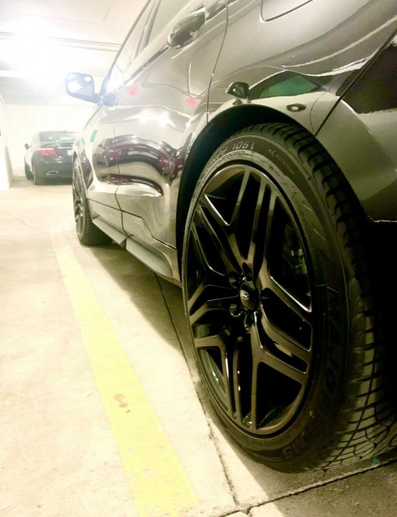

Xtra Posted June 14, 2017 Author Report Share Posted June 14, 2017 In other words, say if a turbo goes out, they cant say "you altered the suspension so your warranty coverage of the turbos is void" right? That is the way I understand it. I have been in contact with Galpin Auto Sports about all my mods and that is exactly what they say. If the failure is not related to the mod then the Warranty is fine. I love my springs they are not extreme, just enough. The stance is right on, the ride is not harsh and it handles like a Go Kart. Whats not to like ?? Quote Link to comment Share on other sites More sharing options...

Xtra Posted June 15, 2017 Author Report Share Posted June 15, 2017 I guess any suspension shop in my area could do it for a couple hundred in labor? Any suspension shop can do it . The front struts are easy it is the rear that can be tough . Be sure to tell whomever you use to drop the rear subframe to install the rear springs. That is very important it is an easy job when you do that. If they don't drop the subframe it is a nightmare . Have the car aligned after you drop it . Some people wait a few hundred miles for the springs to set before they align. I had mine aligned at the same time the springs were installed to protect the tires. I have a few hundred miles on them now and I am having the alignment redone at Galpin Auto Sports when they install my 160* thermostat. I paid $400 for install and got them to toss in the alignment for that price. Quote Link to comment Share on other sites More sharing options...
