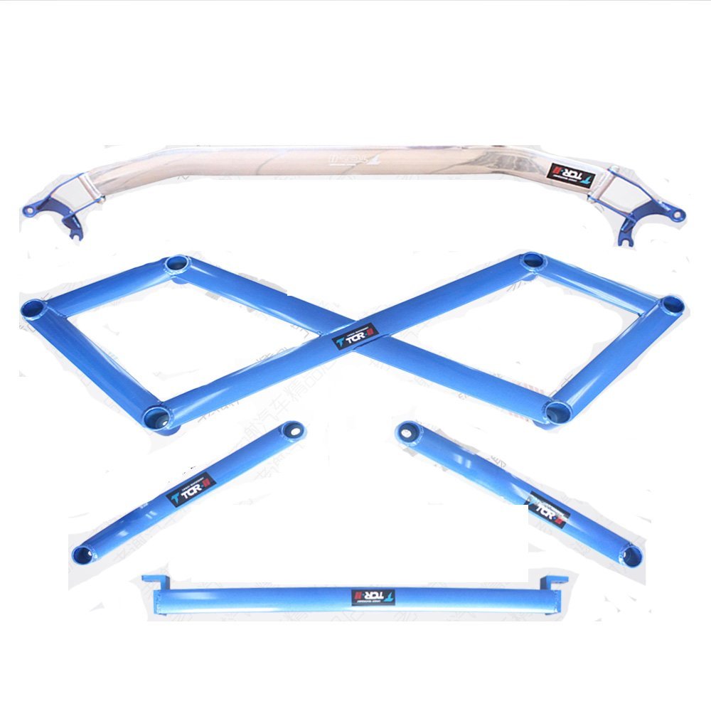

Nick Halstead Posted May 30, 2017 Report Share Posted May 30, 2017 (edited) there's one other option that nobody has tried yet. maybe you can be the test mule. since you aren't lowered it will be a good test. Ā seller is legit as he's also a member of FEWW, just don't pay attention to model years listed, they go by build dateshttp://www.ebay.com/itm/2014-2016-Ford-Edge-Lincoln-MKX-2nd-SUV-Strut-Tower-Chassis-Bar-Brace-Ladder-Set-/122084222697 Edited May 30, 2017 by Nick Halstead 2 Quote Link to comment Share on other sites More sharing options...
aloyouis Posted May 31, 2017 Report Share Posted May 31, 2017 So what will this do? Just tighten up the front suspension and add fram stiffness? Quote Link to comment Share on other sites More sharing options...
Nick Halstead Posted May 31, 2017 Report Share Posted May 31, 2017 (edited) So what will this do? Just tighten up the front suspension and add fram stiffness? yes, in theory, but nobody stateside has tested it Edited May 31, 2017 by Nick Halstead Quote Link to comment Share on other sites More sharing options...
aloyouis Posted May 31, 2017 Report Share Posted May 31, 2017 Interestingly, I can't find any product descriptions or performance claims on it anywhere. They simply don't tell you what their product is supposed to do. Quote Link to comment Share on other sites More sharing options...
Xtra Posted May 31, 2017 Author Report Share Posted May 31, 2017 (edited) This is a performance kit designed to stiffen the body /chassis of the car and make it handle better. The car will still look stock and ride at the stock height but will handle better. The front strut tower bar, also known as a strut brace or strut tower brace, is a pretty common upgrade on many cars and many cars come with one from the factory. ... Strut bars are designed to tie the tops of your struts together, to reduce chassis flex which improves handling, acceleration and braking. The rear lower bar looks like a type of sway bar for the rear end. When it comes to sway bars (also known as anti-roll bars, stabilizer bars), the common misconception is that their sole purpose is to keep the body of the vehicle from rolling to one side during a tight turn. While that is true, sway bars do more for your carās handling than you might think.When a vehicle has excessive body roll, the majority of its weight is shifted to the outer tires during a turn, causing less weight to sit on the inner tires. Lateral grip is something you donāt want to sacrifice. A sway barās purpose is to keep suspension movements relative throughout turns. This means that when the vehicle makes a right turn, the left side of the vehicleās suspension will compress similarly to the right side, keeping more weight on the inner tires. The Lower Right and Left Arms look to stiffen the body at a week point and the Front Lower Ladder Bar stiffens up the front of the car. It looks like a good complete kit. It should make your car handle better without changing the springs, or ride height. This might be a good idea as a next step for me as my car has the Panoramic roof and cutting a big hole in the roof can definitely affect stiffness. I wonder if Ford braces the Panoramic roof cars like they do some convertibles ? Edited May 31, 2017 by Xtra Quote Link to comment Share on other sites More sharing options...

Xtra Posted June 2, 2017 Author Report Share Posted June 2, 2017 (edited) there's one other option that nobody has tried yet. maybe you can be the test mule. since you aren't lowered it will be a good test. Ā seller is legit as he's also a member of FEWW, just don't pay attention to model years listed, they go by build dates Ā http://www.ebay.com/itm/2014-2016-Ford-Edge-Lincoln-MKX-2nd-SUV-Strut-Tower-Chassis-Bar-Brace-Ladder-Set-/122084222697 Ā Ā Just bought this on Amazon for $113 less than what Ebay sells it for. Thanks for the heads up on this product. We will see how it fits. Ā Ā https://www.amazon.com/FULL-KITS-STRUT-BRACE-2015-2016/dp/B01NBIAXU5/ref=sr_1_fkmr2_4?s=automotive&ie=UTF8&qid=1496363017&vehicle=2016-54-5858-------------0&sr=1-4-fkmr2&ymm=2016%3Aford%3Aedge&keywords=2016+Ford+Edge++Strut+Tower++Brace Edited June 2, 2017 by Xtra 2 Quote Link to comment Share on other sites More sharing options...
Nick Halstead Posted June 2, 2017 Report Share Posted June 2, 2017 Ā Just bought this on Amazon for $113 less than what Ebay sells it for. Thanks for the heads up on this product. We will see how it fits. Ā 2016 EDGE KIT.jpg Ā https://www.amazon.com/FULL-KITS-STRUT-BRACE-2015-2016/dp/B01NBIAXU5/ref=sr_1_fkmr2_4?s=automotive&ie=UTF8&qid=1496363017&vehicle=2016-54-5858-------------0&sr=1-4-fkmr2&ymm=2016%3Aford%3Aedge&keywords=2016+Ford+Edge++Strut+Tower++Brace I've known the guy for about 2 years now it seems, just never got around to ordering. We still chat quite often Quote Link to comment Share on other sites More sharing options...
Xtra Posted June 12, 2017 Author Report Share Posted June 12, 2017 (edited) The car handles so good now that the seats don't give enough lateral support ! ! LOL Edited June 12, 2017 by Xtra 1 Quote Link to comment Share on other sites More sharing options...
always on edge Posted June 12, 2017 Report Share Posted June 12, 2017 The car handles so good now I have a new problem. The seats don't give enough lateral support ! ! LOL +1 Ā I can (and do) take freeway on-ramps at nearly the same speed as my FZ-09. It's amazing. 1 Quote Link to comment Share on other sites More sharing options...
Xtra Posted June 12, 2017 Author Report Share Posted June 12, 2017 (edited) +1 Ā I can (and do) take freeway on-ramps at nearly the same speed as my FZ-09. It's amazing. You bet, it is amazing for a crossover, I have yet to find the limits as I have not had it on a track .. yet! . The car has stopped pushing into corners ..understeer has been reduced. Edited June 12, 2017 by Xtra Quote Link to comment Share on other sites More sharing options...
Nick Halstead Posted June 12, 2017 Report Share Posted June 12, 2017 You bet, it is amazing for a crossover, I have yet to find the limits as I have not had it on a track .. yet! . The car has stopped pushing into corners ..understeer has been reduced. with the chassis bracing? or still waiting on delivery? Quote Link to comment Share on other sites More sharing options...
