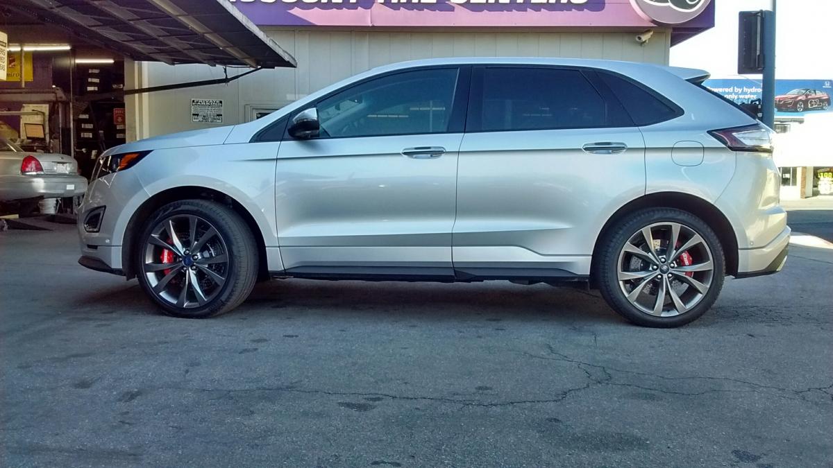

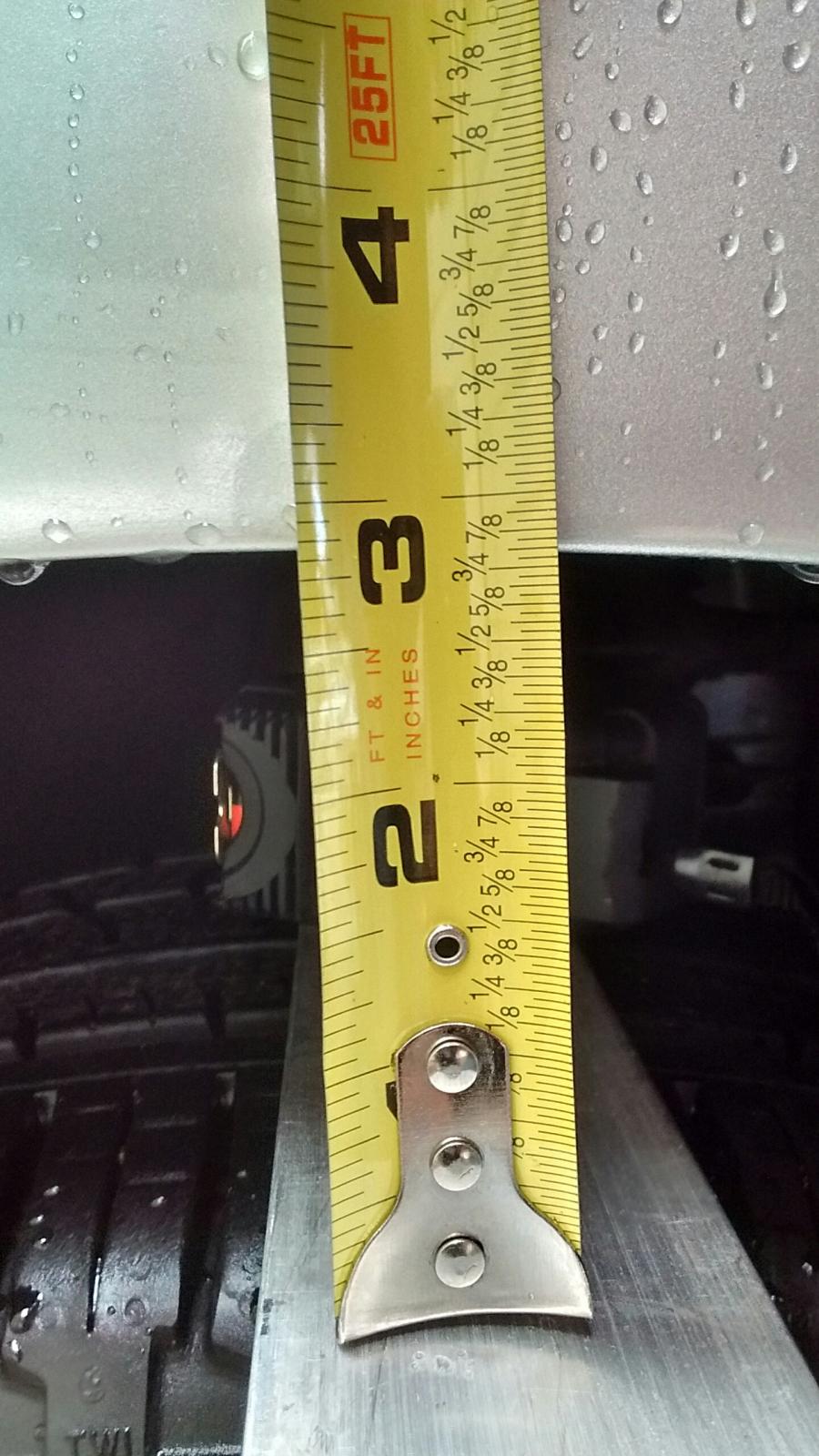

Xtra Posted May 20, 2017 Author Report Share Posted May 20, 2017 (edited) To set a base line I took some photos and measurements of the car while it is still stock. I measured the tire to wheel well opening. Stock clearance in front is 2 and 7/8 inch and the stock clearance in the rear is 3 and 3/4 inch. I did not use a micrometer to be exact, so I have included photos for your viewing pleasure. Edited July 7, 2017 by Xtra 1 Quote Link to comment Share on other sites More sharing options...

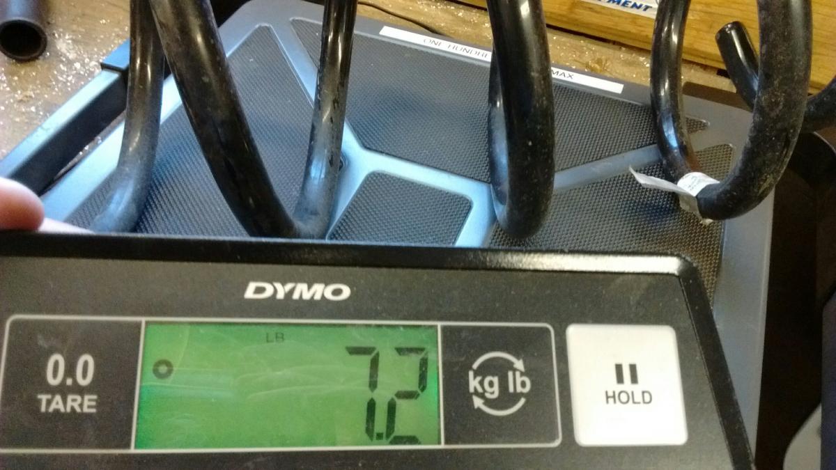

Xtra Posted May 21, 2017 Author Report Share Posted May 21, 2017 It is done and here are the stock springs and their weight. Quote Link to comment Share on other sites More sharing options...

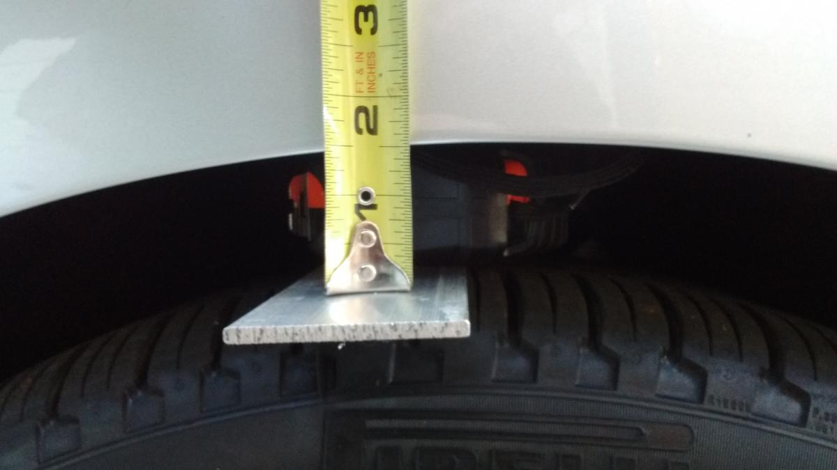

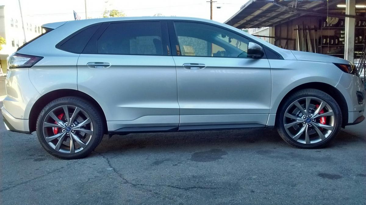

Xtra Posted May 21, 2017 Author Report Share Posted May 21, 2017 Now I will show you the H&R clearance so you can see the difference . Again these measurements are with a tape measure so it is not super accurate The front clearance is 1 and 1/2 inch that is a drop of around 1 and 3/8 inch. The rear clearance is 1 and 3/4 inch and that is a drop of around 2 inches. This is a bit lower than advertised, but not so low to cause any interference or look slammed to the ground. I think it is spot on. 1 Quote Link to comment Share on other sites More sharing options...

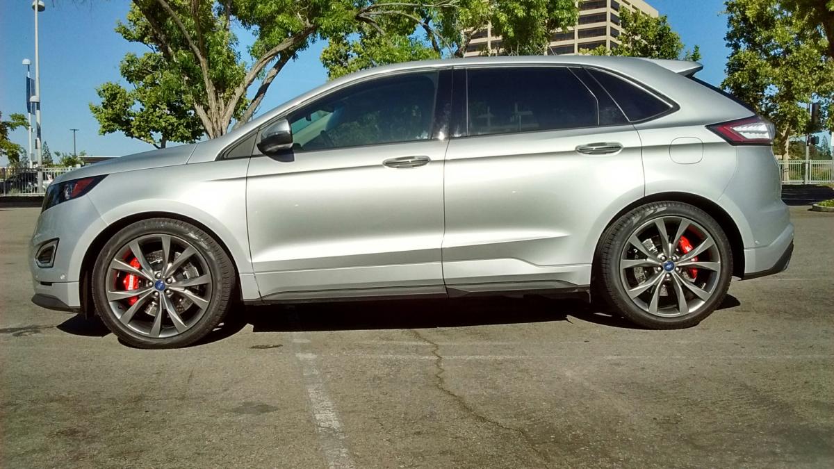

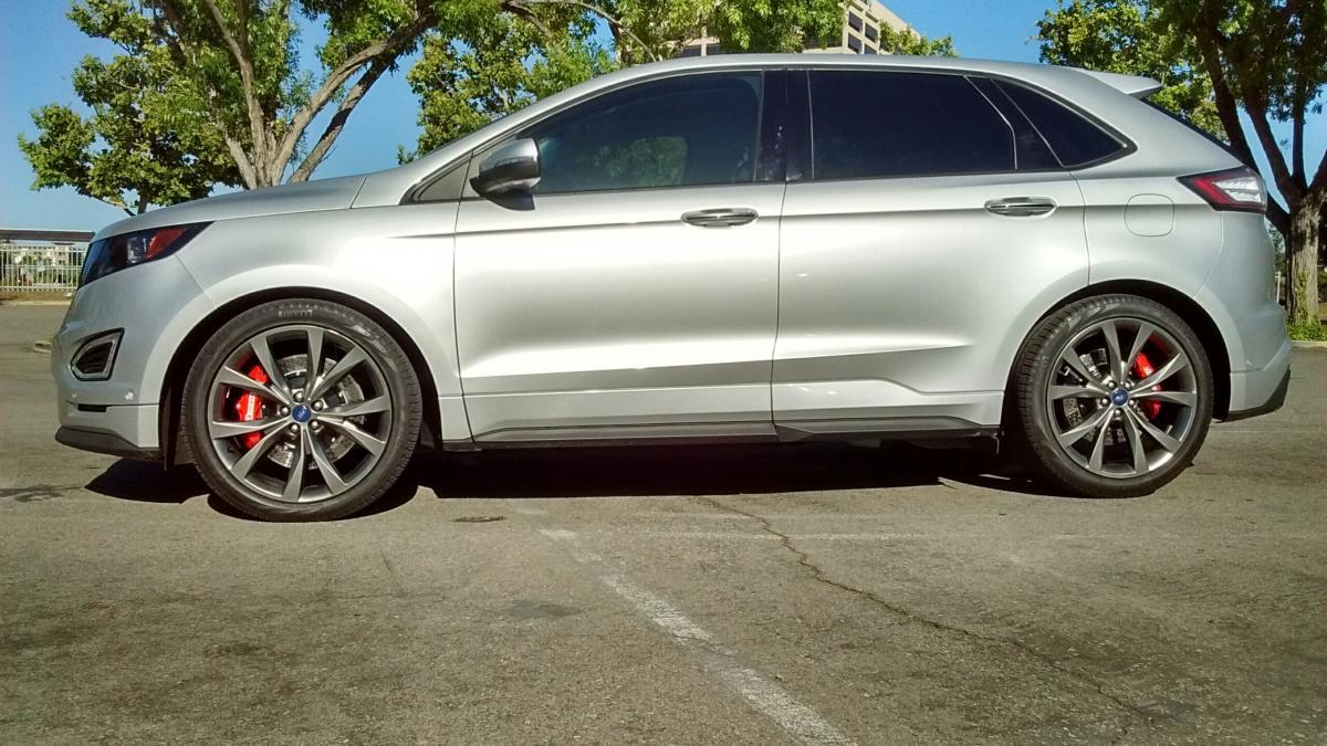

Xtra Posted May 21, 2017 Author Report Share Posted May 21, 2017 (edited) And now for the money shot, the before and after. I was pleasantly surprised to find the ride a tiny bit softer than stock, so my fears of a harsh ride were unwarranted . I have not had much time with the new modification, so I will let you know how it handles one of my canyon runs soon. The cost to install and re-align was $400. The front install was easy, and the rears were a bit harder. I am sure that was not the best price ever, but it was not a rip off. So far I love the new look, ride quality and stance. H&R nailed it ! Edited May 21, 2017 by Xtra 3 Quote Link to comment Share on other sites More sharing options...

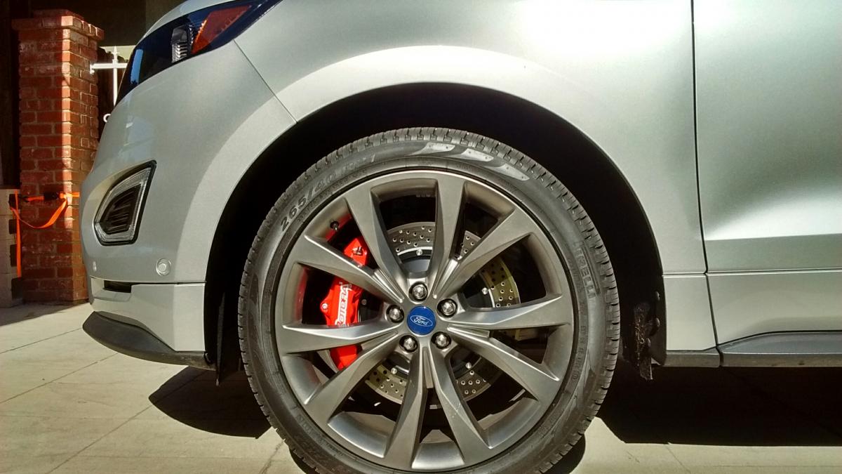

Xtra Posted May 22, 2017 Author Report Share Posted May 22, 2017 Just finished a canyon run to the beach and back. Wow what a difference the car handles so much better. The progressive H&R springs work great. The linear stock springs would compress in a corner then rebound upsetting the car, now the car settles in and holds the line much better there is less squat. The ride is firmer for sure but still feels equal to or just a tiny bit softer when just putting around on good roads. It is that progressive thing at work that gives the best of both worlds. Here is a photo of how the front splitter will still clear a parking lot stop bumper. No worries that it will hit or be too low. 2 Quote Link to comment Share on other sites More sharing options...
