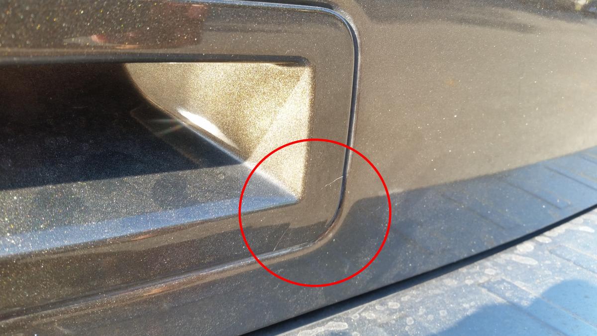

ramon_linux Posted May 14, 2017 Report Share Posted May 14, 2017 Hi all, The trunk handle cover of my wife's Ford Edge is cracked and I want to know where (online shopping) I can get a replacement. Thanks, PS. Sorry for my English Quote Link to comment Share on other sites More sharing options...

Liptoss Posted September 26, 2017 Report Share Posted September 26, 2017 My 2013 SEL hasn't cracked on the exterior flange like yours. Rather, mine cleanly snapped at one of the 2 brass threaded fittings mould into the back of the plastic handle. A coworker with a 2012 SEL cracked worse than yours, again on the same side, bottom corner. In both of our cases, abrasion rust had started below the handle flange. You'd be best to not just cover over the handle with a suggested $10 eBay cap, but remove and address the possibility of rust. I'm leaning towards an assembly line issue of possible over torque of the 2 bolts retaining the plastic handle from inside. Secret! You're not bolting down a control arm or wheel nut guys! Over time with vibration and the leverage action as the gate is opened and closed, along with weather and other elements of driving (road grime and slush/salt) we see the issues a couple of years later. So what to do? Well in my case, my challenge is different than yourself and my coworker. My mounting point behind was a clean snap. I simply removed the interior gate plastics and unbolted the handle and disconnected the electric button harness. I then cleaned the parts thoroughly and used 2 part epoxy glue to put it back as original. It's only been a couple of days now, but it's holding. I cross my fingers, but if it releases again, I'll fibreglass patch it and that'll do it I'm certain. The thin foam self adhesive gasket applied between the plastic and the painted metal creeps and failed eventually as well. Mine had slid down and creeped and wasn't even acting as a barrier and support for the plastic against the door skin. I believe the stability of the plastic handle actually depends on the successful application of this gasket. I rebuilt myself a new gasket with some rubbery electrical tape. It was approximately the same thickness as the gasket I removed. I didn't use the cheaper black vinyl tape since I wanted the tackiness of the rubber tape to assist in the adhesion of the handle to the painted metal. Final assembly be careful not to over-torque the 2 mounting bolts. Why did I choose to repair this myself, rather than approach Ford for my extended warranty repair. Well, recently I was into a dealer for another warranty repair and didn't have a regarded "nice" experience. So frankly, unless it's a major issue like a transmission or engine or other expensive electronics, Ford can stuff it. Why did I not go and buy a new part which is readily available? Again, Ford can stuff it for $200 CDN plus tax. So folks quote me... "The more you see, the more you have ah-ha moments and learn about this friggin' Edge". 2 Quote Link to comment Share on other sites More sharing options...
