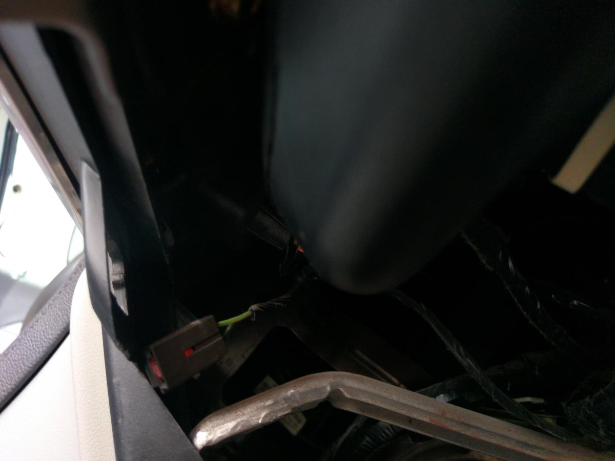

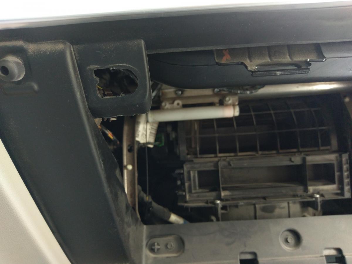

OK, well, I've id'd the switch I need with the part # but can anyone tell me WHERE the thing is mounted? I'm assuming on the upper lip of the enclosure (not the door) somewhere. Left side, right side? Having a tough time figuring out the location. Thanks again for any feedback.
Reboot, Pretty Please: Would any MKX owner be so kind as to inform me where exactly the glove box light is mounted? I have googlesearched, utoobed it, and checked other forums all to no avail.
Again, thanks for any feedback.
If there are still no responses, I understand and will quietly sulk off feeling empty and abandon, never to ask again. <sigh>
Omar, thanks VERY much for the pix!! I have the connector on order and I am going to run by my local ford dealer to check on the light/switch. My Edge does not have the extra plastic tab on the left side of the glove box where the switch mounts, but I'm sure I can Texas engineer something. Thanks again for the pix!
