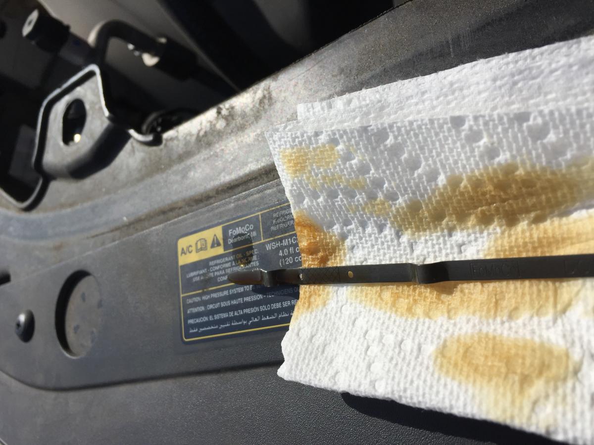

Mirage52 Posted April 16, 2017 Author Report Share Posted April 16, 2017 I did add a little oil to filter before installing it but it was very little. Just check again and took a pic I will try to post it. Looks like a 1/4 inch above fill mark. Quote Link to comment Share on other sites More sharing options...
Mirage52 Posted April 16, 2017 Author Report Share Posted April 16, 2017 Here's a pic of dipstick. Can be hard to see oil level but it's just above second hole. Thoughts? Quote Link to comment Share on other sites More sharing options...
WWWPerfA_ZN0W Posted April 16, 2017 Report Share Posted April 16, 2017 Ideally it should not be above second hole, but rather within the hashmarks. If you can drain out a little oil, that would be the best thing to do. 1 Quote Link to comment Share on other sites More sharing options...
Mirage52 Posted April 16, 2017 Author Report Share Posted April 16, 2017 I'll do that as soon as I can thanks for all your help guys. Happy Easter. 1 Quote Link to comment Share on other sites More sharing options...
