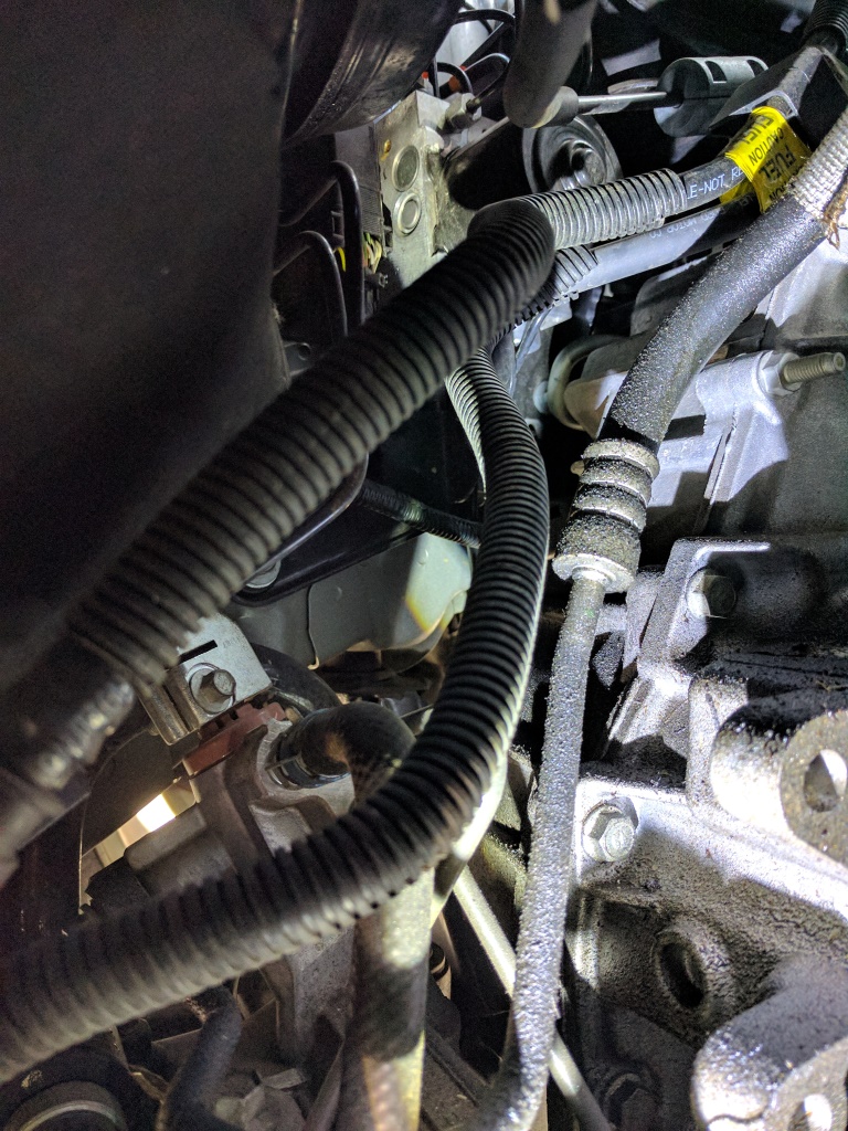

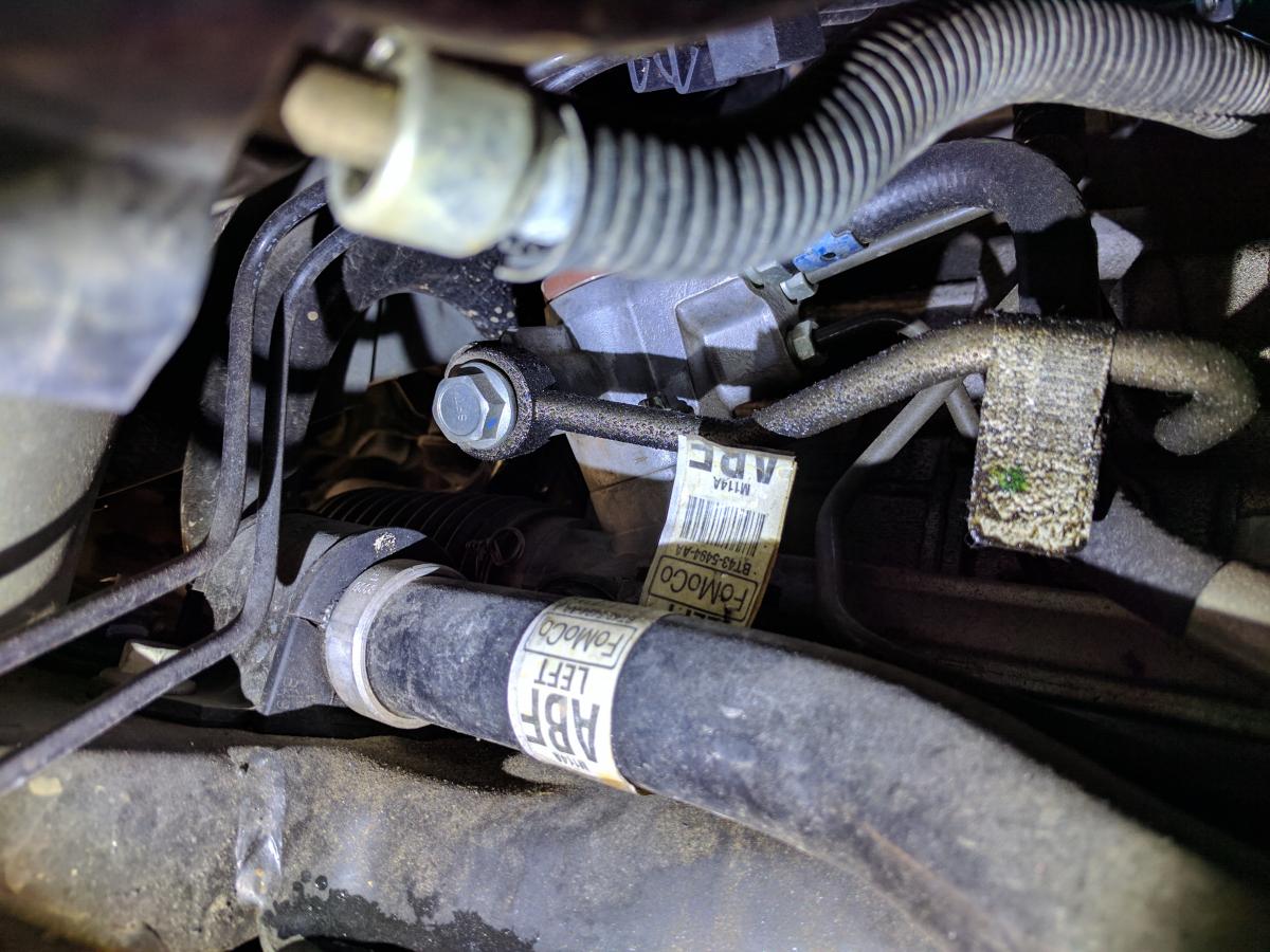

freebird Posted April 12, 2017 Report Share Posted April 12, 2017 Sounds like we have a similar problem. Mine seems to be failing where the hardline transitions to a flexible line, but the leak seems to move forward from that area onto the transmission as well. You probably need to clean it up and then see if you can pin point the leak. Have you been having to add an p/s fluid? Quote Link to comment Share on other sites More sharing options...
