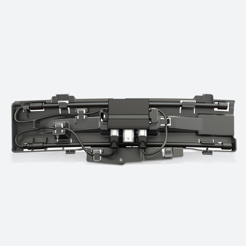

rickharris000 Posted April 11, 2017 Author Report Share Posted April 11, 2017 (edited) I think this is the sensor in the 2016 ford edge. https://www.brose.com/de-en/Products/Technology-for-vehicle-doors-and-liftgates/ Edited April 11, 2017 by rickharris000 1 Quote Link to comment Share on other sites More sharing options...

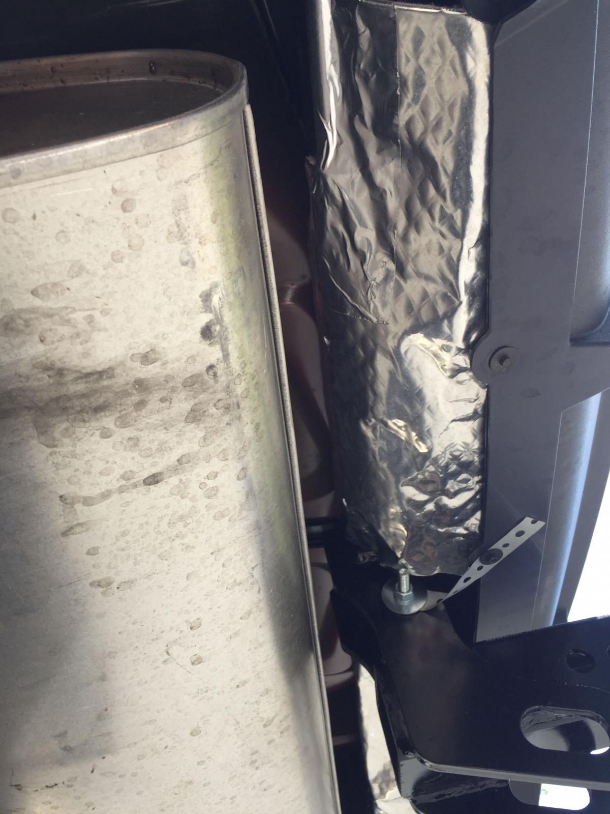

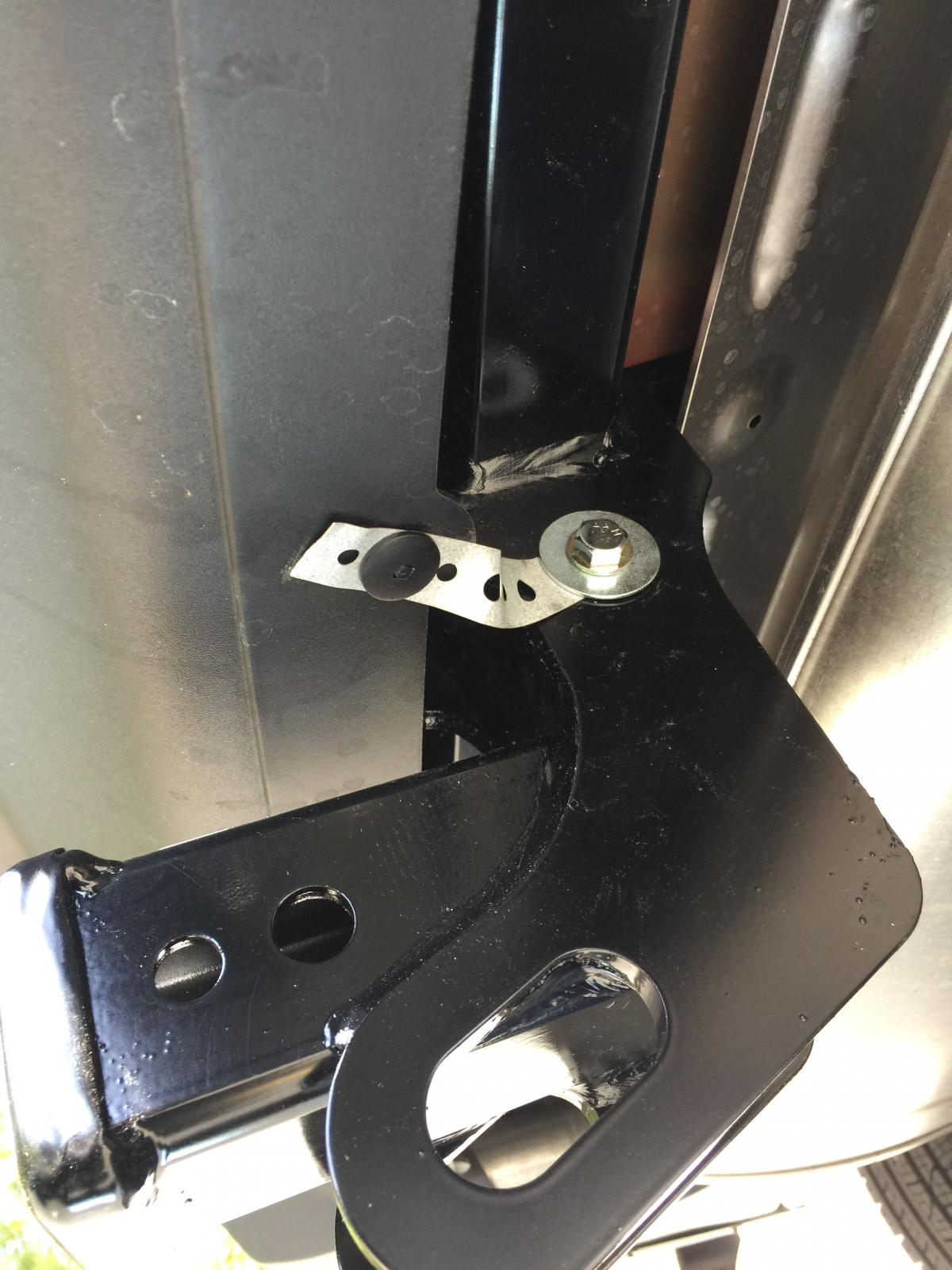

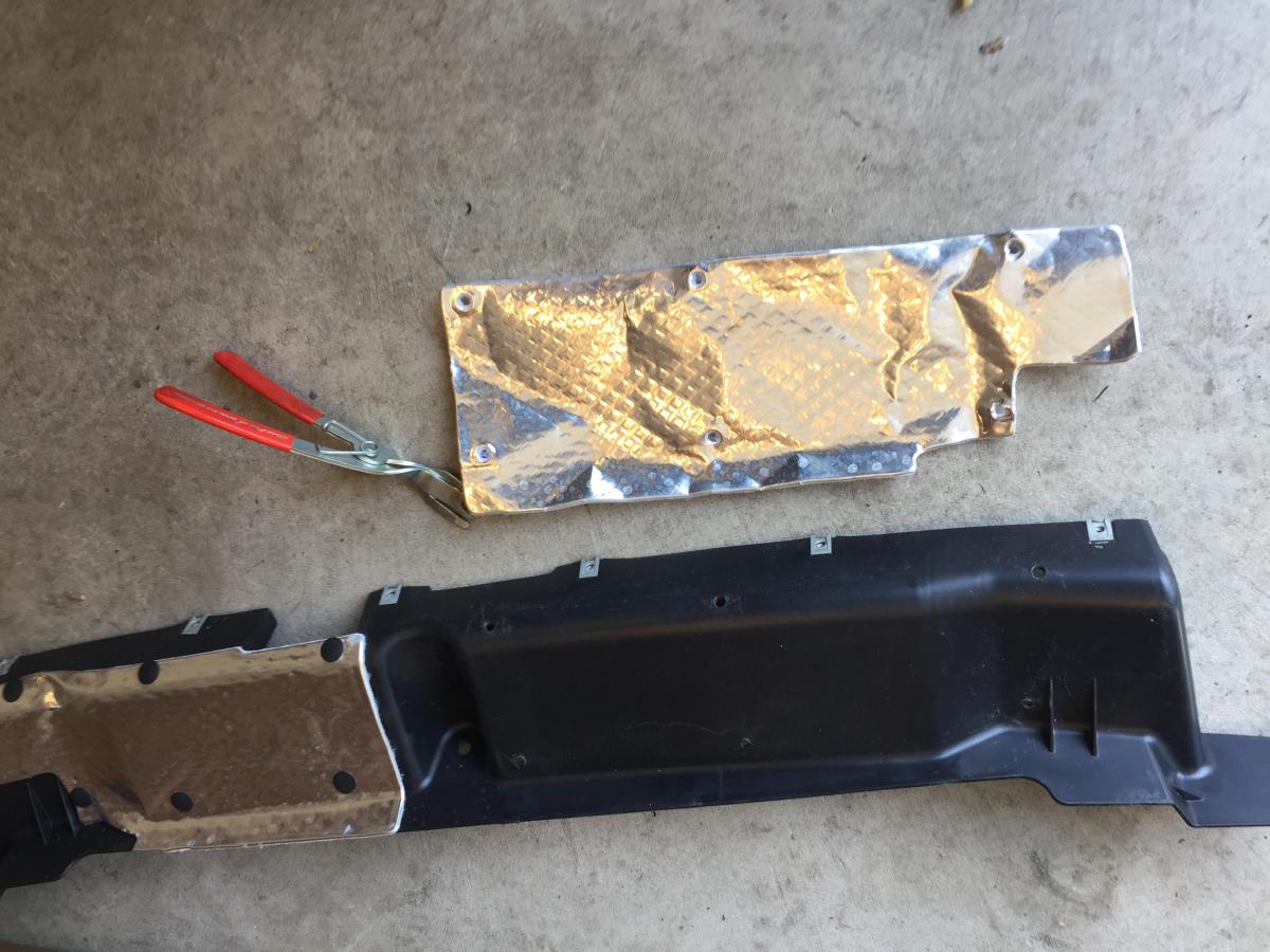

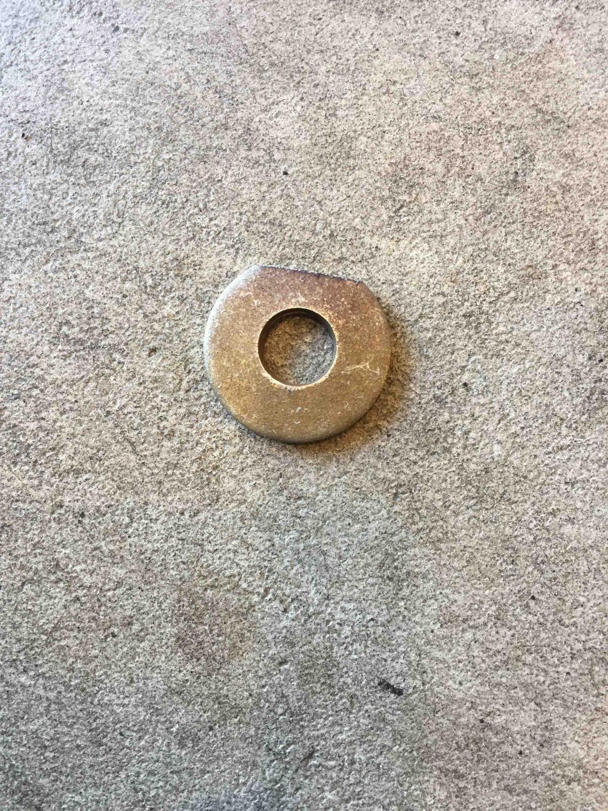

NoDTMF Posted April 20, 2017 Report Share Posted April 20, 2017 Oh hi, I bought this: https://www.etrailer.com/Trailer-Hitch/Ford/Edge/2017/75234.html?vehicleid=201742261 for my 2017 Edge Sport. Install went fine, However: There is a heat shield on the rear bumper that is removed and not re-installed. I actually removed the heat shield material from the shell and "custom" installed it. That interfered with the foot sensors. So I cut little pieces of the heat shield material off that were near the sensors. That works . Also the original heat shield seemed to stabilize the rear lower bumper panel. What I mean is, the lower panel seems like it would vibrate in the wind with the heat shield removed. I added some "straps" to stabilize the lower bumper panel. Also adding the stiff heat shield material also helped stiffen the lower panel. Also the washers for the inner mounting holes had to be ground down on one edge to nicely fit. Attached are some pictures. Note with the heat shield installed it doesn't have the cut-out yet, I discovered the problem after I took the pictures. 2 Quote Link to comment Share on other sites More sharing options...
