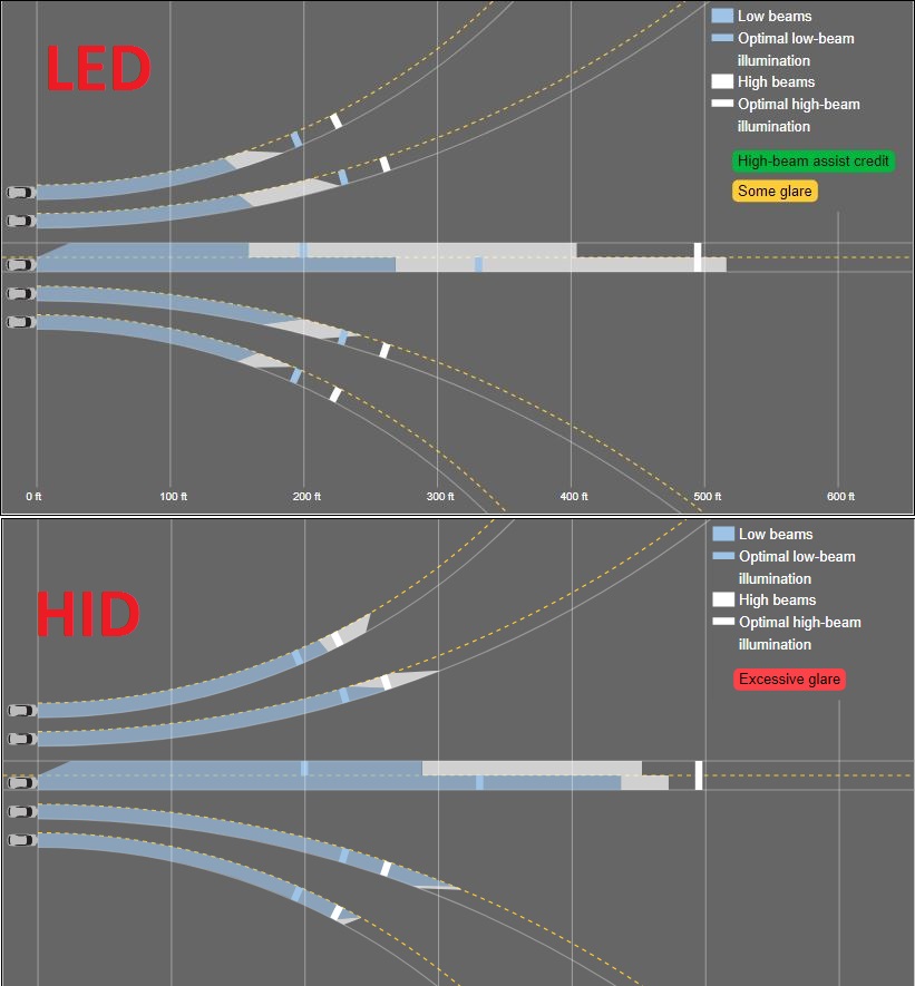

omar302 Posted October 26, 2017 Report Share Posted October 26, 2017 (edited) This is from IIHS ratings for the 2017 Lincoln MKX: Factory LED: Factory HID: This case is similar for many other cars, factory HID illuminates more than factory LED. Edit: Direct comparison: Edited October 26, 2017 by omar302 1 Quote Link to comment Share on other sites More sharing options...
candurin Posted October 26, 2017 Report Share Posted October 26, 2017 LEDs lack hotspot, hotspot equals distance. LEDs do not throw light as far as halogen or HID. Nobody retrofits LEDs into halogen anything. When you put LEDs into Halogens you get nothing but Foreground lighting Sorry, Nick. Wording was poor on my part. I wasn't trying to insinuate that it should be done. I guess I read incorrectly, I thought the issue was the other way around. I have some LED flashlights (quite a few actually, it's becoming an issue) that can throw really damn far. So, clearly it's a poor projector design. I have some that I use for flood effect and others I use for throw. Quote Link to comment Share on other sites More sharing options...
