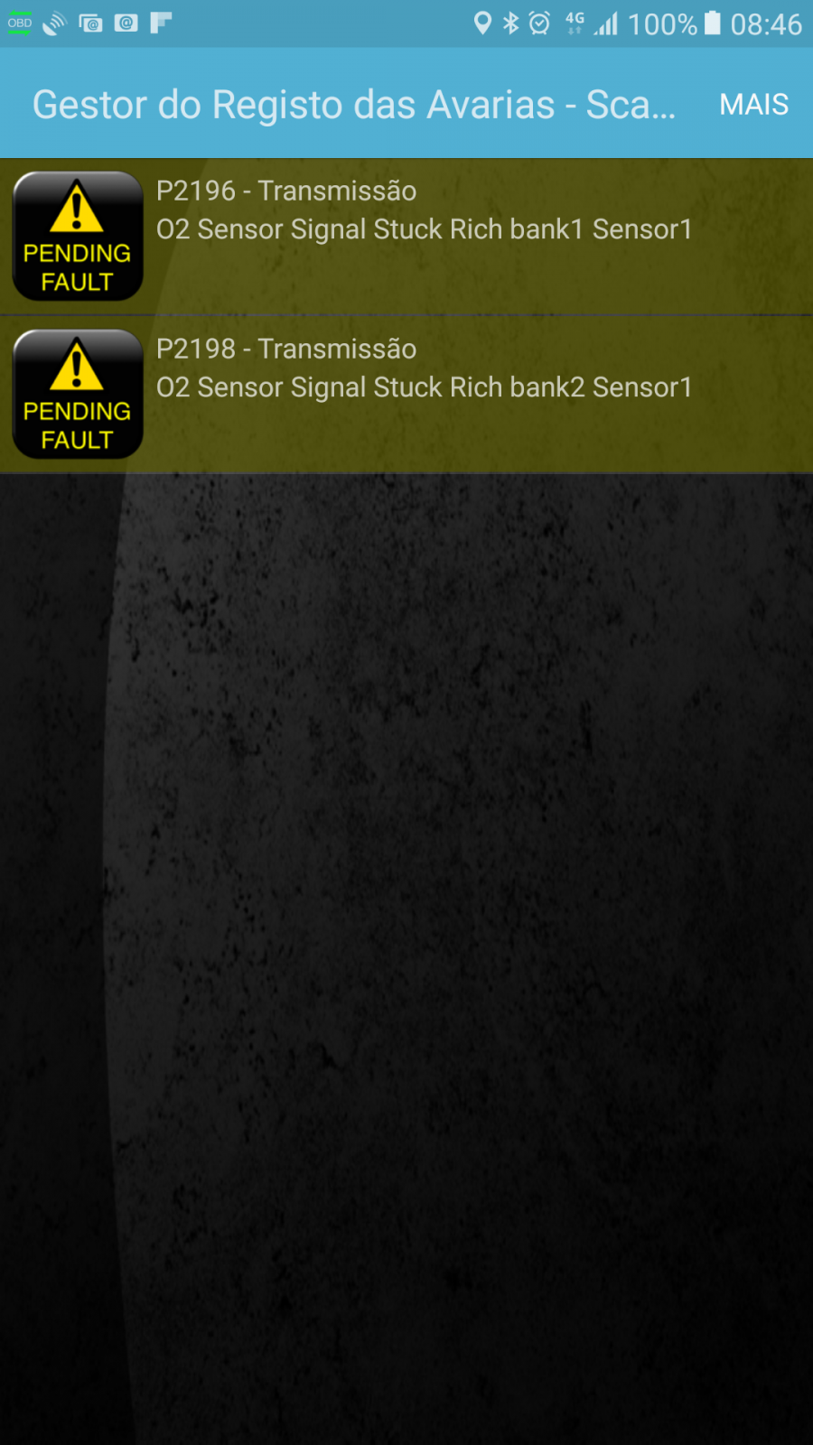

Kleber Gomes Posted March 3, 2017 Report Share Posted March 3, 2017 Hello guys, This morning I noticed that my Ford Edge 2013 was not running smooth as before. There wasn't any other problem like losing power, etc, the only issue was that (mainly when stopped) it was possible to feel that the engine rotation was presenting some significant variations, and in some cases it seems that the engine would almost shut down, but never got to this point. While in movement, the car was performing quite ok and such variations were almost not possible to be noticed. As I have the OBD connector and the Torque App, I decided to check for any error codes and unfortunately 02 of them have poped up (previously, this scan all always clean). These 02 error codes are P2196 and P2198, both connected with O2 Sensor Signal. (attaching a print screen). I have been using the same gas station so initially I'm assuming there hasn't been any issue with fuel quality. Would appreciate if you could help me to understand what may be this problem, if there any common problem related to that and the options to fix. Thanks/Kleber Quote Link to comment Share on other sites More sharing options...
omar302 Posted March 3, 2017 Report Share Posted March 3, 2017 It probably is the canister purge valve, a cheap part to replace. Here is a thread I found for the Ford Explorer with the same engine having the same issue. Go down to a post by ssilence. http://www.explorerforum.com/forums/index.php?threads/p2196-and-p2198-what-to-check.417753/ 1 Quote Link to comment Share on other sites More sharing options...
Kleber Gomes Posted March 3, 2017 Author Report Share Posted March 3, 2017 It probably is the canister purge valve, a cheap part to replace. Here is a thread I found for the Ford Explorer with the same engine having the same issue. Go down to a post by ssilence. http://www.explorerforum.com/forums/index.php?threads/p2196-and-p2198-what-to-check.417753/ Thanks Omar. In Ssilence's post he said that there was a recall for the Edge related to this problem: "In addition, I found a recall for earlier makes of the Ford Edge that had this same part failing." I'm not from US and based in all my research about the Edge I never found anything about it. Do you have any reference on this recall, and where can I find more info? BR/Kleber Quote Link to comment Share on other sites More sharing options...

Kleber Gomes Posted March 6, 2017 Author Report Share Posted March 6, 2017 So, I decided to take the car to a dealer, to confirm if the failure is really in this part. (this will be my first experience with dealers that are not with regular maintenance). Left it over there this morning, they will investigate. They said that they will return with the findings and budget to fix. (but if I decide not to fix with them, then I would have to pay 1h of their technician for the findings (1h of a dealer technician here = 105 USD). Considering the cost of the part if I import by myself, the price from the dealer is not too far away, so I decided to take the risk. Let's see what will be their feedback. BR/Kleber 1 Quote Link to comment Share on other sites More sharing options...
Kleber Gomes Posted March 7, 2017 Author Report Share Posted March 7, 2017 The dealer called me in the end of the afternoon, and said: - The TSB 14:0213 doesn't apply to my vehicle; - They detected readings of a "rich" mixture and "reprogrammed" PCM; - They said it is not necessary to replace the canister purge valve; - The light in the panel is gone; - Nothing else is needed and the problem is fixed; Bill: 1h from their technician (105 usd) Any idea of what is reprogramming the PCM? BR, Kleber Quote Link to comment Share on other sites More sharing options...

Kleber Gomes Posted March 7, 2017 Author Report Share Posted March 7, 2017 This may be overkill but does a good job of covering the subject. http://www.autotap.com/techlibrary/about_flash_reprogramming_pcms.asp Just got the car. Dealer has upgraded PCM Sw release.from DT4A-12A650-ATD to DT4A-12A650-ATE. The contact person also said that PCM was "reprogrammed" but honestly I don't think they had changed any parameter (beyond the sw update). They cleared the error codes (DTC). They also blamed the quality of the fuel which in my view is a very unlikely situation, as I've been using the same gas station for more than 6 years, in many different cars without any problem. As they belong to a huge supermarket here (like wallmart) I believe they would not risk their brand reputation on bad quality fuels. Have used the vehicle this morning and things seems to be returned to normal. No fault codes neither IML and nothing else noticed (neither the "strange" engine rotation variation while stopped). I'm not fully convinced that the root cause was solved but will count that the PCM sw update should have solved. Thanks/Kleber Have just used the vehicle today, Quote Link to comment Share on other sites More sharing options...

Kleber Gomes Posted March 9, 2017 Author Report Share Posted March 9, 2017 For me it makes a lot of sense and the purge canister valve really has to be the problem. I collected some further readings from the OBD and notice that in bank 1, the O2 measurement is always in 0.8V. The system try to reduce the fuel injection (SRFT) but there's absolutely no change in the O2 measurement (differently from Bank 2). This means that the mixture is always "rich" with low O2 levels measured. I believe this triggered the P2196/P2198 DTCs, as a condition for that is having no switch in O2 monitoring even after strong reductions in fuel injection, for at least 30 seconds. So, in case we have a purge valve malfunctioning and "opened" (when it should be closed) gas vapour (hydrocarbonate) ends up constantly getting into the engine, leaving less space for O2 ... and resulting in rich (my hypothesis) However, I remeber to see comments of another issue with Edge, related to throttle body. Based in your experience, do you see any chance that the throttle body issue could the the reason of the problems? I mean, if it is related to the O2 inflow and I'm constantly reading low O2 outputs, I was wondering if that couldn't be the problem as well ... so, your opinion and eventually tips on how could I detect such issue in my car would be appreciate. PS: So far, no DTCs are present anymore. BR/Kleber Quote Link to comment Share on other sites More sharing options...
