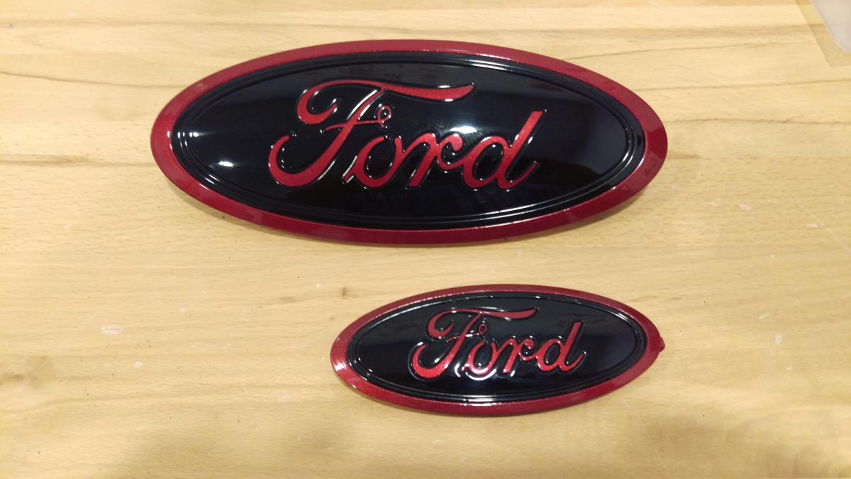

2016 Edge Sport - Just got these delivered today. Had them custom painted to match the Ruby Red on Black theme of my car. I hear the front emblem is a real S.O.B. to remove. Is there anyone who can give me instructions on how to get the front emblem off before I spend $70 on a service manual? Apparently this requires disassembling the bumper cover and grille. I want to do this right the first time. Any advice on putting these on will be greatly appreciated.

thanks again for the tips. you weren't kidding about those 3 fender screws on each side, the furthest one in took forever, there's just no room to turn the ratchet. removing the headlights definitely made it easier. worked out great though. check out the pics if you like.

The good news is that the emblems do look great - they came out awesome. I'll see when I can make an appointment with the shop. Fingers crossed. Thank for all the help!
