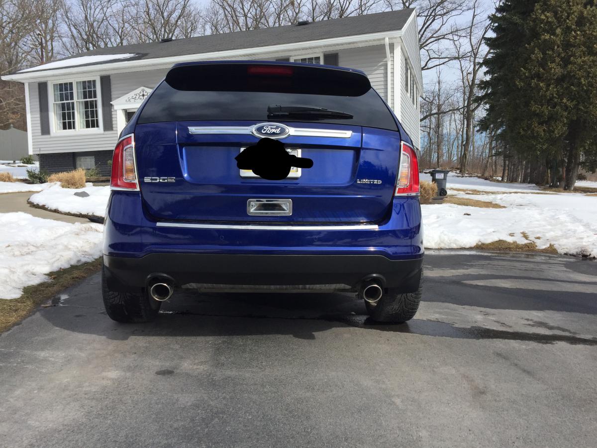

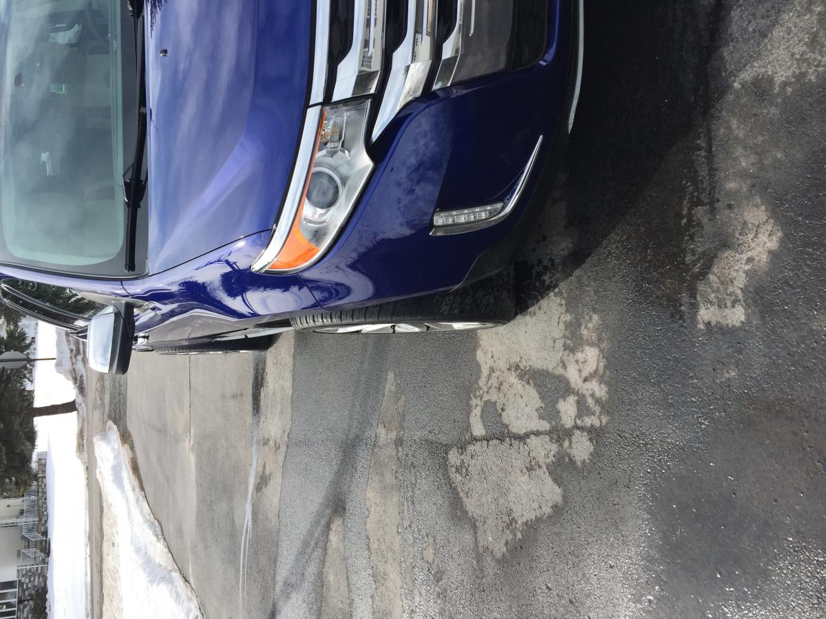

Mgavin1985 Posted February 18, 2017 Author Report Share Posted February 18, 2017 The deed is done 30 mm spacers are on Quote Link to comment Share on other sites More sharing options...
Mgavin1985 Posted February 18, 2017 Author Report Share Posted February 18, 2017 Are the pictures coming through??? Quote Link to comment Share on other sites More sharing options...
Mgavin1985 Posted February 18, 2017 Author Report Share Posted February 18, 2017 . Quote Link to comment Share on other sites More sharing options...
Mgavin1985 Posted February 18, 2017 Author Report Share Posted February 18, 2017 . 1 Quote Link to comment Share on other sites More sharing options...
Mgavin1985 Posted February 18, 2017 Author Report Share Posted February 18, 2017 If anyone put the spacers on it's not to bad total time 1 hour that's all it took me to tinker but once the studs are cut if someone wanted to take spacers off and put stock wheel on with no spacers the studs are going to be to short and will require new studs ARP has good stud that are stronger and more durable that OEM but are also more expensive. 1 Quote Link to comment Share on other sites More sharing options...
