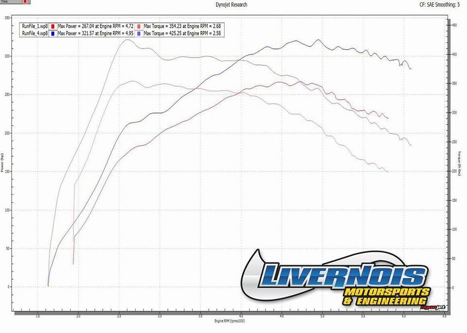

STB130 Posted March 7, 2017 Report Share Posted March 7, 2017 (edited) After studying the MKX tune it looks odd that TQ and HP do not cross at 5250 rpm! Edited March 8, 2017 by STB130 Quote Link to comment Share on other sites More sharing options...
Ray Heath Jr Posted March 8, 2017 Report Share Posted March 8, 2017 After studying the MKX tune it looks odd that TQ and HP do not cross at 5250 rpm!IMG_0430.JPG That 5250 crossing, is tuned TQ, and Stock HP. Both the Tuned Pair, and Stock Pair intersect around 4K. Quote Link to comment Share on other sites More sharing options...
Ray Heath Jr Posted March 9, 2017 Report Share Posted March 9, 2017 All dyno runs should have intersecting torque and HP lines at 5252 RPM. https://www.google.com/search?q=dyno+5250+cross+explination&ie=utf-8&oe=utf-8#q=dyno+5250+cross+explanation&* HP is calculated off of the torque the dyno measures. All it measures is torque. HP = (TQ*RPM) / 5252 If you see intersection at a different RPM point it is because they are scaling the HP and the TQ differently on the chart. It is the only way. I am merely reading the Dyno chart posted as is. We can talk theory, and expected all we want. The chart shows BOTH the tuned and Stock curves intersecting at 4K. The 2 lines that intersect at 5200 is tuned TQ, and Stock HP. Not doing Math, just reading the Dyno Graph that was posted. Quote Link to comment Share on other sites More sharing options...
WWWPerfA_ZN0W Posted March 9, 2017 Report Share Posted March 9, 2017 Yeah, it is the scaling on the graph that's throwing us off. An approximation ... 1 Quote Link to comment Share on other sites More sharing options...
