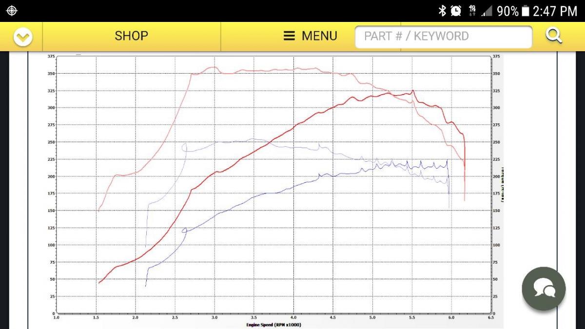

STB130 Posted February 7, 2017 Report Share Posted February 7, 2017 I too realized that the sport shift points were too high, after looking ar Dyno charts it seems to need to be lowered to around 5500. 1 Quote Link to comment Share on other sites More sharing options...

GT500R Posted February 21, 2017 Report Share Posted February 21, 2017 I too realized that the sport shift points were too high, after looking ar Dyno charts it seems to need to be lowered to around 5500. I had a similar thought and has the shifts lowered to 5900 but it seems to have slowed the car down... so i kept it at stock shift points. 2 Quote Link to comment Share on other sites More sharing options...

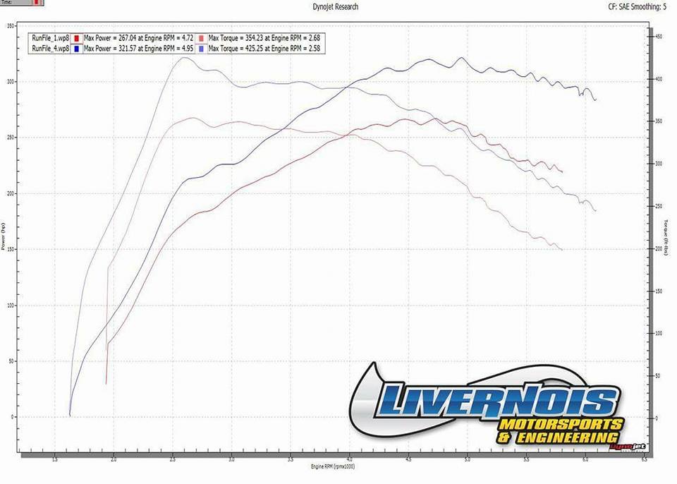

gjb89 Posted February 22, 2017 Report Share Posted February 22, 2017 On their facebook page they posted a dyno of a 2.7 Ecoboost MKX with 321 hp and 425 tq, someone commented and asked why there was a difference between the MKX and Edge and they stated that they have since learned new "tricks" to get the most out of the platform and that they are working on a new revision for the edge soon. 2 Quote Link to comment Share on other sites More sharing options...
STB130 Posted February 23, 2017 Report Share Posted February 23, 2017 I had a similar thought and has the shifts lowered to 5900 but it seems to have slowed the car down... so i kept it at stock shift points.tĀ Still seems too high if this dyno chart is correct? Also do you think the Lincoln tune is going to be a problem with trans? 426 # vs 350# on edge Quote Link to comment Share on other sites More sharing options...
WWWPerfA_ZN0W Posted February 23, 2017 Report Share Posted February 23, 2017 The 2.7EB gets the 6F55 transmission, which has been daily-drivered at 600 HP/TQ at the crank in other applications (about 500 AWHP/AWTQ at the wheels). Should be fine, but the higher you push the curve, the more you should expect to shorten maintenance intervals. "Lifetime" is definitely out the window. Quote Link to comment Share on other sites More sharing options...
