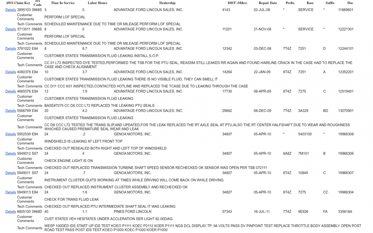

Kyledelp Posted January 30, 2017 Report Share Posted January 30, 2017 I had a pre purchase done on an '07 SEL AWD with 154,000 miles on it today and they returned quite a laundry list of items. The seller has agreed to take care of the tie rods, brakes, tires, and oil leak issue. If these issues are addressed, would it be a good purchase at $6,000? Any input would help. I've attached a picture of the Ford dealers squawk list. Thanks! Quote Link to comment Share on other sites More sharing options...

WWWPerfA_ZN0W Posted February 1, 2017 Report Share Posted February 1, 2017 What, no wheel bearing failure??? They were at it for the PTU/seals so many times, and the TSS/OSS sensors too. There is a service history gap of nearly 5.5 years as well. IDK, I would have my doubts on this one 4 sure. You may have to replace the said same parts again, and in addition, face the other possible failure points that this mileage may bring. If you are a DIY kind of guy, it might be liveable, but if you are paying for service, then I'd say NO. 1 Quote Link to comment Share on other sites More sharing options...
