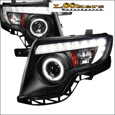

Joel2010 Posted January 12, 2017 Report Share Posted January 12, 2017 So I bought aftermarket headlamp assemblies for my 2010 ford edge, they look great, only problem is they are not bright enough for where I live. I have the assemblies from carid.com, originalfactory assemblies call for two bulbs, a hi and a low (H11 and 9005) these aftermarket ones go to a single H11 bulb and when you activate high beams a apperture opens to widen the beam.... Problem is its still a low beam. Im wondering if anybody has used LEDs or HIDs with this aftermarket assemblies or if anybody knows how to get a 9005 bulb onto a H11 retainer ring to install in the housings? Quote Link to comment Share on other sites More sharing options...
