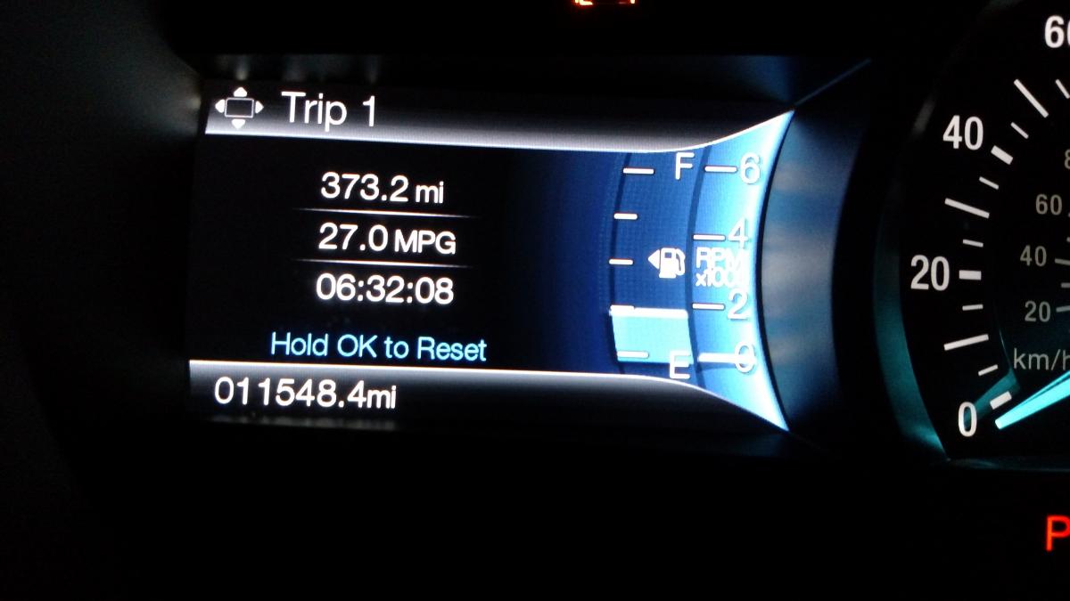

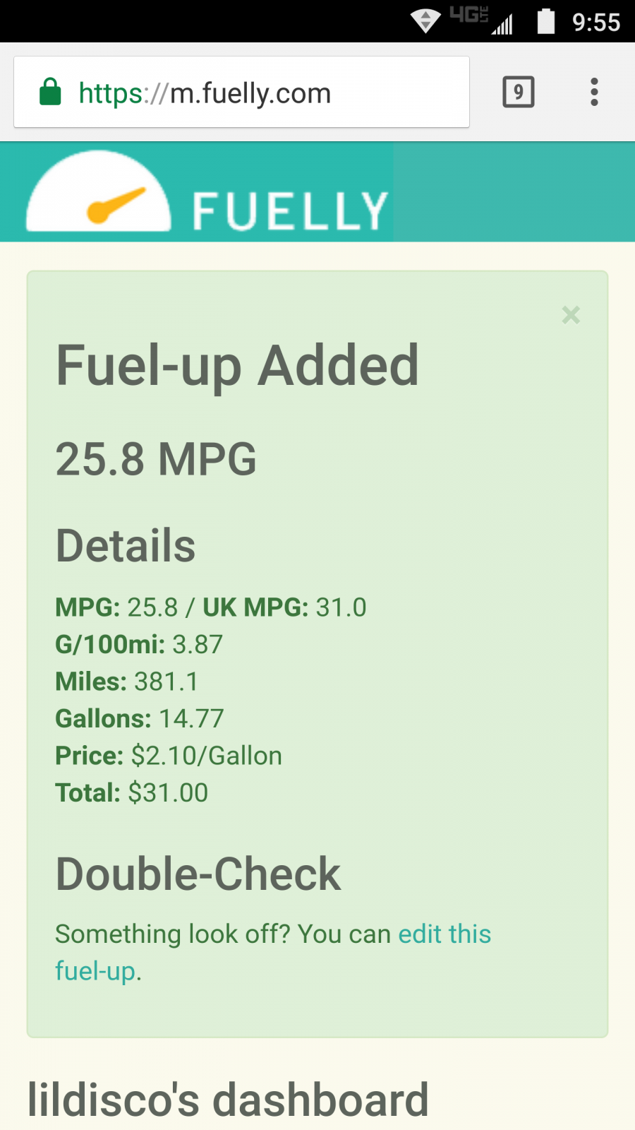

lildisco Posted January 16, 2017 Report Share Posted January 16, 2017 Took a recent trip down to Southern Ohio & back. Made it there & back on 1 tank 381 miles on winter mix fuel & around 75mph. Car said i averaged 27mpg, actual calculation was 25.8 on 14.77 gallons. Not too snabby. I gained a lot when speeds were below 65. The 2nd pic of the computer was before i drove from home to the gas station. 1 Quote Link to comment Share on other sites More sharing options...
